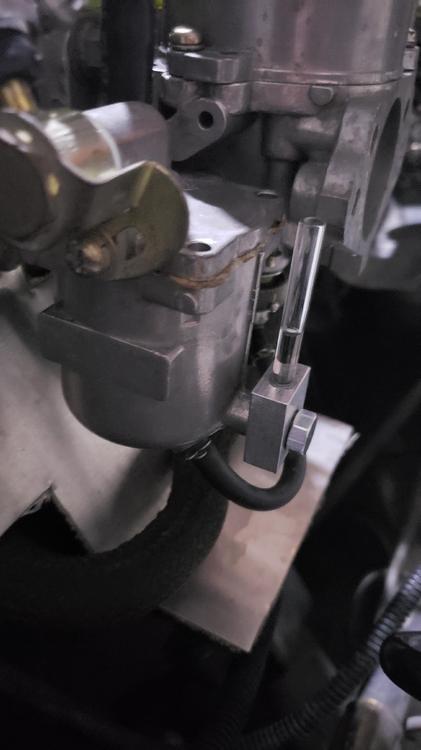

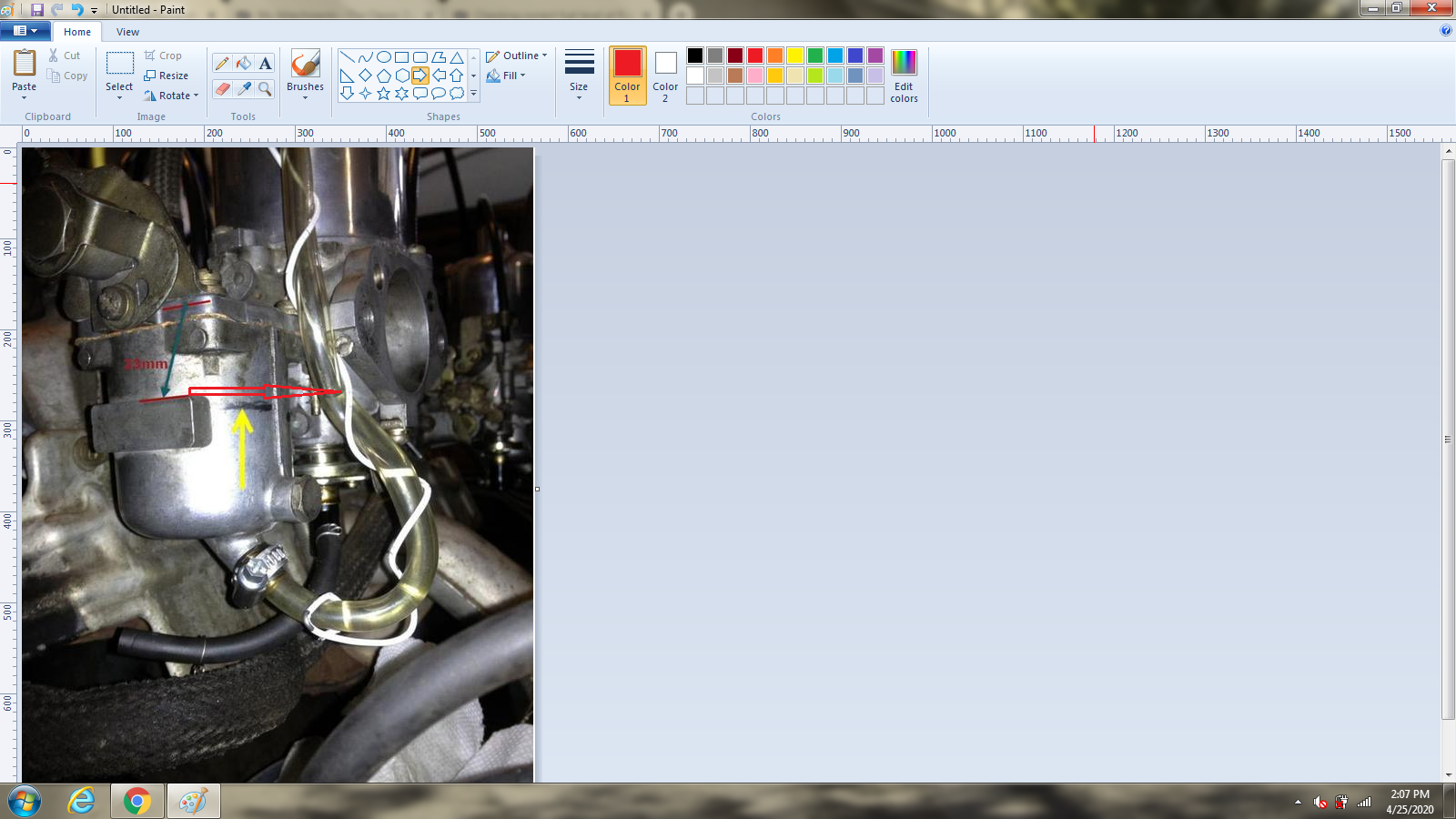

April 25, 20205 yr comment_598023 This is the cheapest and easiest way to get a close level of the float chambers. $2 worth of clear hose from Lowes. The red arrow in this pic. The fuel in the hose should be even with the top of that rectangular boss on the side of the carb.  Link to comment https://www.classiczcars.com/forums/topic/63901-delphi-mechanical-fuel-pump-stops-pumping-fuel/?&page=2#findComment-598023 Share on other sites More sharing options...

April 25, 20205 yr Author comment_598030 1 hour ago, siteunseen said: This is the cheapest and easiest way to get a close level of the float chambers. $2 worth of clear hose from Lowes. The red arrow in this pic. The fuel in the hose should be even with the top of that rectangular boss on the side of the carb.  I will try this as well. Though I don't think this is my issue. At least I will have my floats at the correct level. Thank you! Link to comment https://www.classiczcars.com/forums/topic/63901-delphi-mechanical-fuel-pump-stops-pumping-fuel/?&page=2#findComment-598030 Share on other sites More sharing options...

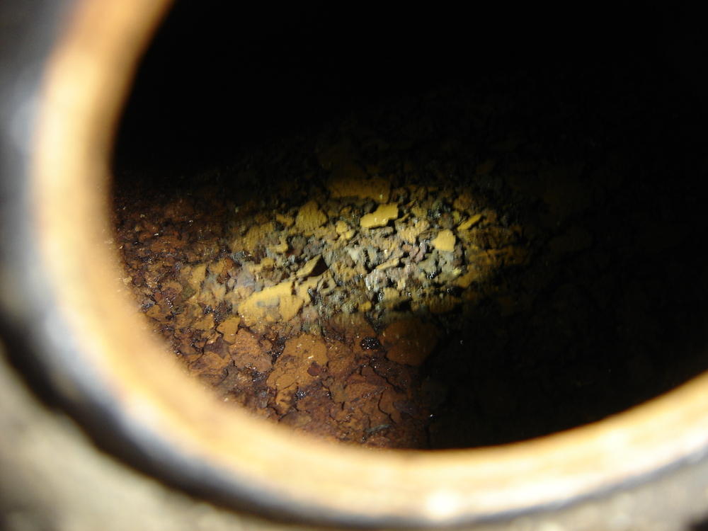

April 25, 20205 yr comment_598037 My cruddy tank would let me drive about a mile before clogging up the fram g2 I had right out of the tank. Took the front hose off at input of that filter. Blew like crazy with my mouth until it was gurgling in the tank then I could get back home, barely. Â Link to comment https://www.classiczcars.com/forums/topic/63901-delphi-mechanical-fuel-pump-stops-pumping-fuel/?&page=2#findComment-598037 Share on other sites More sharing options...
