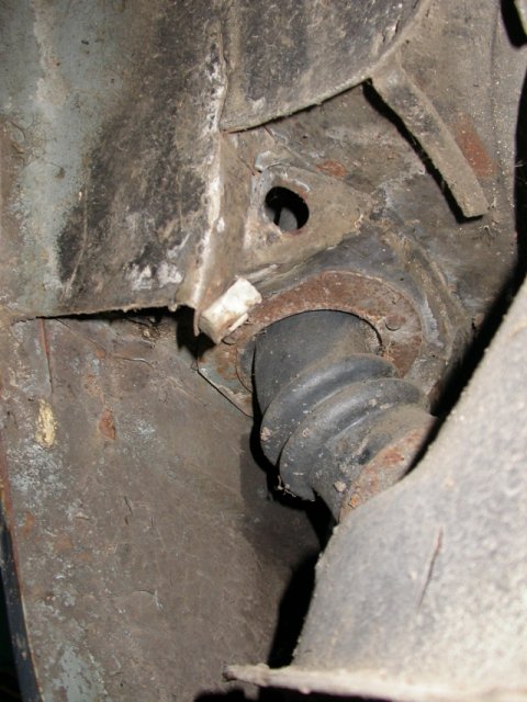

Also - you mention a plate covering the opening to get to the fuel tube to tank clamp - I didn't have one of those. One more thing that was added on later cars, or is this missing on mine? Is the cover plate plastic or metal? I'm assuming this is part 17270-E4100 on the fiche, listed as: PROTECTOR - FILLER HOSE RH. Where does it actually screw into? I know the PO had the rear quarter sheet metal replaced, so if it screws into brackets there, it could have been removed at that time.
The cover plate that I refer to actually forms the rear wall of the wheel-well (or at least the bottom 8 to 12 inches of it. It doesn't attach to any brackets, it is just secured to the rest of the wheel-well by sheet metal screws. About 3 or 4 of them. Very Low tech.
I've never worked on a low VIN Z car so I don't know if it was added or was always there, but if the wheel-well is heavily undercoated, it can be difficult to detect that there is a removable panel there.
I'll have to look around and see if I see any screw holes that look like they should be filled. :ermm: The fiche shows that the one that should be on my 280Z parts car looks very different than the ones listed for the 240Z, so that won't help...
Do you have a picture of the rear part of the right rear fender well on you car that you could post?
I'm thinking, that there has to be some panel to allow access to the bottom of the filler tube (at the tank), but it would be the first time that a design was changed after the first few cars came off the assembly line.
I've attached the best one that I have here. I think I've got a better on on the digicam that I havent' downloaded yet. The gas tank is in the lower right. Along the lower left, you can just see the edge of the fender lip. The main part of the inner fender well goes off picture to the upper left.
