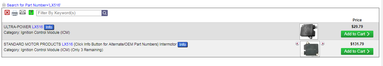

That looks like the right part but I think it's a scam like "New" alternators.  It should be flagged as deceitful on eBay.  Look at the words and compare it the real part on Rock Auto.
https://www.rockauto.com/en/partsearch/?partnum=LX516
Are you saying this isn't the correct part? Or are you saying this isn't a "new" part? From all Google searches LX-516 shows as correct for a '81 ZX.
I doubt it's doing damage to the tach since it's been like this for over 3,000 miles and since the initial tach run up to pegged has never happened again. If the module was going bad would there be any other symptoms besides the tach not reading correctly from 3000 RPM and up?

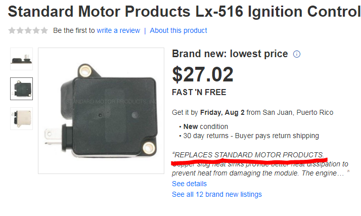

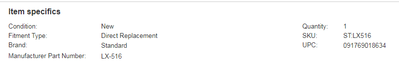

It's a "knockoff", not actually made by Standard Motor Products.  The eBay ad is a lie.  The one on Rockauto shows a true manufacturer, Ultrapower.  The eBay ad says SMP, but is false.
image.pngNotice how they avoid defining "manufacturer" and instead use part number or brand.  It's a con and eBay is enabling it.
