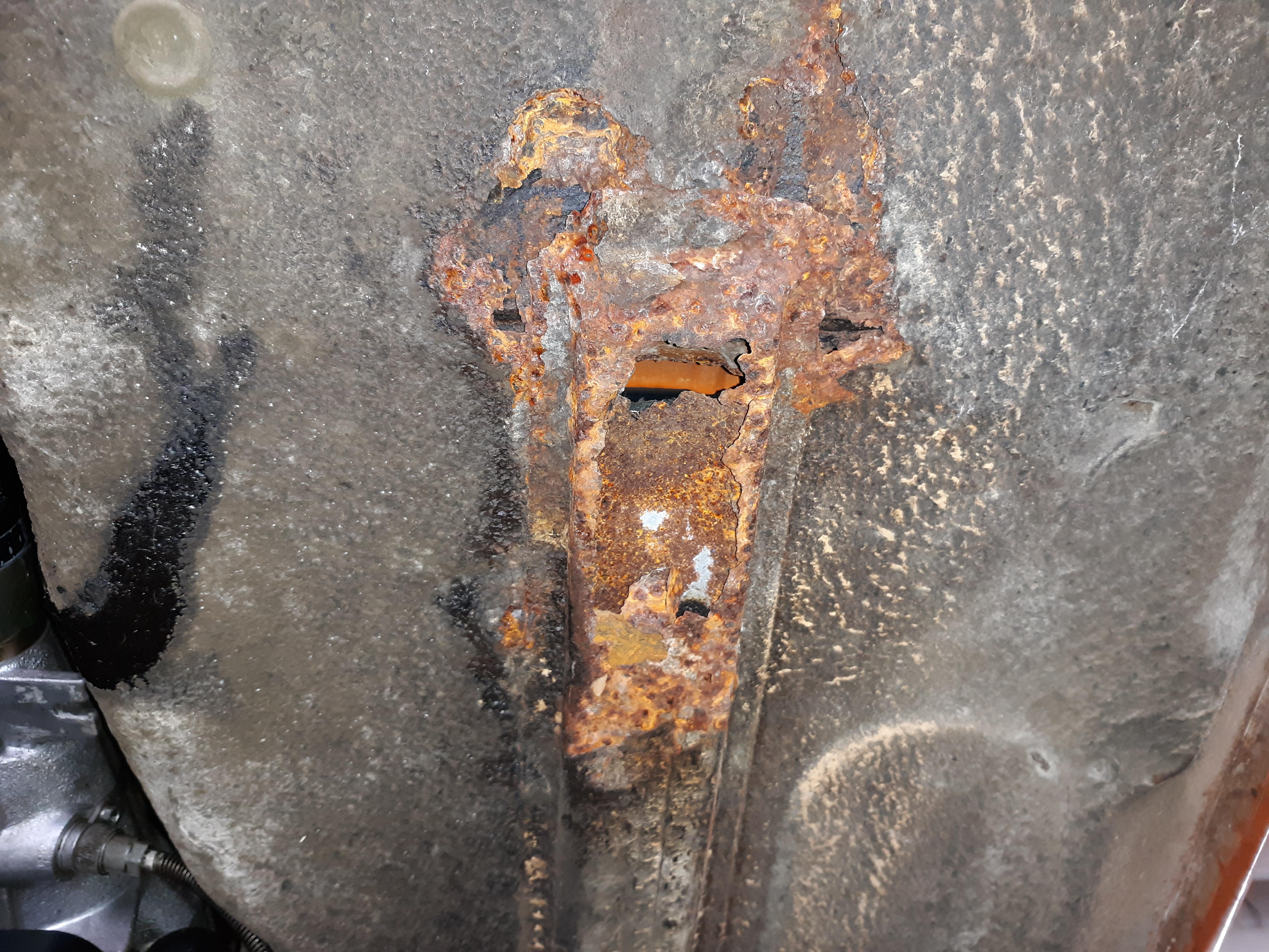

I knew this was there just didn't know how severe it was until today. Had my exhaust tweaked a little better and while up on his lift I took some photos. Passenger's seat has one all the way through. It had leaked out the heater cores water c o c k for years apparently and caused this.
Will new floor pans take care of this? Thanks in advance. Cliff

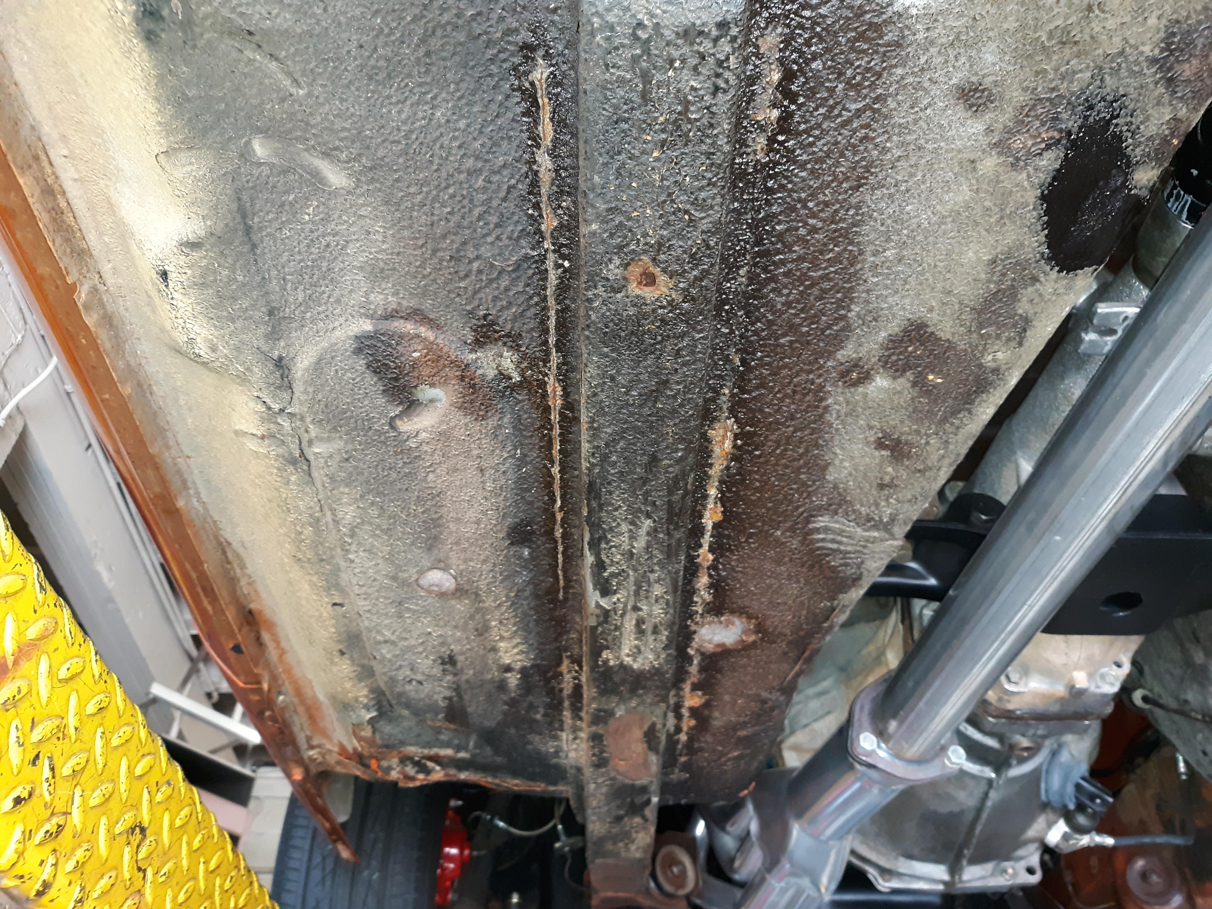

Driver's side, not as bad...
Rest of it...

Cliff,
If it were mine, I would only replace the places in the floor with patches that need it and replace the rusty frame rails. Now if you get it cleaned up and you find a lot more holes I might change my mind but on the car I am doing know that is what I did. I might have a partial floor pan from Charlie that would have the section you need. You would also need to get some frame rails. I'll be in "T-town" on Thurs evening until sometime late Friday Afternoon. If you wanted to try to meet up. I know you're pretty far North of I-20
Yep, frame rails are nice and beat up. First I'm going to fill that hole in with something yet to be determined (I'll have to do my homework).
