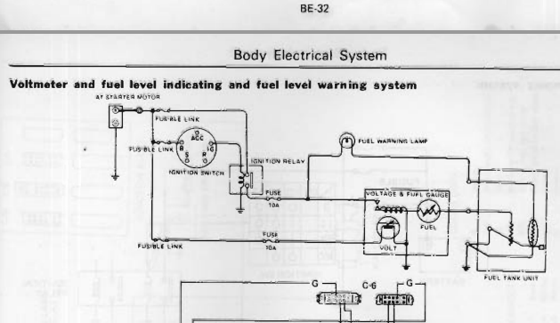

The voltmeter should always work even with the key off.  Sounds like you've lost connection through your main fusible link.  there's a fuse also but I can't tell which one it is.  There's better diagram below this one.
I checked the voltage on all of the fusible links today, all have 12v going out.
