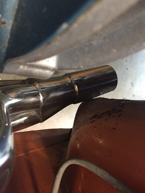

Today I was trading PMs with another member who was having figment issues with the Race Header hitting the transmission cross member. I have had the same issue using the full stainless system. Also the number 6 tube is located so close to the lower fuel line on my SUs that Sean sent me a Race Version which moves the number 6 tube forward. Sounded great but when I tried to install it it made contact with the tension bar mount. There is an in other member that I believe had the same issue.
Are others having fitment issues?

First photo is the Race header which contacts the tension bar mount.
The next two are the Race-Sport that was to close to the SU and the trans cross member.
