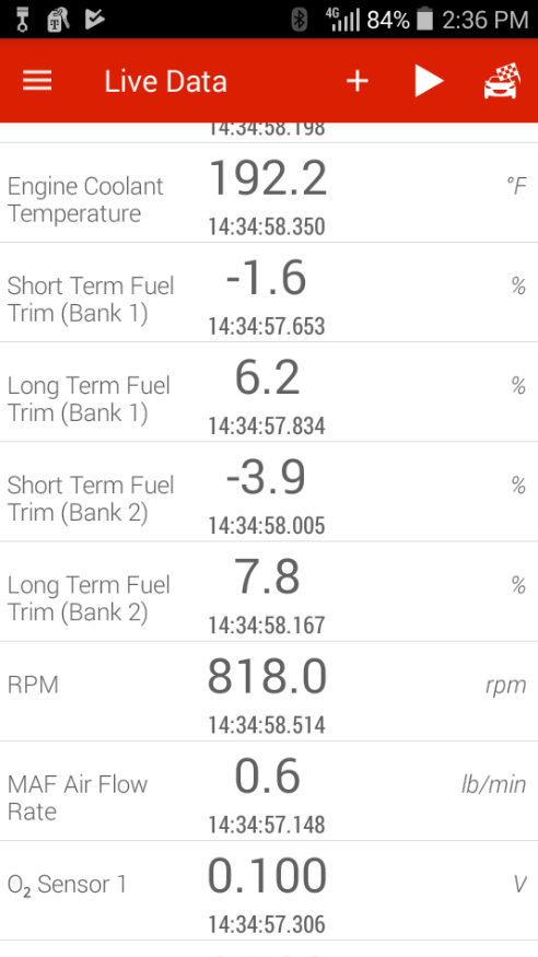

December 2, 20186 yr comment_562875 Consider buying an OBD reader. It will tell you the codes that the computer is generating, which can come from feedback or just damaged components. Some OBD readers can also scan live data. With an app on your phone or a computer program and a USB cable, tou can see the senosr values, and how the computer is respnding. IT's a great diagnostic tool and very educational. I have the BAFX reader, and the Piston Android app. Many other options though. Not sure what year your engine harness is but it's probably OBD-II. https://www.amazon.com/BAFX-Products-Bluetooth-Diagnostic-Scanner/dp/B005NLQAHS Link to comment https://www.classiczcars.com/forums/topic/61186-1jz-swapped-280z/?&page=2#findComment-562875 Share on other sites More sharing options...
