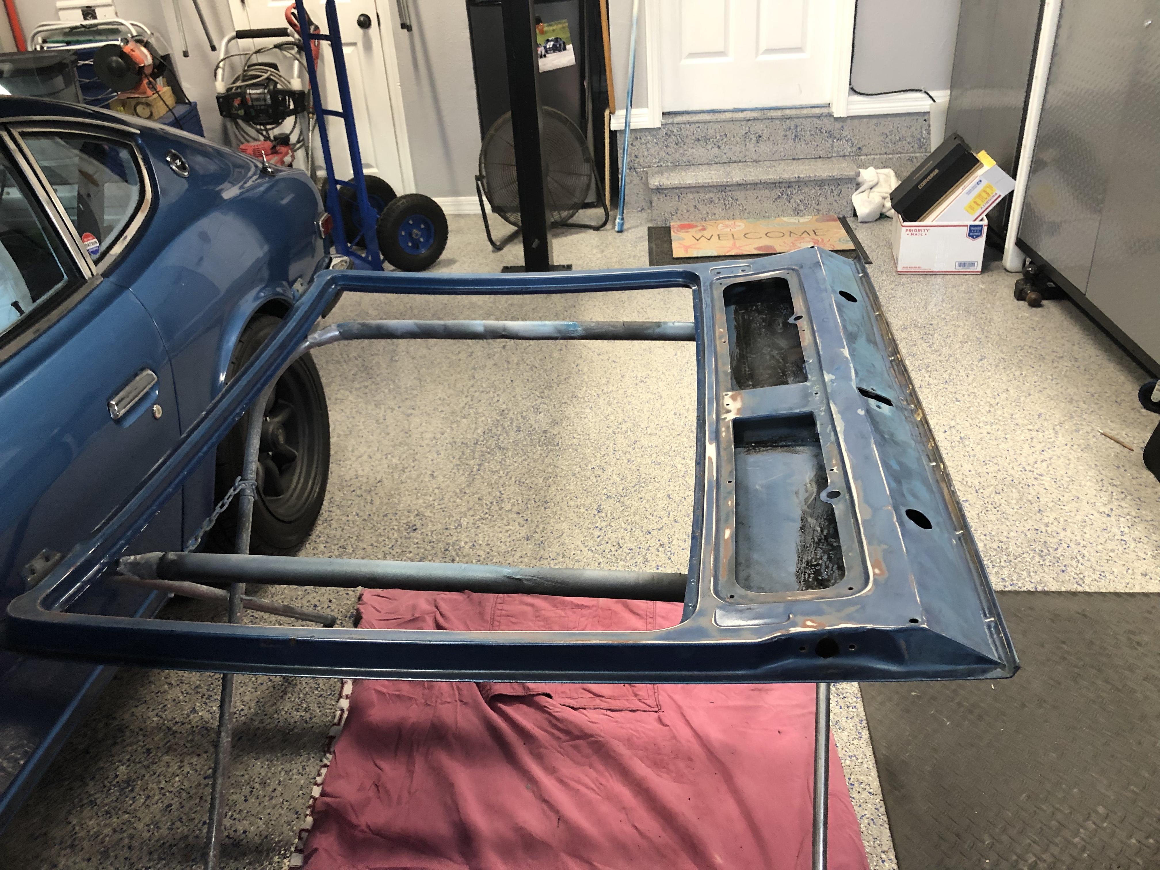

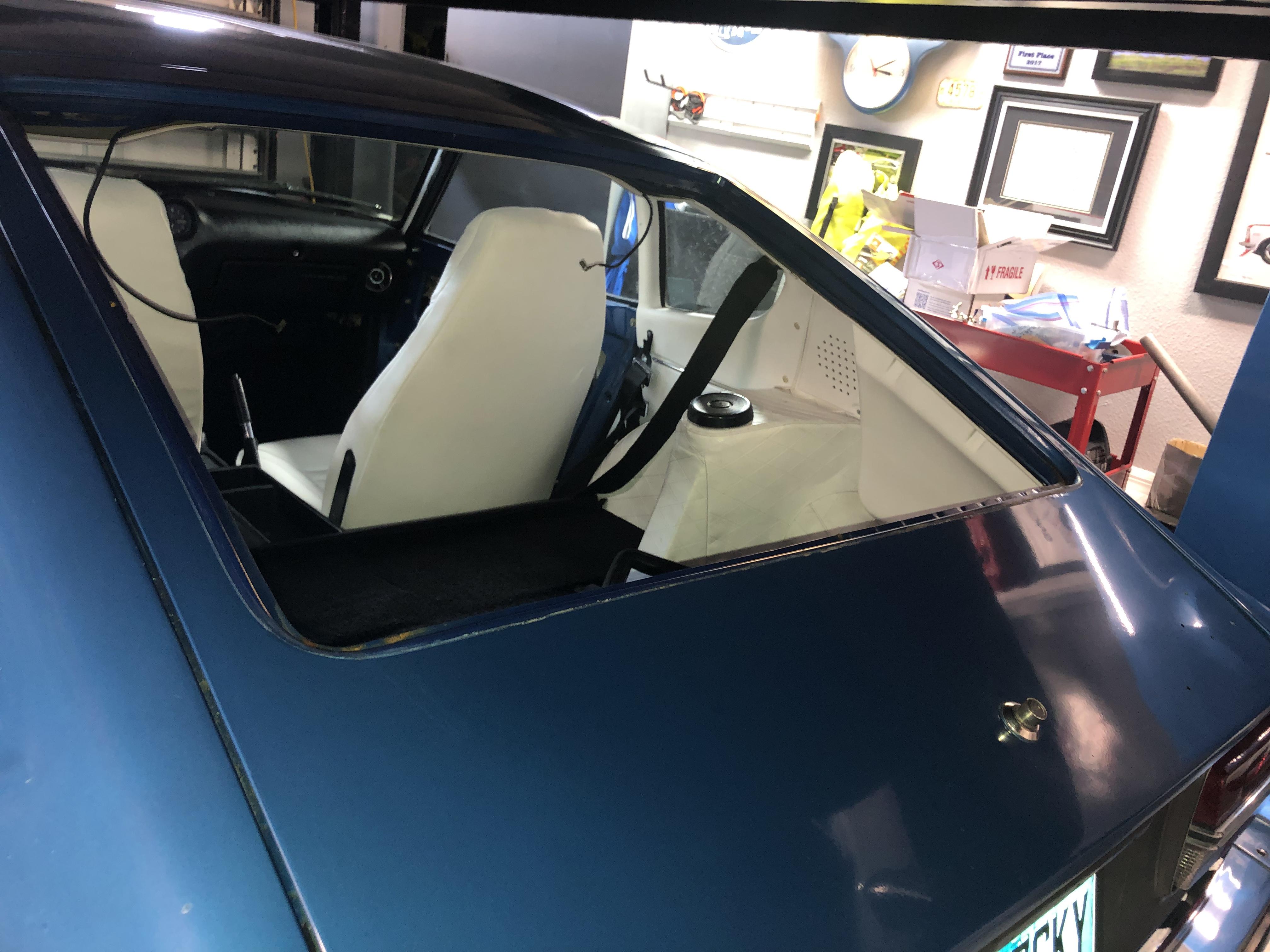

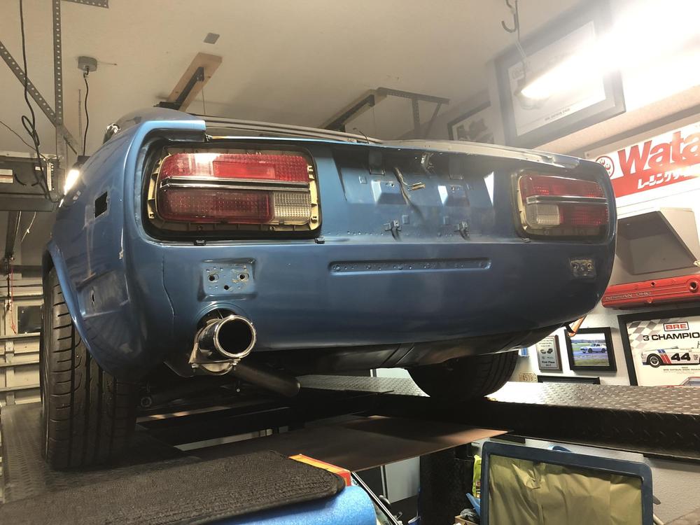

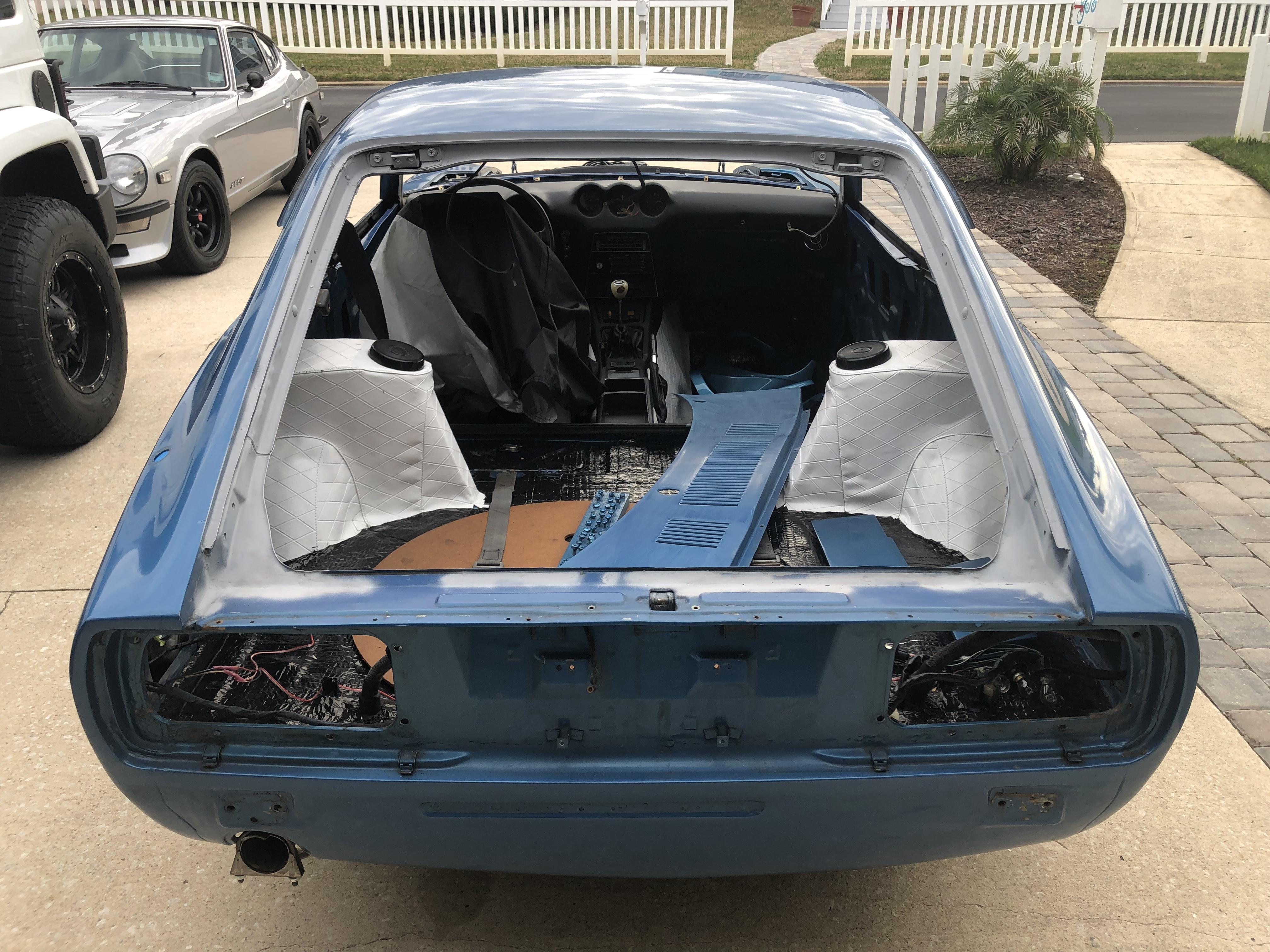

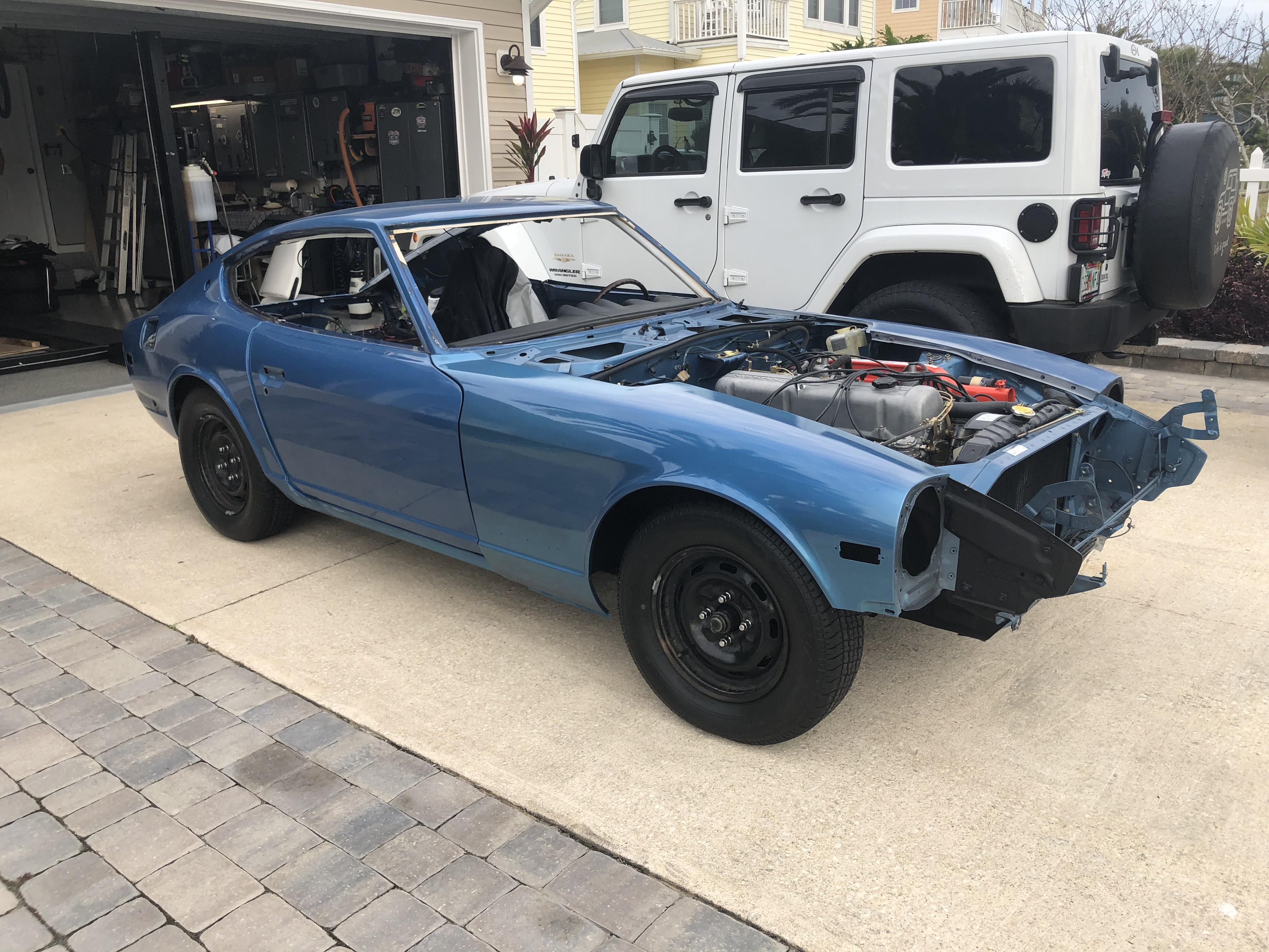

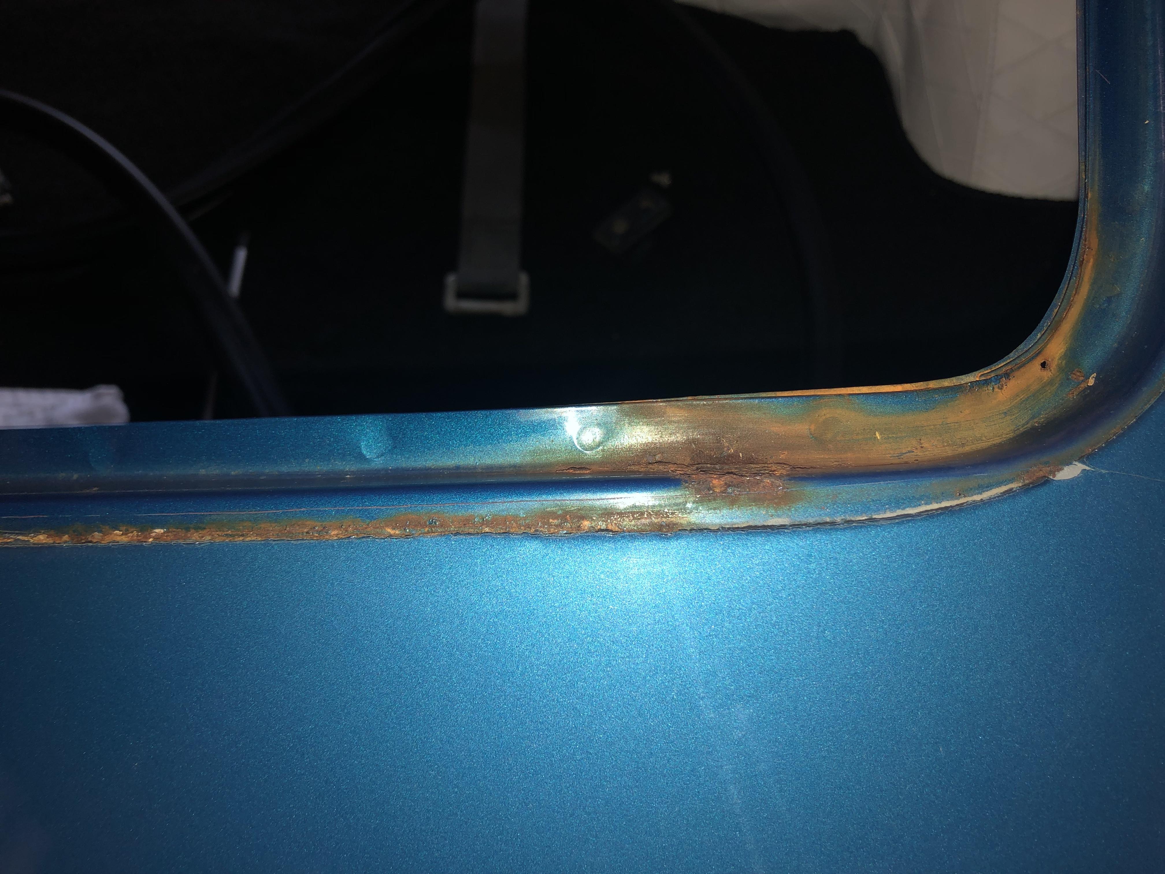

Next up repair a few small bad spots on the hatch and blend the paint.  Unfortunately the car was obviously resprayed at some point and time with the glass in it.   I will then and completely prep and respray the jamb.  All new gaskets and reassemble.

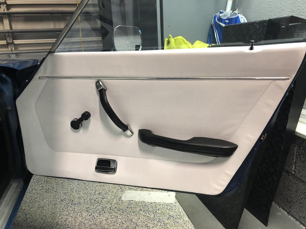

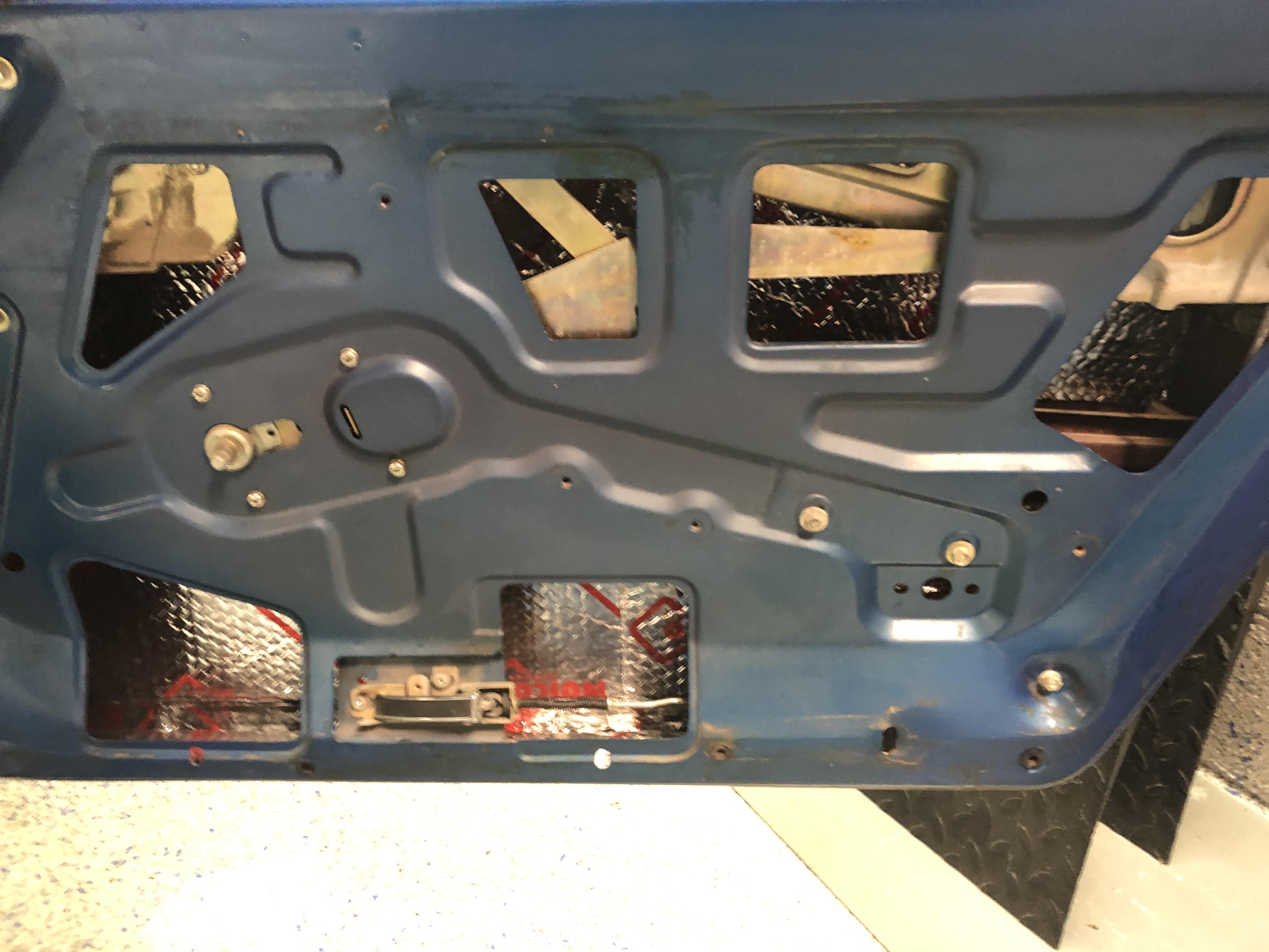

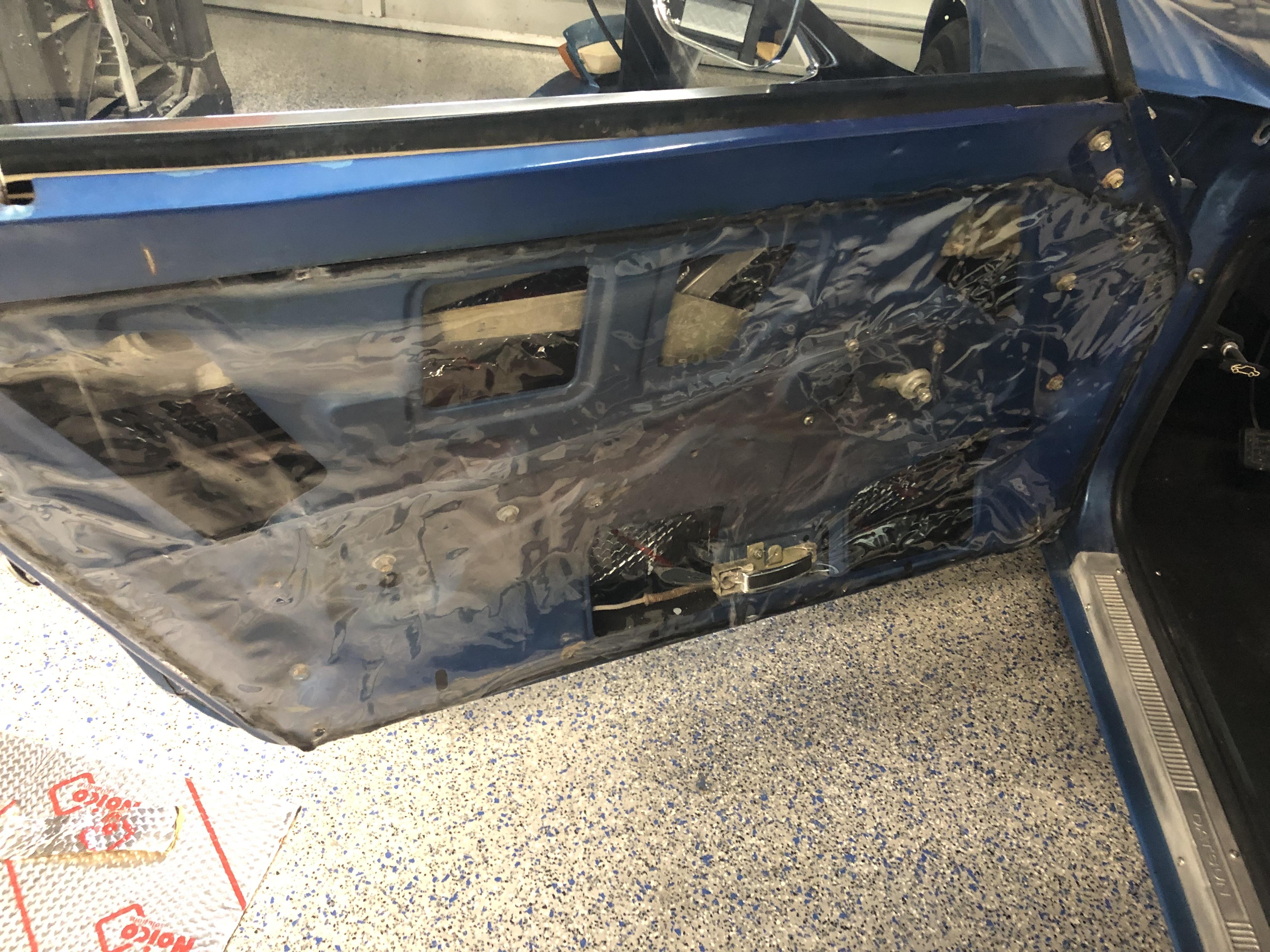

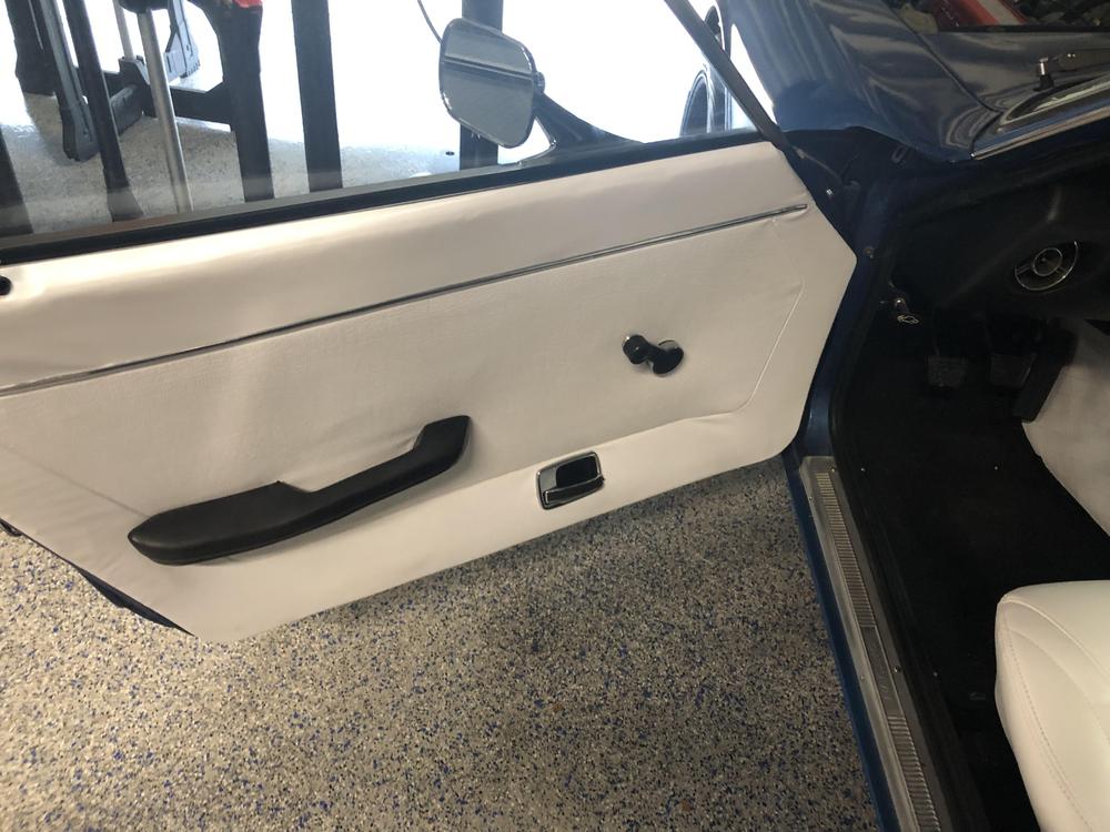

Door panels now complete, they are not in perfect shape but will do for now.  The passenger panel was originally a black panel.  I sprayed the panel and then used a foil tape to recover the stripe.  Prior to installation I lined the doors with dyna mat and installed new vapor barrier.

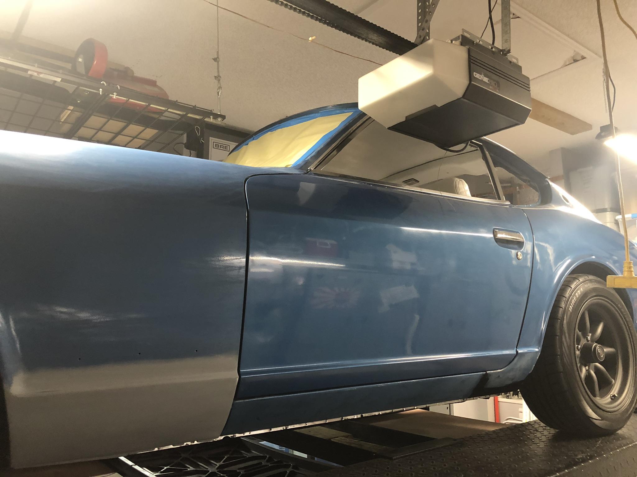

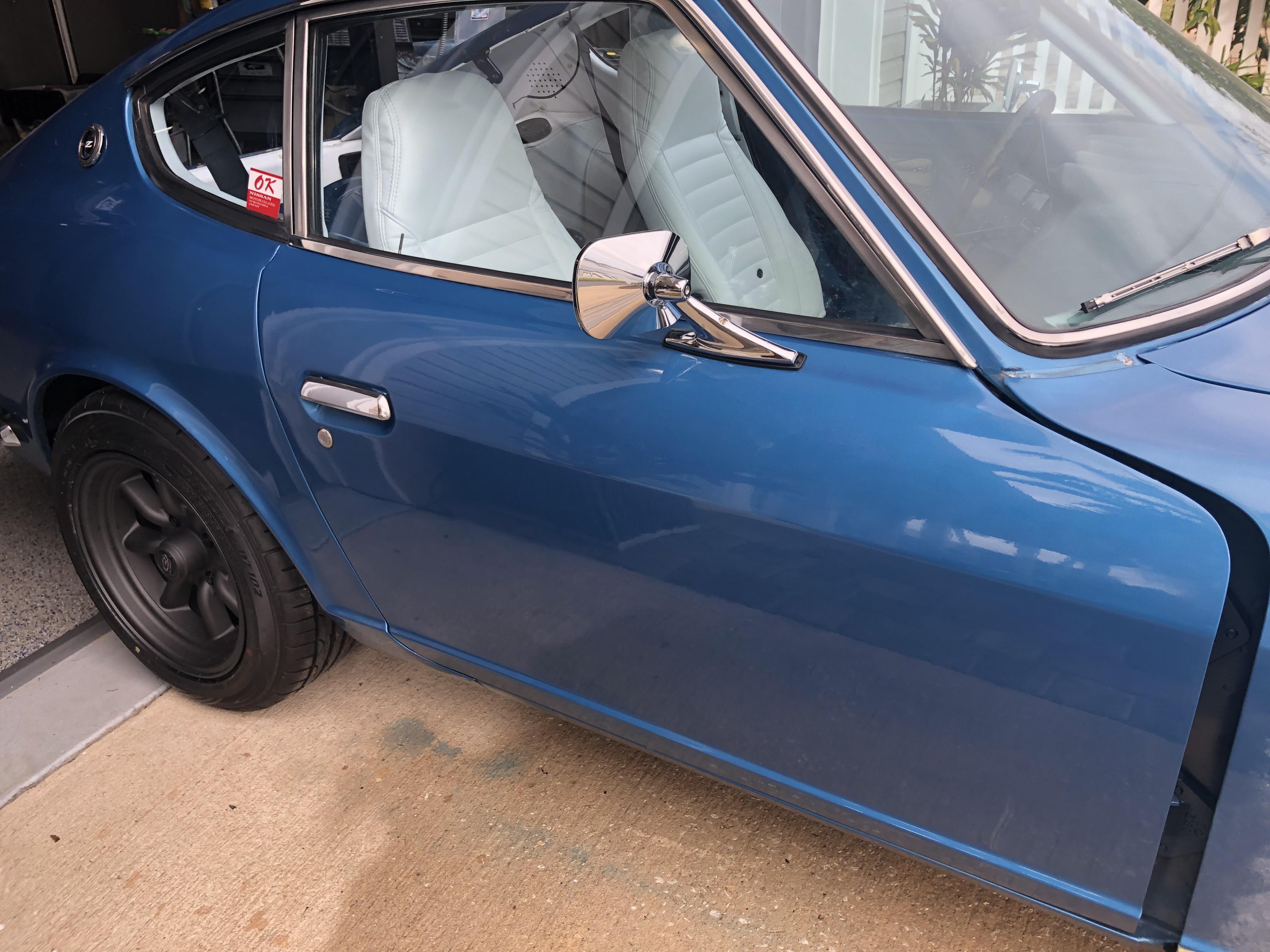

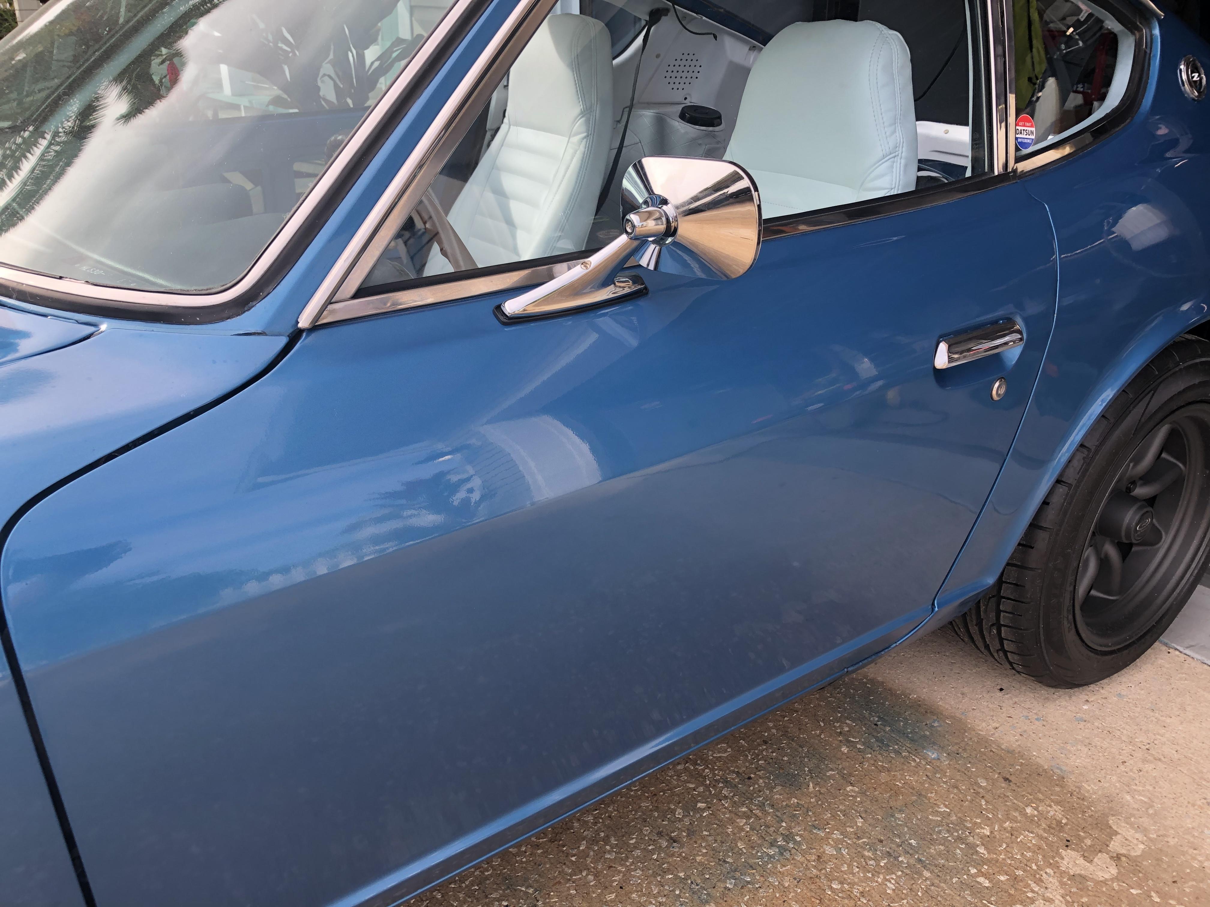

 Water sanded and buffed the door and installed new mirrors.

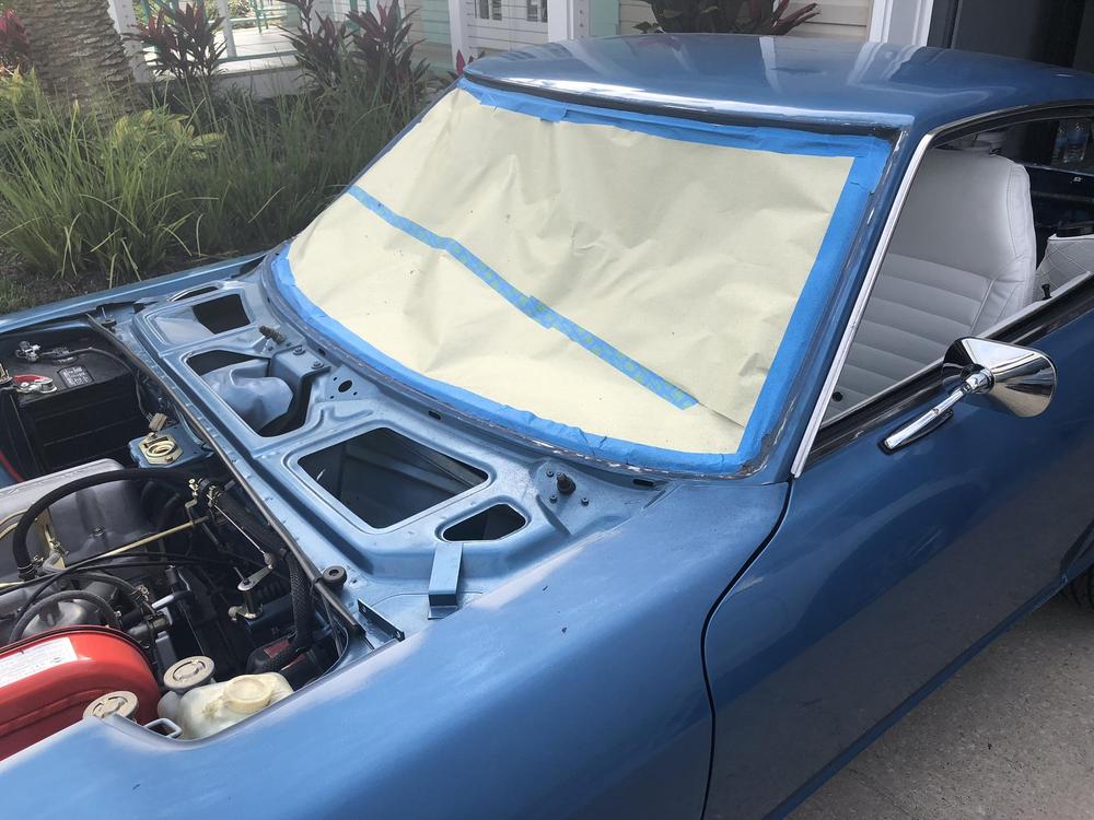

 Now on to refinishing the hatch.

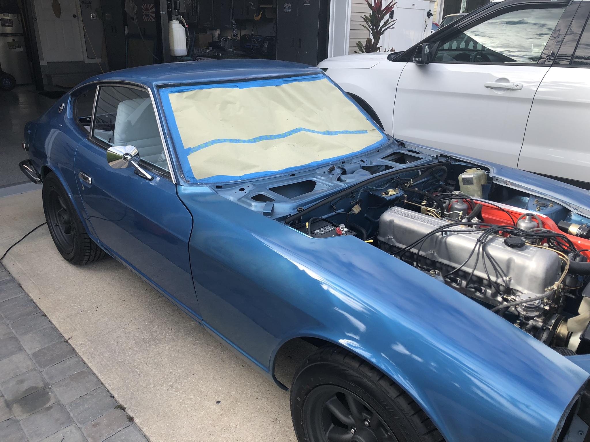

One step forward two steps back.  I have decided that I am going to respray the entire car sans the engine compartment, airdam and a few other bits.  I just cannot get a color blend that looks acceptable.  Car needs it anyway.
Great job....great thread. BTW, regarding the chrome tape on the door panels. Someone sells the real chrome strips for door panels. Can’t remember who....maybe Zcardepot. I love seeing people getting dirty lol.......keep the pics coming.
Thanks!  What’s needed is one that’s slightly larger than the one on the panel and has a groove so that it could be placed over the existing strip.  The existing strip is part of the vinyl door panel cover so it can’t be removed.  You can sort of skim it off with a sharp knife but you don want to cut to fat, the vinyl will split then it’s junk..

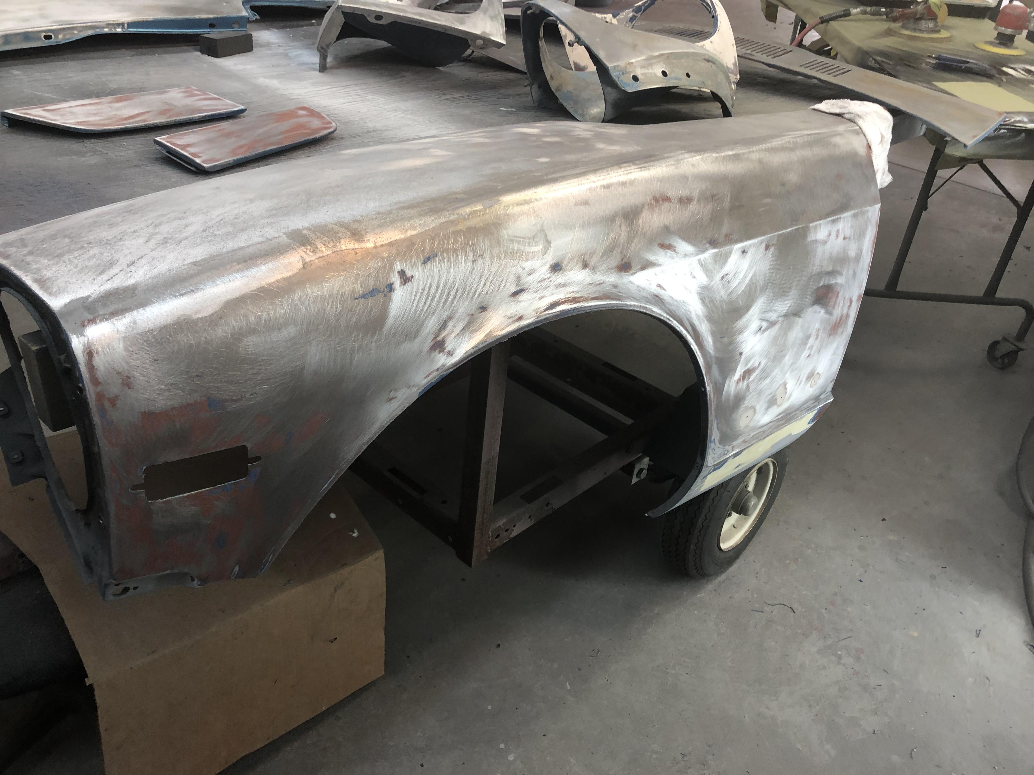

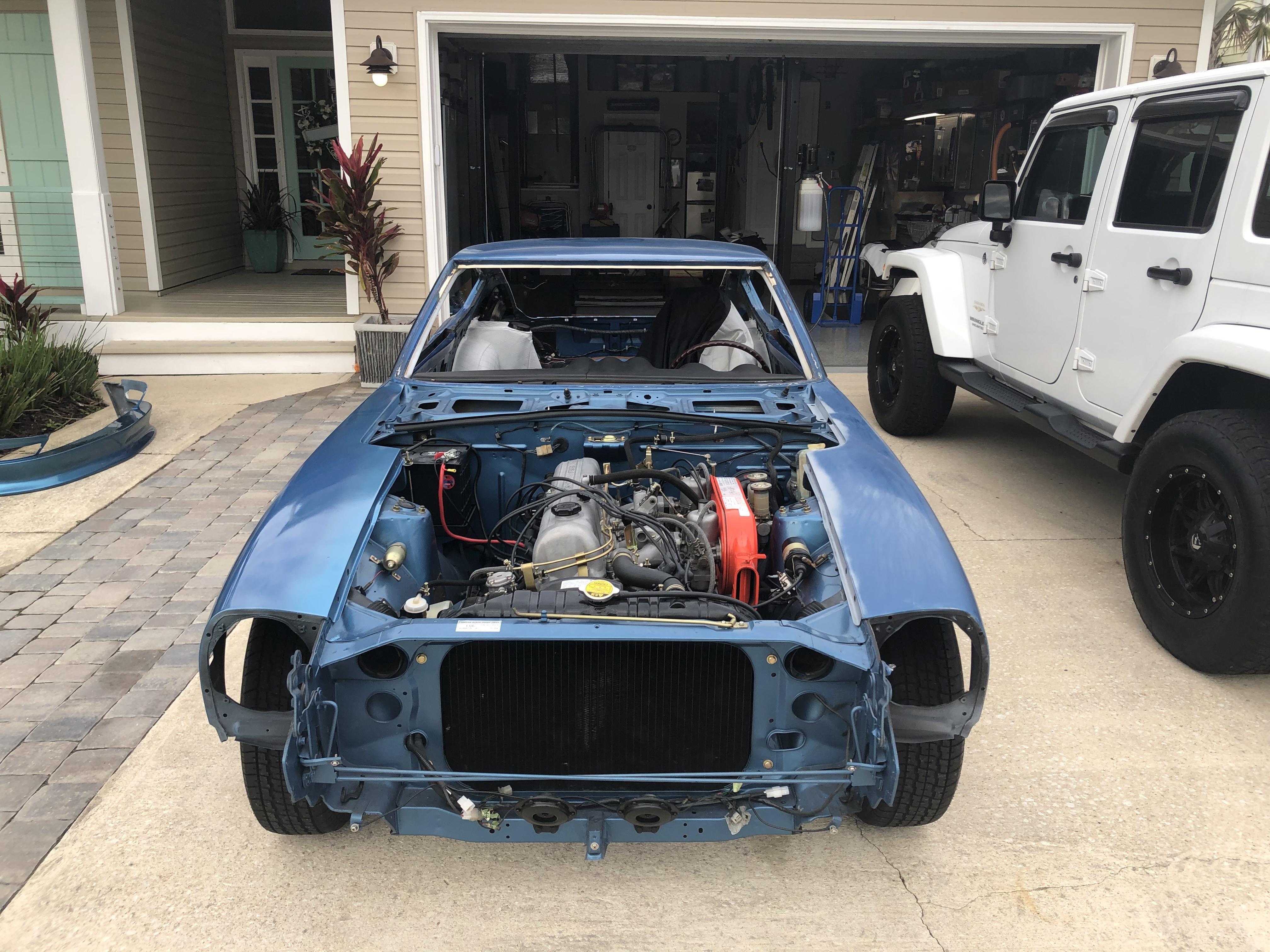

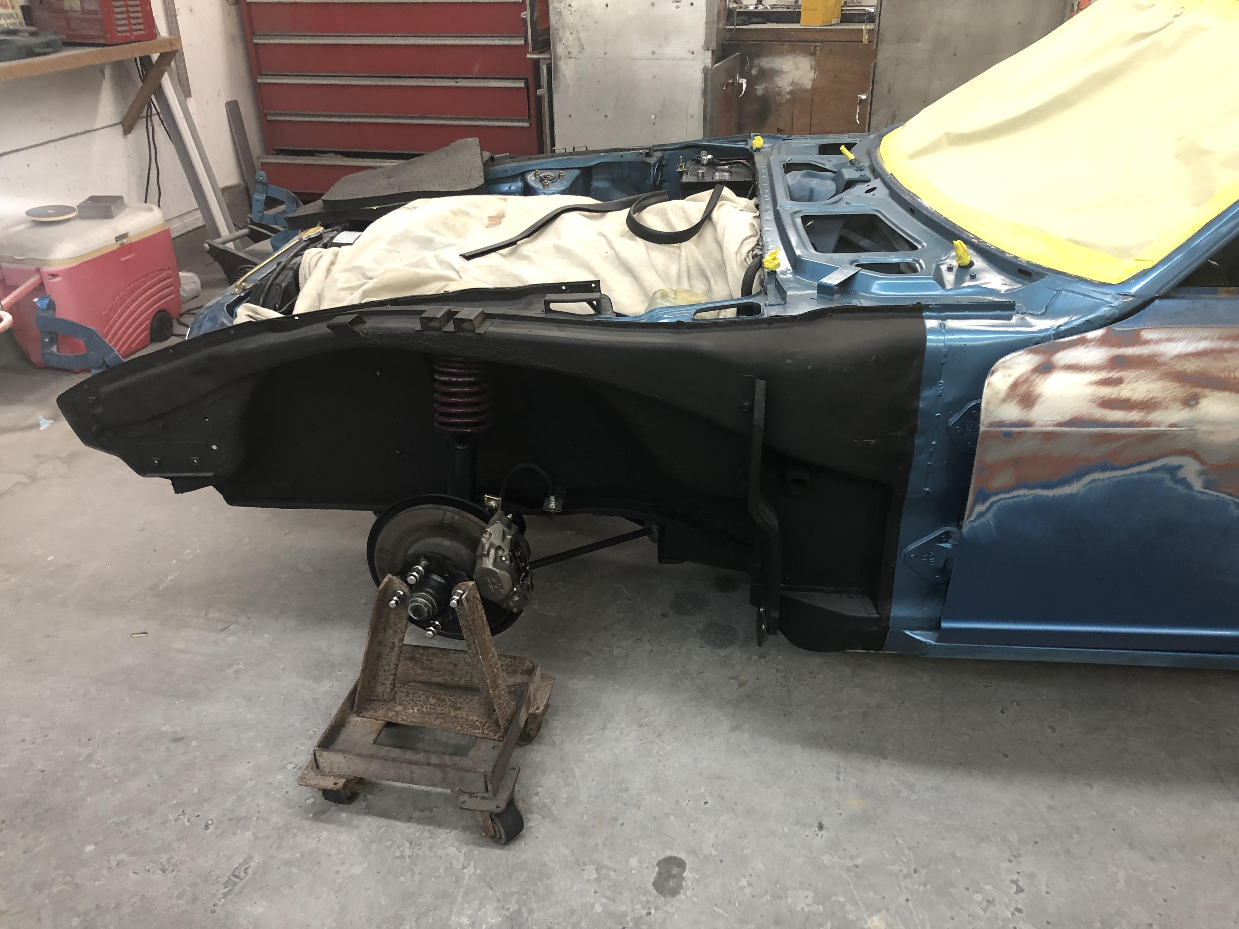

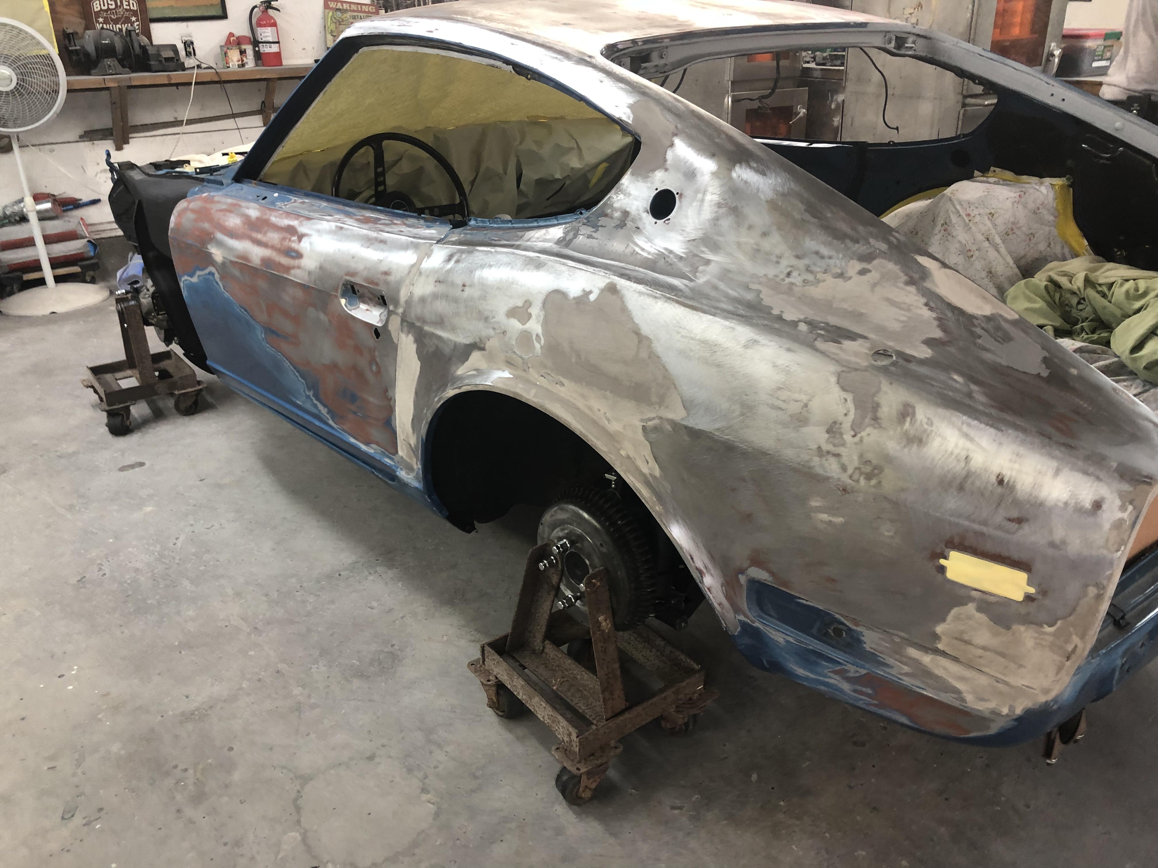

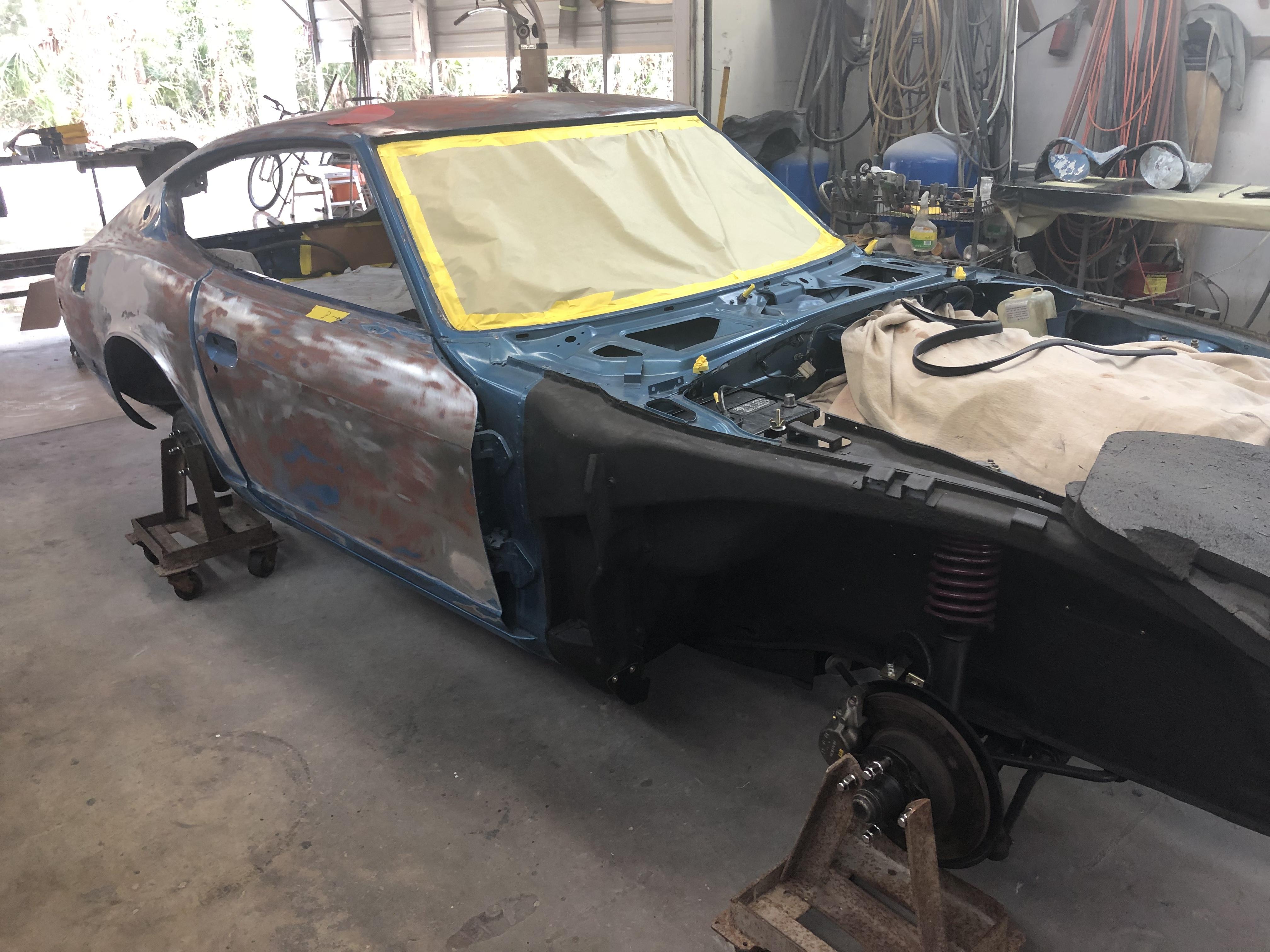

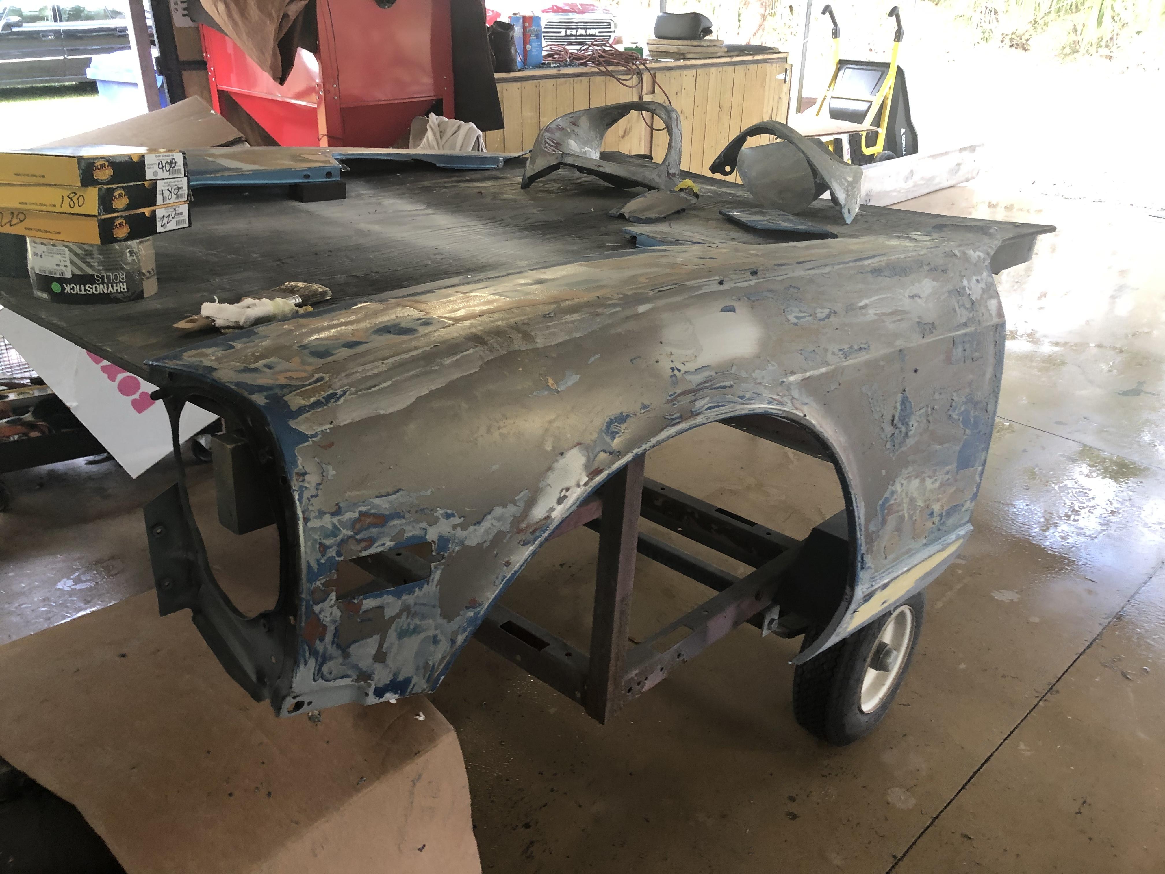

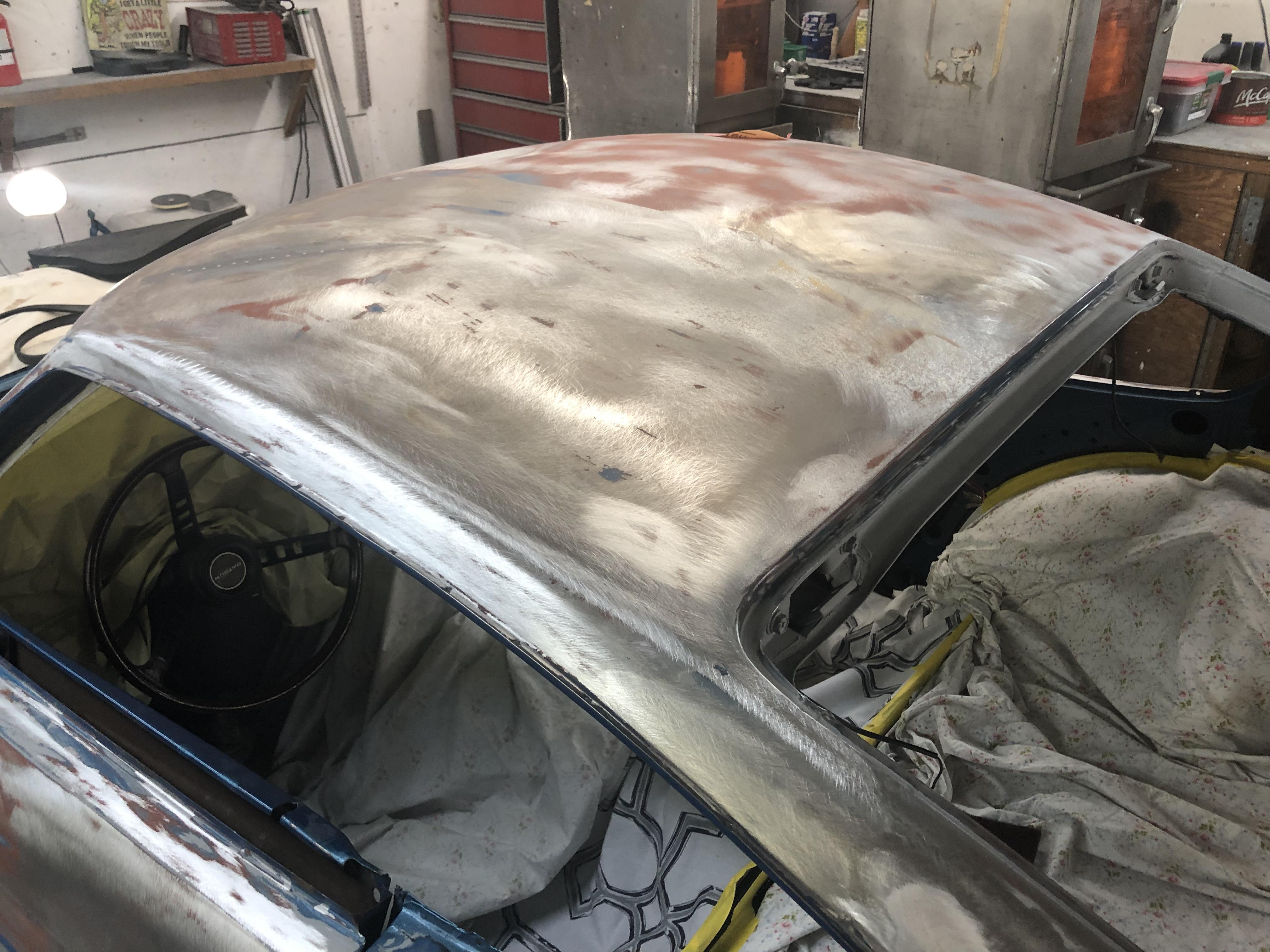

So here we are after just one week, the car is being stripped to bare metal and the old bondo will be removed.  I think his wheel chocks are clever, they allow him to have complete access and easily maneuver the car around his shop.

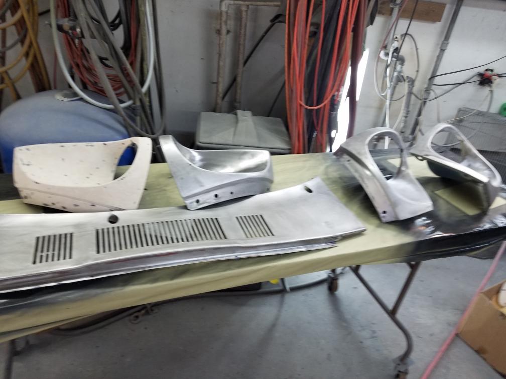

Parts stripped completely.  Will be having two set of headlight buckets painted, one set will have the head light lenses, one set will not.  The car had been in a front fender bender I’m guessing because one of the buckets is FRP and the other is metal.
