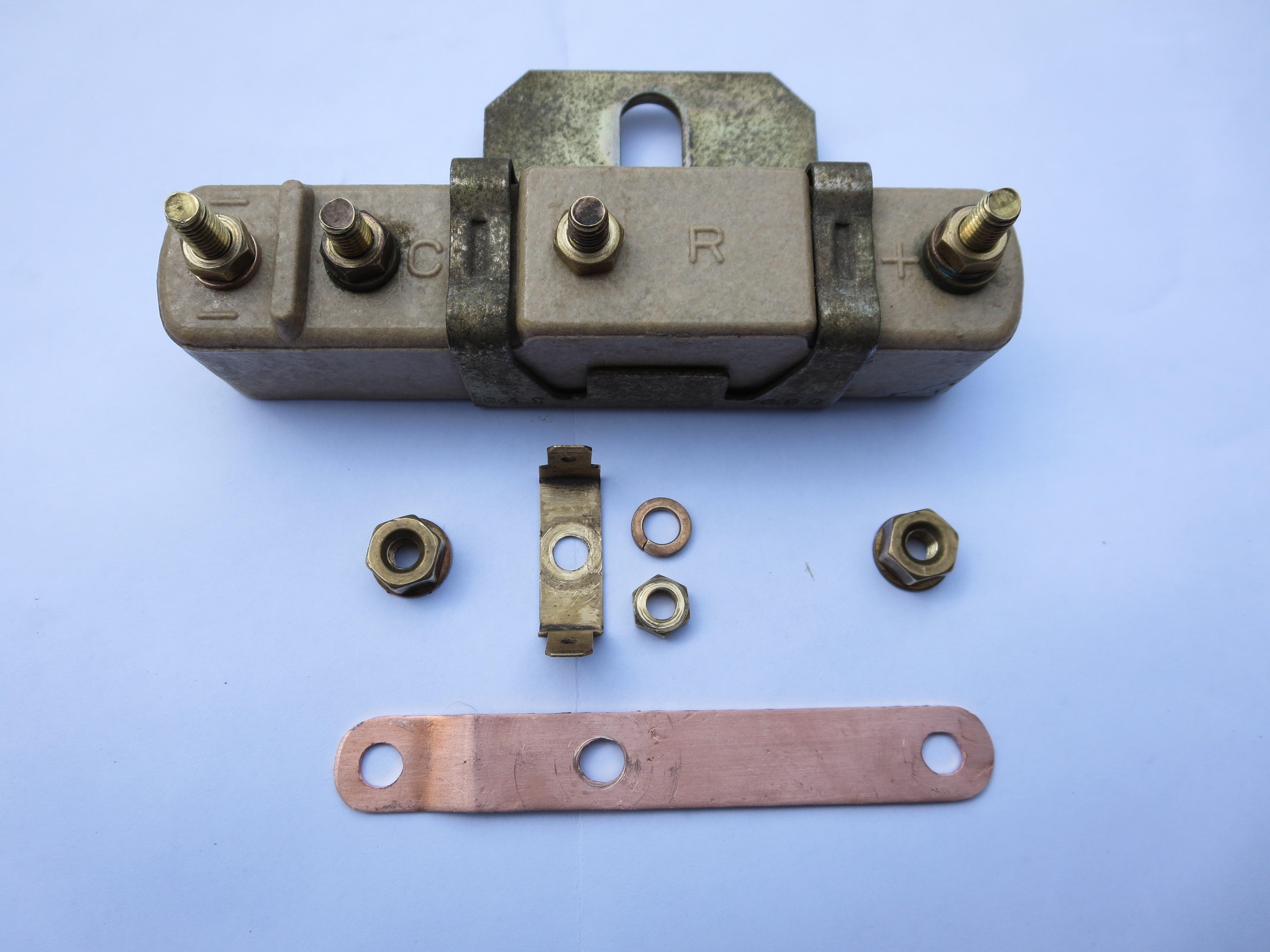

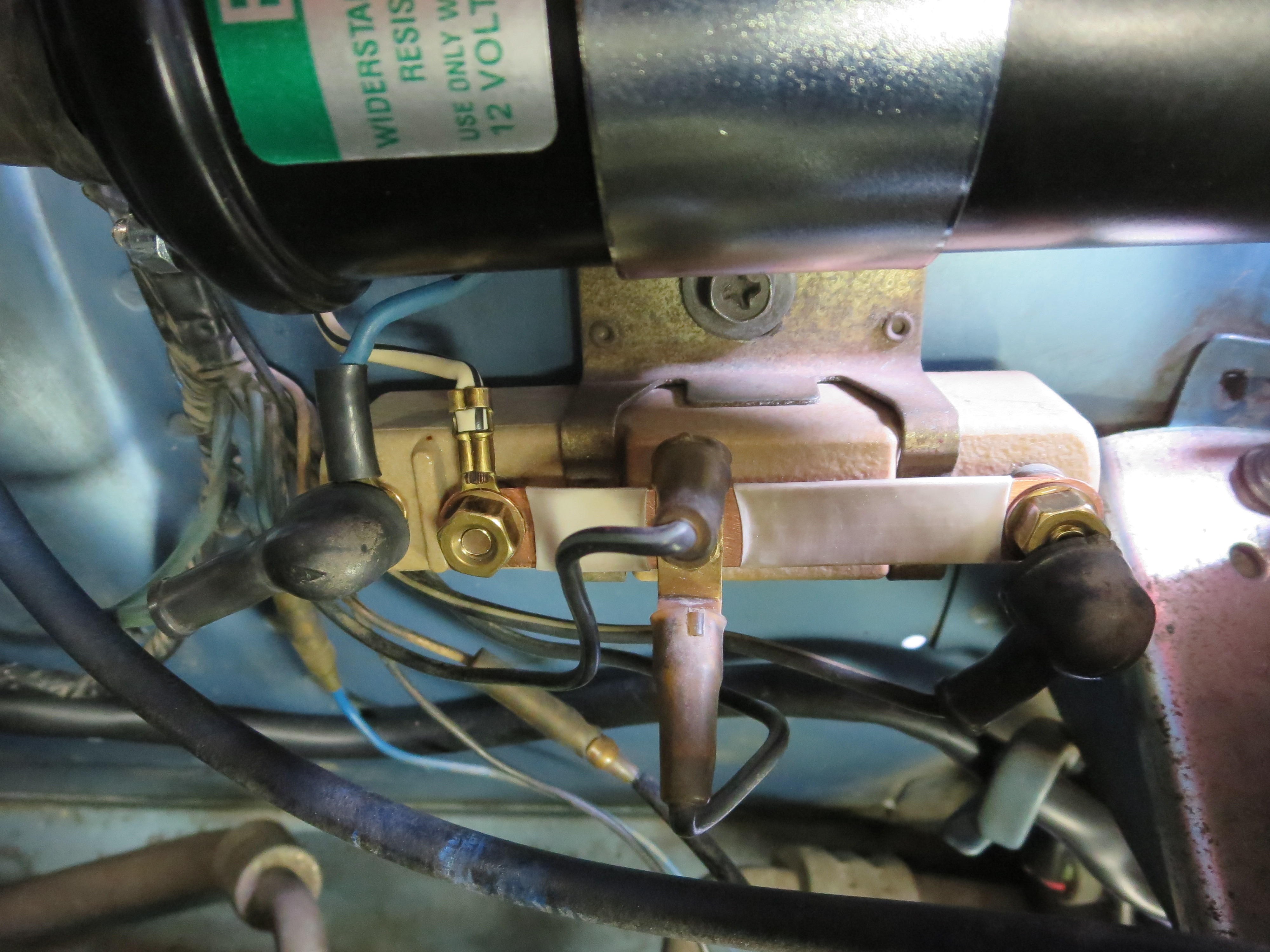

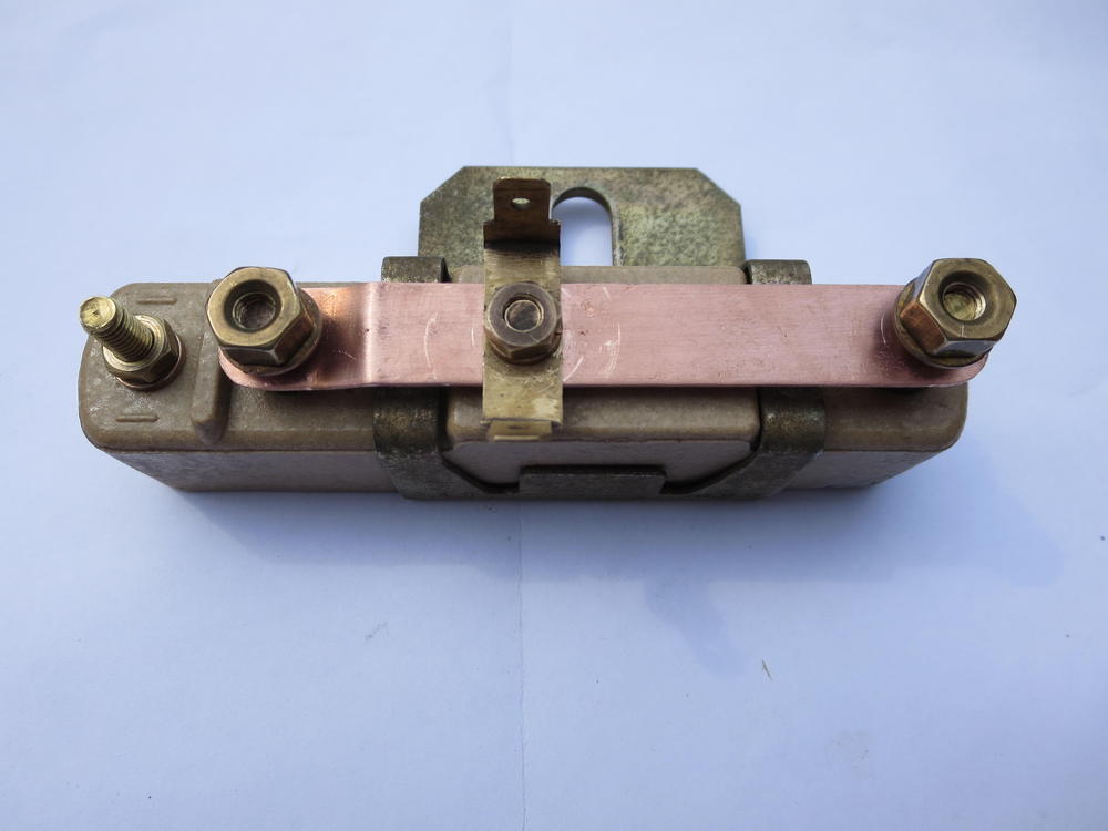

July 31, 20186 yr comment_554269 When I changed over to the HEI module I bridged the ballast resistor and fitted the HEI module into the old TIU case to keep it as original looking as possible. Edited July 31, 20186 yr by EuroDat Link to comment https://www.classiczcars.com/forums/topic/60473-260z-or-280z-distributor-into-240z/?&page=2#findComment-554269 Share on other sites More sharing options...
