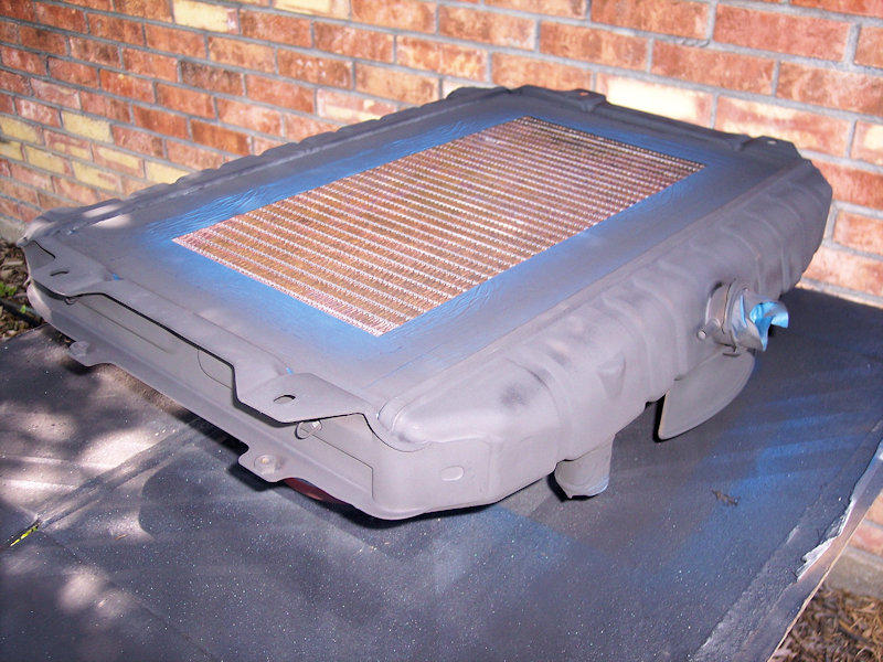

Finally got the radiator back from the shop yesterday.  Whenever I have this type work done I always specify "no paint".  Cleanup the tanks and frame with a Dremel and a cup brush, wipe down with wax and grease remover, tape up and primer.  Wet sanding and gloss black paint on the schedule for tomorrow.
