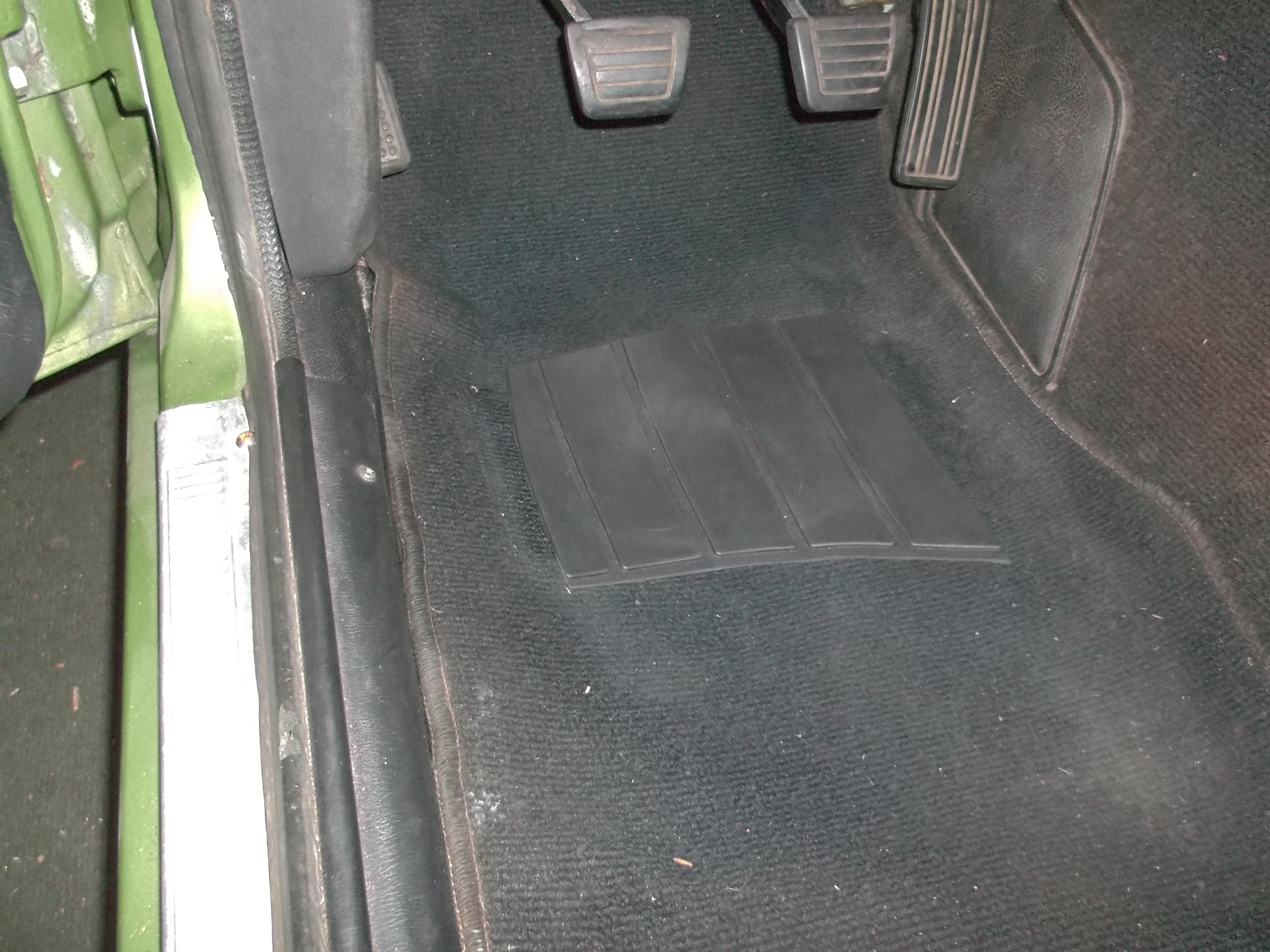

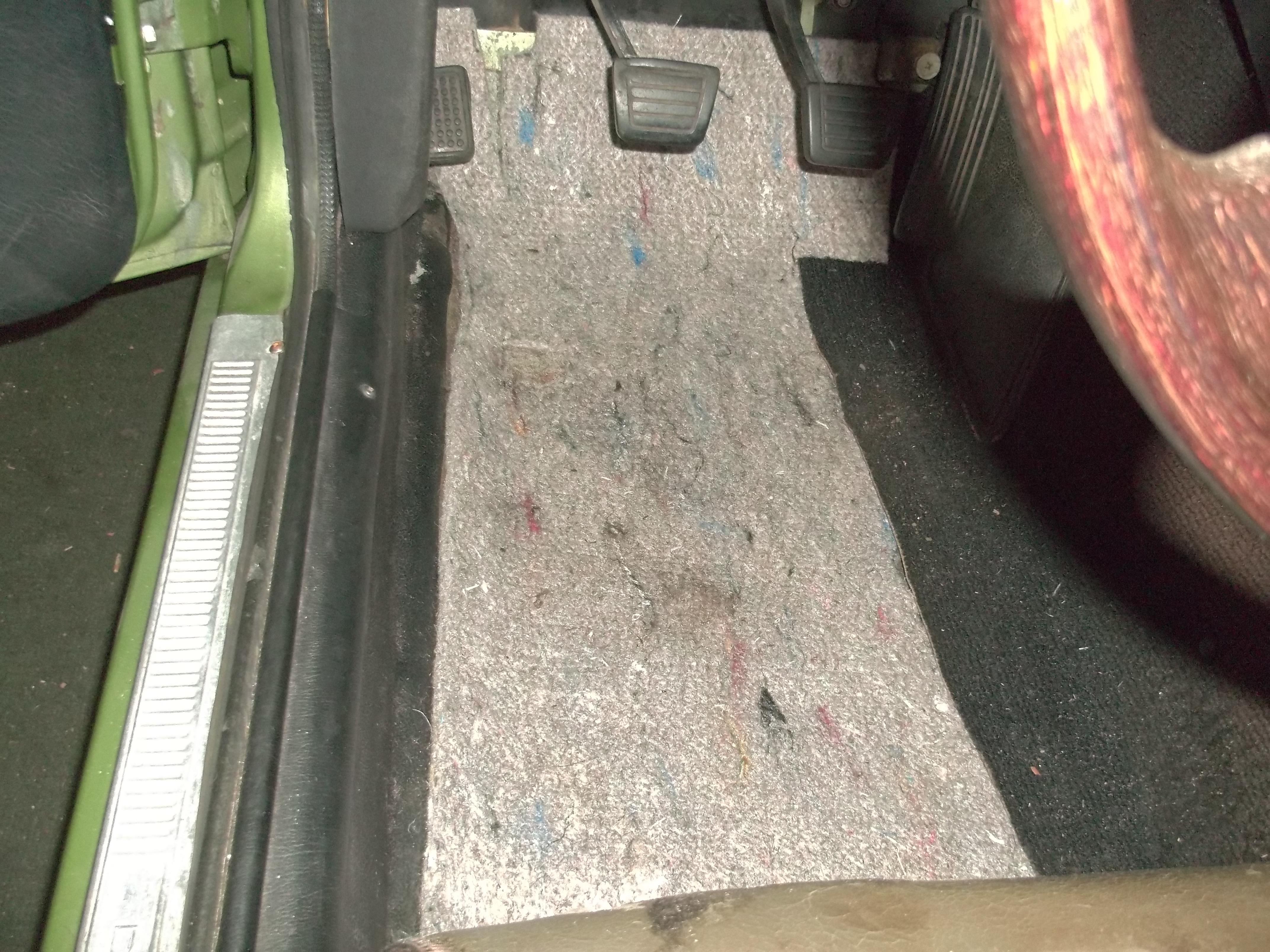

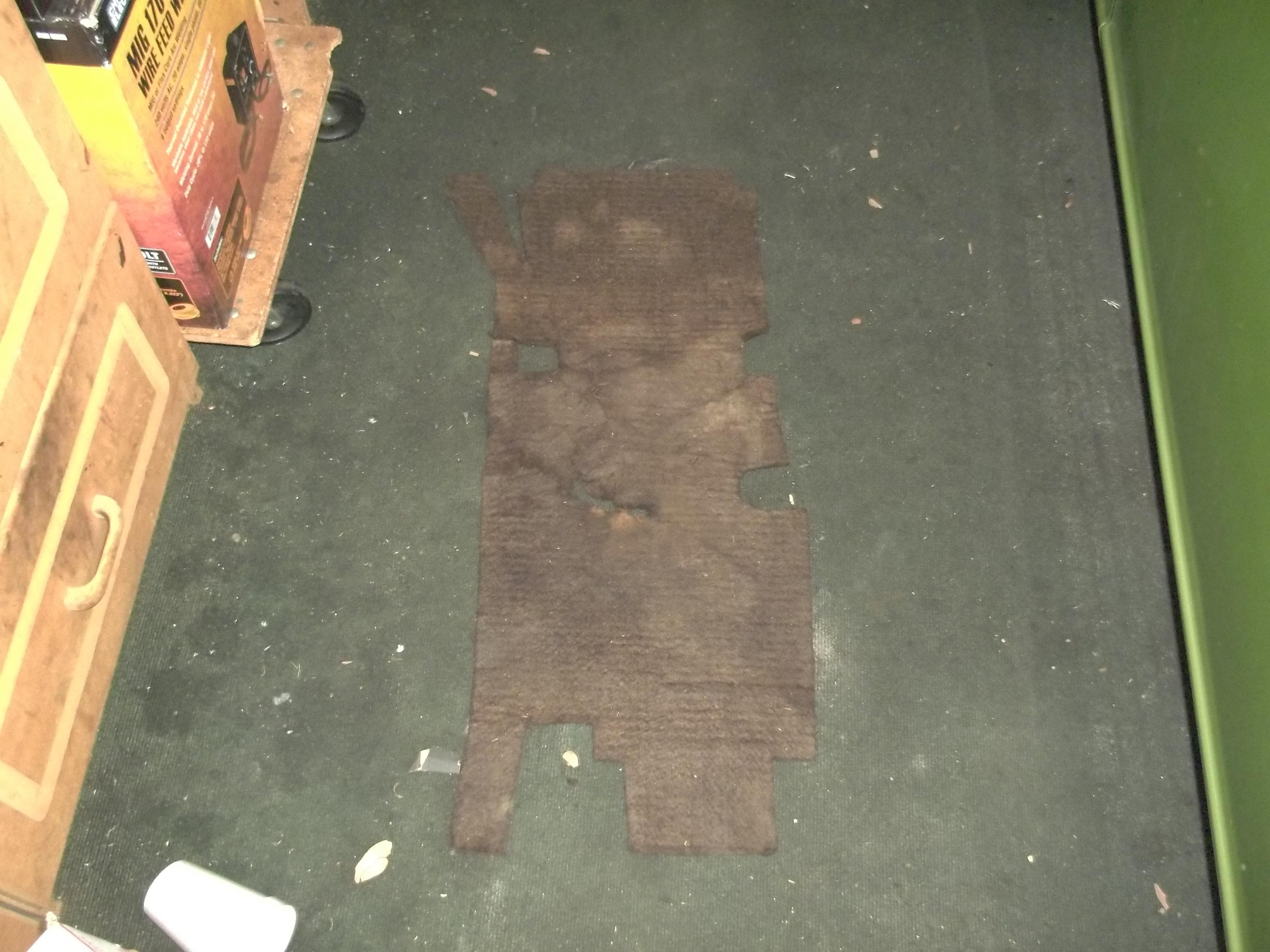

bought some jute from Mac's used the old beat up jute as a pattern. the little rubber heel guard was shot so I just cut up a junk yard mat for now. I have found that hook of hook and loop grabs the carpet very well so I will end up getting some replacement rubber that is a better fit. The  OE carpet had it sewn on. The rubber backing on the carpet is about 20% gone, the plan is to try some plasti dip spray to add back the missing rubber backing.
