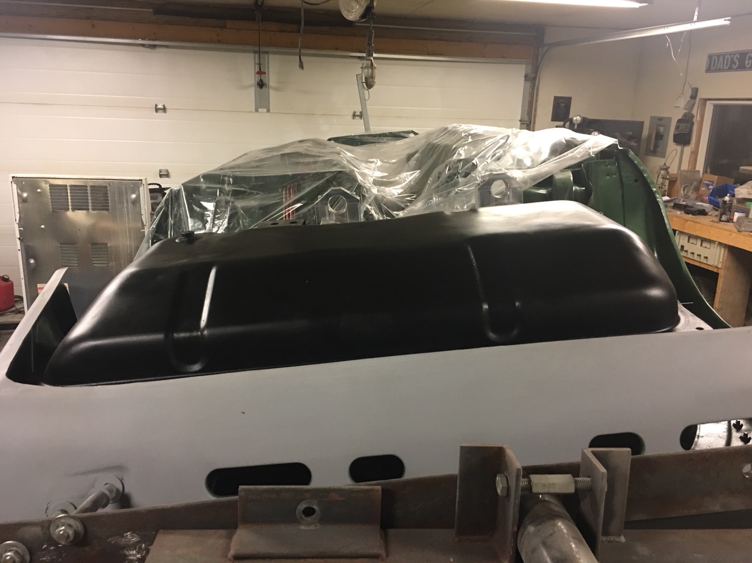

I dropped and restored the fuel tank.  It now looks great; no rust and property coated.  But to disconnect the vent hoses from the tank required the use of a long screwdriver to pry the vent hoses off the tank.  That is because the '75 Z does not have an inspection panel for easy access to the hoses.  Now how do I re-connect the vent hoses to the fuel tank?
I reconnected the hoses with the tank partially installed. They were disconnected from the vapour tank first to give some extra reach down to the tank. Then with them properly attached, I mounted the tank complete. I also had the car on the rotisserie to do this so that made a huge difference too.
