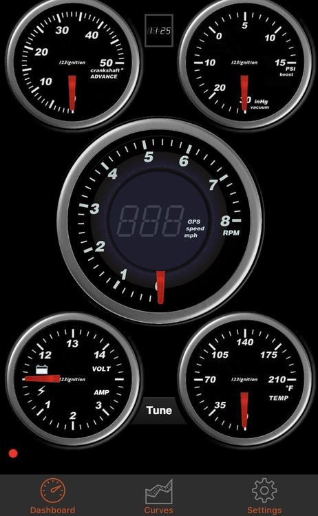

I have a ‘73 240Z stock tach and 123ignition tune+ (Bluetooth).  I love it, and the Tach (and all my gauges) work and almost exactly match the 123i IPhone app display.
The features are awesome:-
Tunable advance curves.  Multiple File load/save   + Live Analog  Adv. Display
(Track /Street Tune)
Tune “on the fly” from Bluetooth app, but only +/- of advance.  You have to edit the curve(s) and reload with engine off to make permanent changes.
Tunable Vacuum map + Live Analog Vac. Display (in Hg)
Max RPM setting (dizzy enforces by random spark cut)
Tach - (from Dizzy Analog display)
GPS MPH (Digital display)
Dizzy (~Battery after Ballast if installed) Analog Voltage /Amps
Temp Analog (I assume this is engine compartment taken from Dizzy housing)
Oh and Immobilizer with PIN. I previously used a “kill switch” that grounded the (-) side of the stock dizzy to do this.
OK. It is a bit pricey- but I’ve been looking for these features without replacing the stock gauges.  I replaced a Mallory electronic dizzy, but it had mechanical advance and the vacuum was diaphragm type.  Changing advance curves involved changing weights in the Dizzy ?
