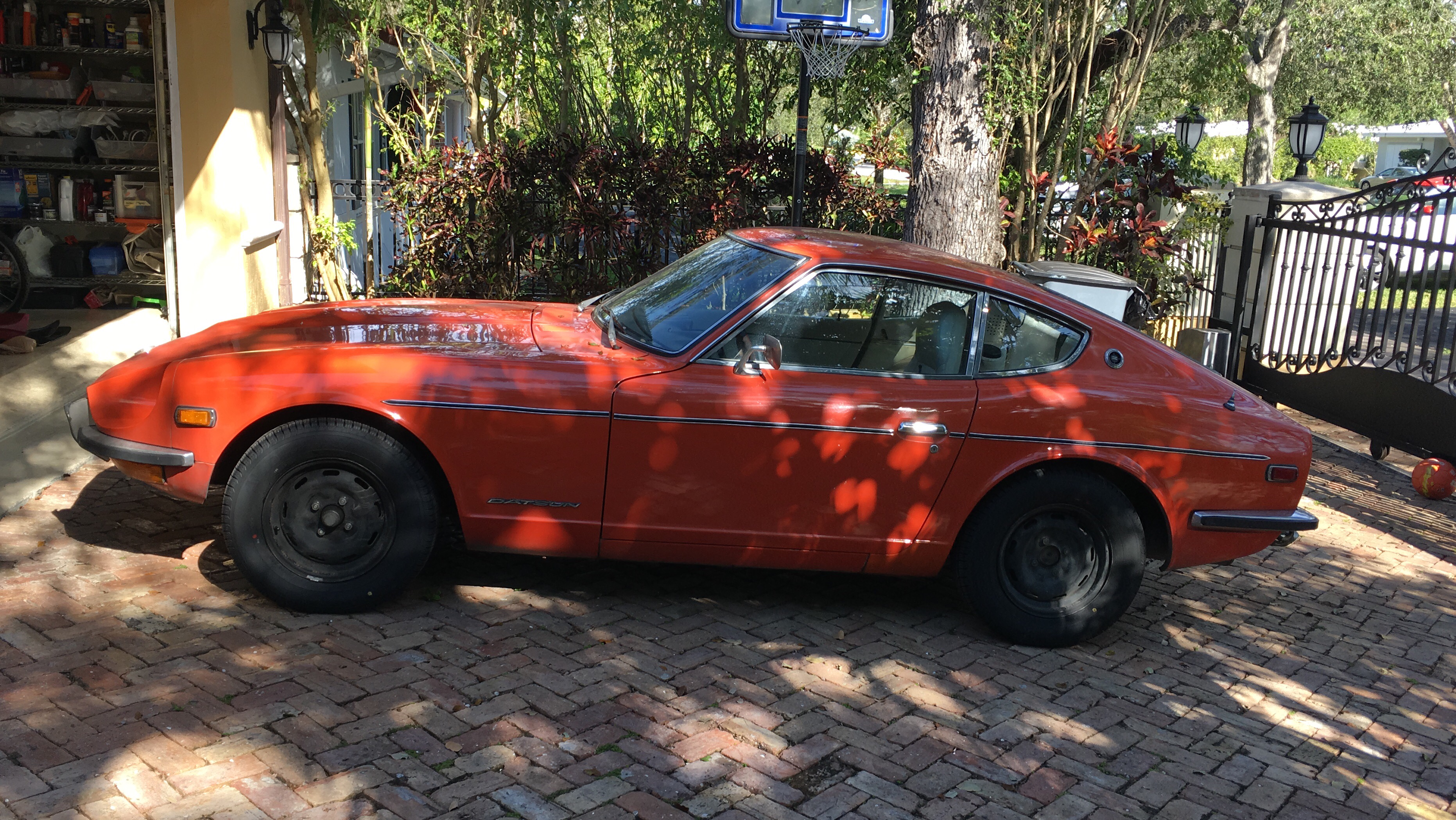

Hi everyone, I'm new to the forum and also ownership of a 240Z.
Bought this car less than a month ago and the car is a 3/72 production.

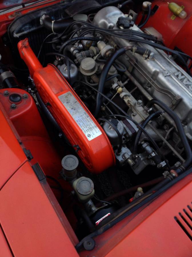

The car came with a L28 engine (stamped in block are raised numbers reading F54)  with what appears to be a 5 speed transmission (not yet know from which car....).
I have purchased a correct L24 engine with E88 heads and a Type B 4 speed manual and will be swapping this soon but will highly appreciate your comments and help about this.

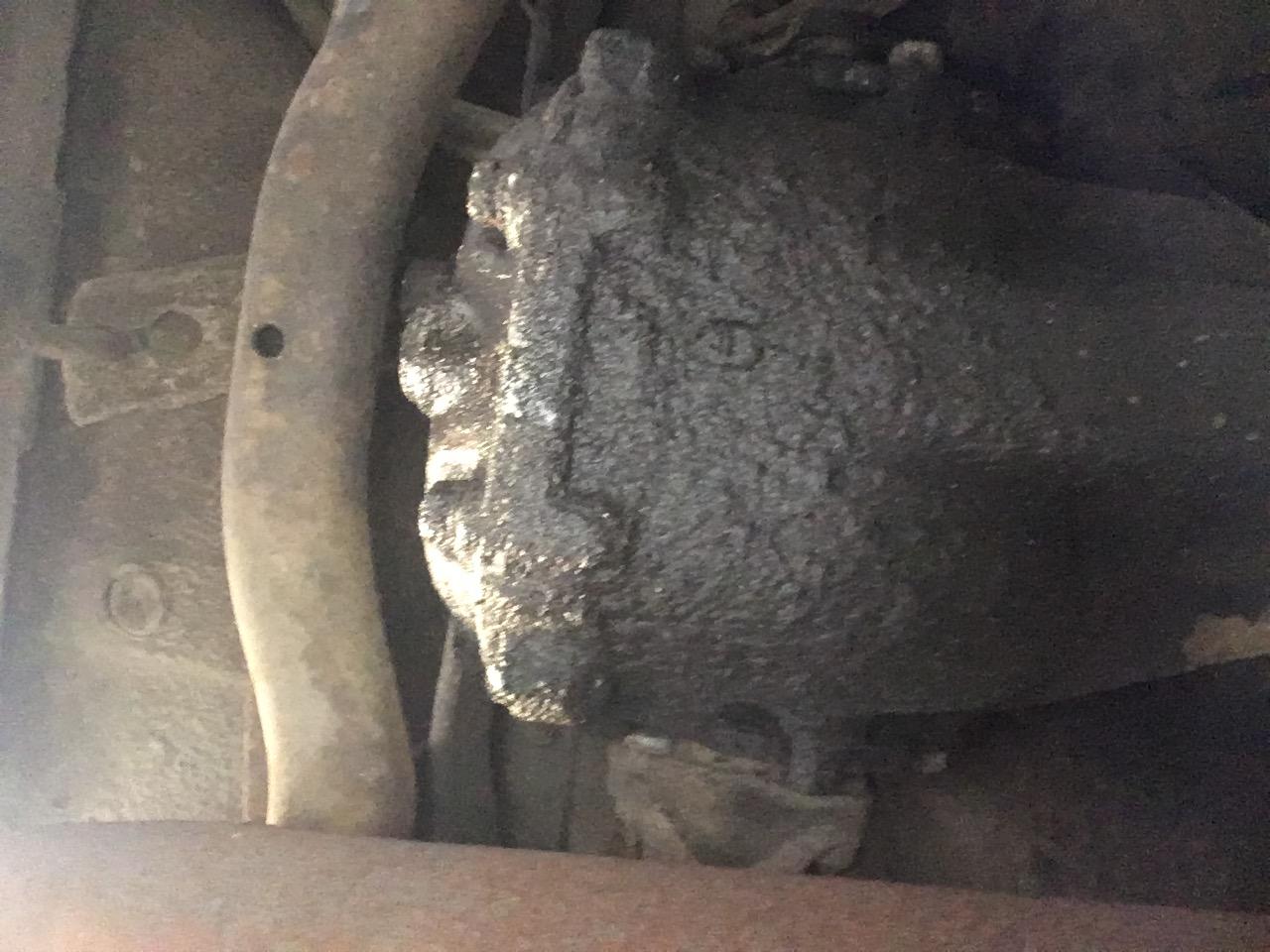

Specially I cannot figure out if the differential has been also swapped is there any way to find out?
Any tips on doing this change the right way?
The former owner that did the swap of the L24 for the L28 kept the E88 intake manifold in order to retain the original L24 carburetors and air intake.

Many thanks for this, here is a picture of the actual differential,what do you think?
Looks like a R180 to me but it's hard to tell.  My R180 with a 5 speed does excellent on the highway.
Thanks for that, saw that article, the actual engine has P90 heads. But I'm scratching my head about the transmission...
In case that the differential was not changed and is still the one that came with the car, do you think I will have to find a new drive shaft?

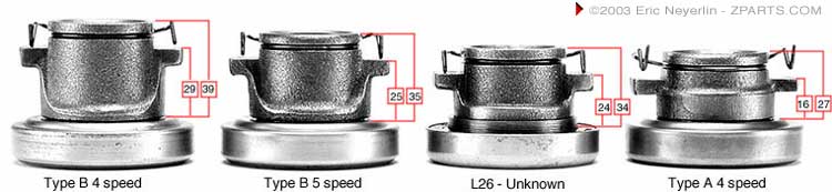

I took the OE 4 speed out of my '72 and installed a later 280z 5 speed without issue other than the clutch collar.  The 4 speed is shorter so the collars have to match the transmission.
