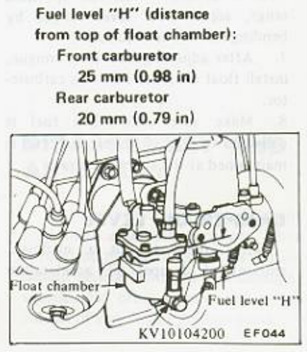

March 21, 20187 yr comment_545291 Check Fuel Level like below. It states two different levels for those carbs.  Funny that average is 23mm down.  Link to comment https://www.classiczcars.com/forums/topic/59088-510-sus/?&page=5#findComment-545291 Share on other sites More sharing options...
March 22, 20187 yr Author comment_545322 3 hours ago, 240260280 said: Check Fuel Level like below. It states two different levels for those carbs.  Funny that average is 23mm down.  Is that from the inside of the lid? Not the top edge of the bowl? Link to comment https://www.classiczcars.com/forums/topic/59088-510-sus/?&page=5#findComment-545322 Share on other sites More sharing options...
March 22, 20187 yr comment_545332 The drawing shows the top of bowl as the reference. Link to comment https://www.classiczcars.com/forums/topic/59088-510-sus/?&page=5#findComment-545332 Share on other sites More sharing options...
March 22, 20187 yr Author comment_545345 Another question. I don't know that I have ever heard the answer, why are the front and back set differently? Link to comment https://www.classiczcars.com/forums/topic/59088-510-sus/?&page=5#findComment-545345 Share on other sites More sharing options...
March 22, 20187 yr comment_545348 Different fuel levels is a mystery. Some speculate that it may have to do with one float swinging open under acceleration while the other closes as the fuel sloshes to the back of the bowl. Link to comment https://www.classiczcars.com/forums/topic/59088-510-sus/?&page=5#findComment-545348 Share on other sites More sharing options...
March 22, 20187 yr Author comment_545352 These floats are detached and fit pretty snug in the bowl bores. Not really any way for them to pivot...curious... Link to comment https://www.classiczcars.com/forums/topic/59088-510-sus/?&page=5#findComment-545352 Share on other sites More sharing options...
March 22, 20187 yr comment_545356 Hmmm now even more interesting. Link to comment https://www.classiczcars.com/forums/topic/59088-510-sus/?&page=5#findComment-545356 Share on other sites More sharing options...

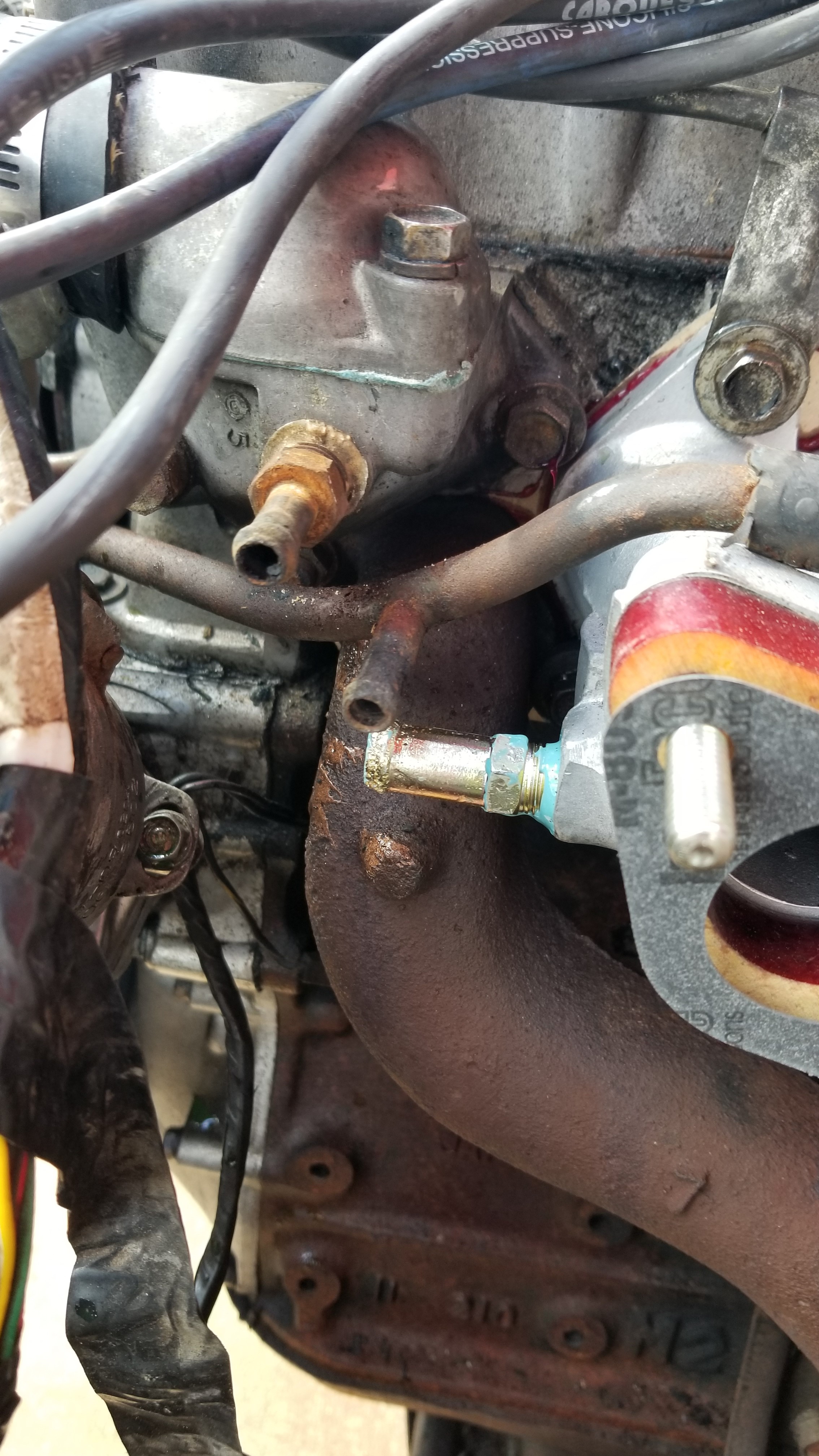

March 23, 20187 yr Author comment_545434 One of the needles is new from Ztherapy. The other is unknown... might should have bought two... I have another question, there is no port for the vacuum advance. Can I use another port off the manifold? In other words, is there anything special about where that port exits the front carb. The is no booster on Cody's car so I could use that port for vacuum advance and still use the center port for the PCV valve... Also there were a number of water ports near the carbs. Best I could tell water flow was from the head into the manifold then towards the front. The port out of the thermostat housing and the 90 degree tee out of the straight line were tied together with a hose and the other went to the old carb. For now I plugged the thermostat hole and connected the su manifolds to the line that runs around the front of the head. Should I do it differently? Edited March 23, 20187 yr by Patcon Link to comment https://www.classiczcars.com/forums/topic/59088-510-sus/?&page=5#findComment-545434 Share on other sites More sharing options...
