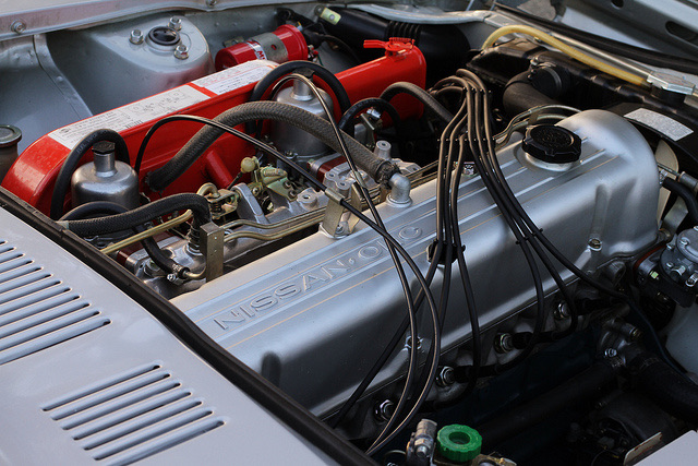

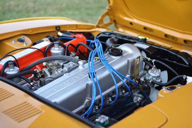

October 30, 20177 yr comment_533681 Here’s three that I did that way..... Link to comment https://www.classiczcars.com/forums/topic/58837-restore-ugly-valve-cover-mistake-to-media-blast/#findComment-533681 Share on other sites More sharing options...
