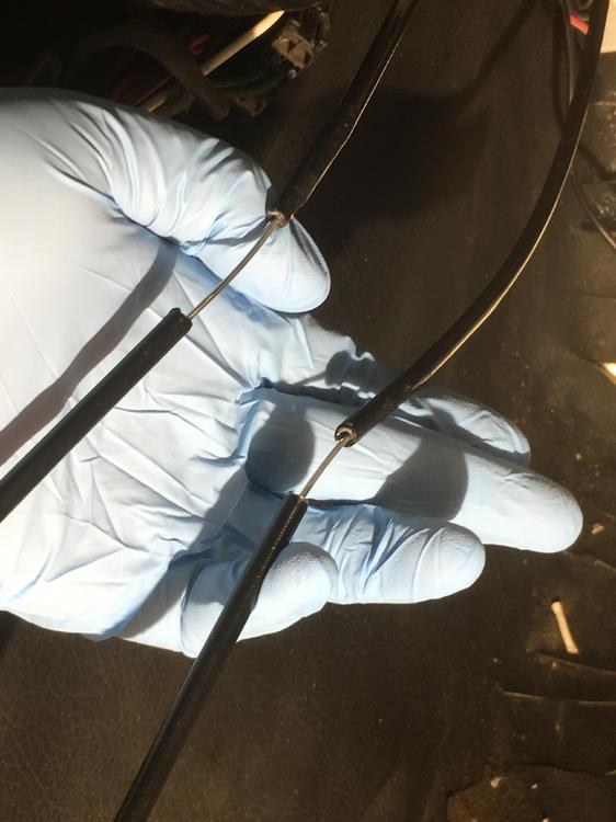

Could that be where they go through the firewall? Weird they're broken open at the same spot. You have a 260, right? I don't think I've ever seen one in person so I'm just guessing.

There are hours of videos on YOUTUBE  that explain tuning our carbs step by step. You can see what moves if the choke is operating properly, how the mixture happens, etc. Being able to see and hear really removed the intimidation factor for me even with triple side drafts. The choke cable sheath if in disrepair will change the travel limit of the enrichment circuit, possibly not allowing full travel even when you have exhausted the travel of the handle on the console. I like your style, NOT AFRAID. Do some more reading and try to put aside time for learning. Get the correct tools so as not to ruin anything. Z Therapy also is a good technical resource. Be patient and good luck.
