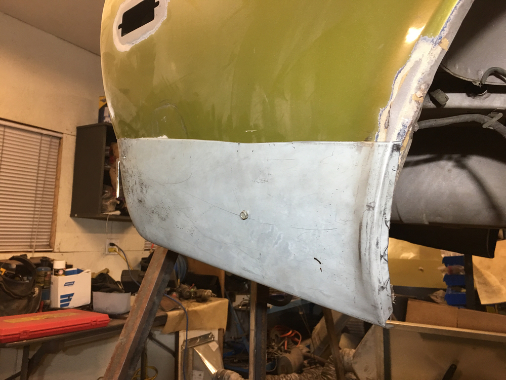

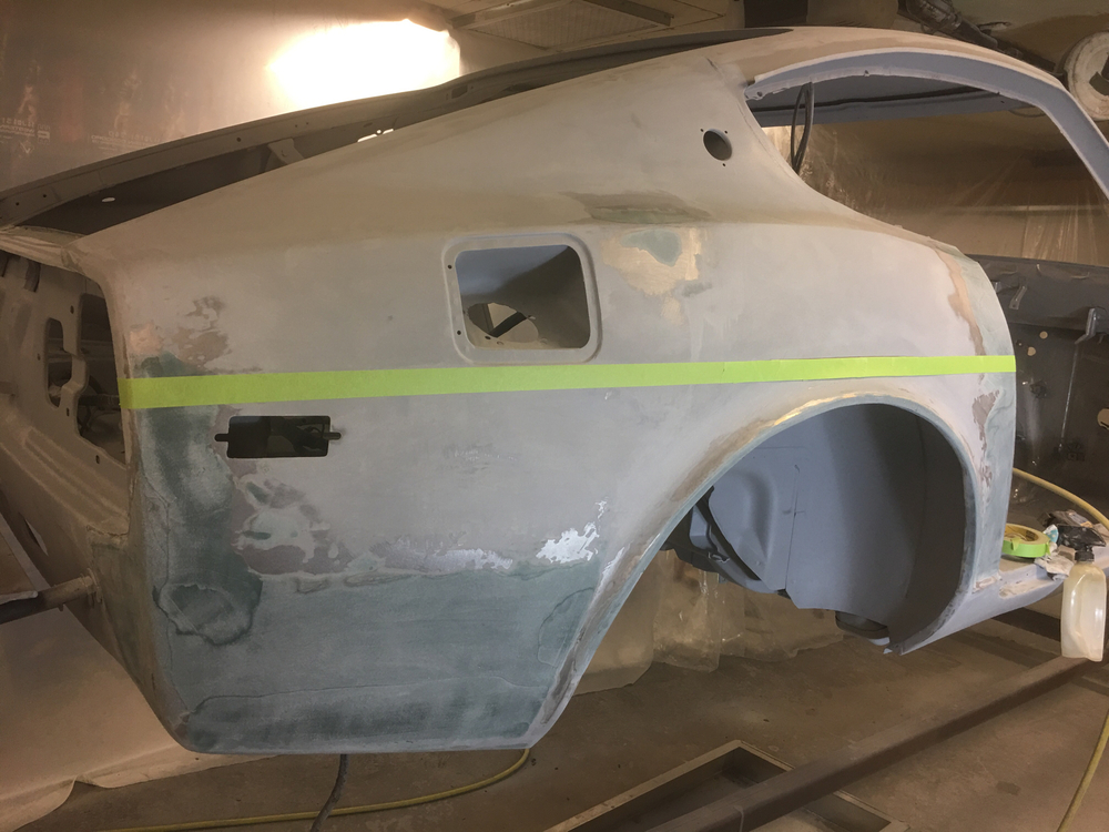

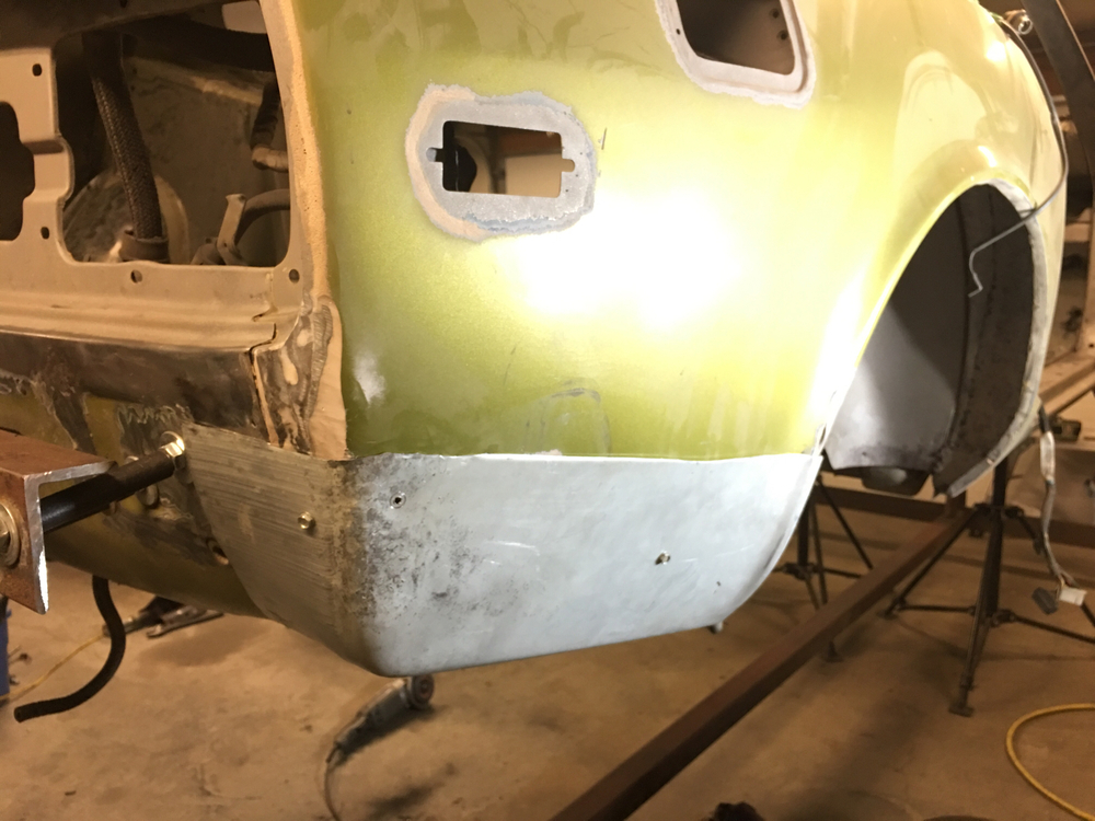

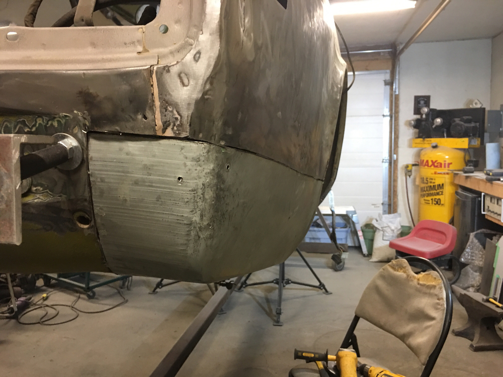

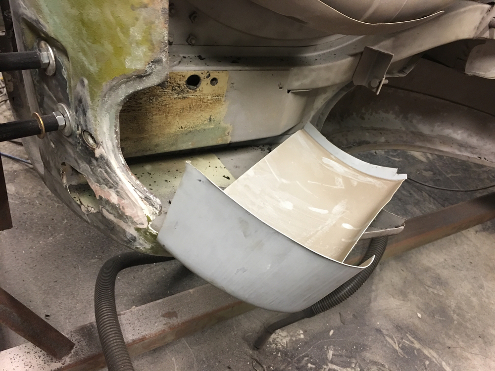

Tabco panels are a rough start... they will need some massaging to get to fit properly. Experienced body man is recommended for that, but it can be done by someone with the right tools and patience. lots of pics below of my Tabco lower rear quarter replacement. I bashed it a bit and then smoothed the lines with filler. It looks really good now...
