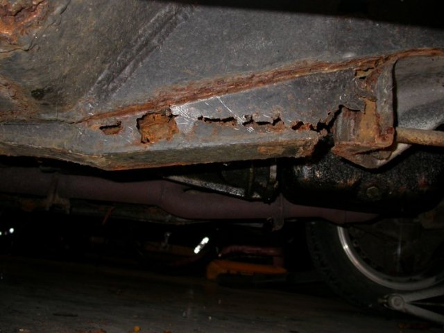

Well, I bought a 240Z without knowing exactly what I was getting into - I knew about the rust, replacing floors, etc., but Charlie Osborn tells me that one frame part that I need is not available and has to be fabbed (the part of the frame rail behind the passenger side T/C rod pocket). See the attached picture. The drivers side is OK. Anyone replaced this piece and have any advice? I've only had the car about a week, and I've gutted most of the interior so far to see what I'm up against. Hopefully it's worth it. It is a 1970 - car number 215 built in 11/69. Some more pics of the rust problems at:

Egad.... that's got to be one of the first I have seen that rusted out in that area in a while, usually it is above that where the rust takes its toll..
I'd suggest you find a shop that specializes in restoring old cars that has someone that is good at metal fabrication. To someone with the tools and skills to fabricate, this shouldn't be a hard job at all. To those of us who have a hard time forming metal, it would be a difficult job to do it right. Not only that, but that is one of the few places where I believe the 18 gauge metal was used.
It's not impossible, but you'll need to shop around and take a look at the metal fabrication the shop does. Hmm, to someone that builds Nascar stock cars for a living, this would be a piece of cake, to us, it's a bit scary....:ermm:
It is odd that this part of the frame is one of the only parts of the frame work that is not available, but then, this is usually not on of the areas that is rusted away like this one...
Good find, if you can find a shop that can do a good job.:nervous:
I spent a couple more hours under it tonight, and that darned piece is really the only part of the frame that is bad. Floor pans aren't good, and the frames under both floor pans have been previously replaced, but they are still in good shape. The battery tray area is a little worse than I thought, but not too bad. There is also some rust-through of the passenger wheel well just over the passenger side connection of the front sway bar. The box frame there at the sway bar looks fine, though - just the wheel well piece. I've been poking and proding all I can at that area, and can't go through the frame itself.

The largest amount of water probably got into the frame rails in the first place through the section that is rusted out on yours as it has some areas that are open in the corners.
The only other ideas that I can come up with, would be to find another car that is only good for parts, and you could possibly remove the frame rail behind the T/C pocket, as 95% of the worts cars will have this piece in decent or useable condition.
If you are going to tackle restoring this car, I would suggest replacing the frame rails inside the engine compartment as well, they are readily available, and these rails usually rust away from the inside. Since you are going to be doing a major frame resto, you might as well replace them, and you'll never have to worry about them again.
The only other area of the car that has me kinda nervous is around the battery tray/firewall junction. This area will need to be done by a fabricator as well, as there are no patch panels available.
I'd look for shops that are into the antique car restoration business, as they usually have to fabricate a lot of body parts for the cars they are working on as panels aren't available. You could possibly end up spending 2-3K just on this job alone, due to all the labor involved.:disappoin But, this car is going to appreciate much faster than say a 72 or 73 due to the simple fact it has a 69 build date, so the expense should be justified IMO.

Since I don't weld (yet), I don't think I'd even attempt to repair a frame. Maybe sheet metal, but not something as important as the frame. Thus, the search for a restoration professional in the area begins...
The battery tray area will actually probably not be too hard. Most of the difficult curved areas were replaced 12 years ago, and they look solid still. The two rusted areas right now are in areas that are on fairly flat panels, so fabrication shouldn't be too hard. It looks like the work that was done previously was pretty good, and very little of it has rusted again. The rust now is in areas that are original sheet metal that wasn't replaced before.
