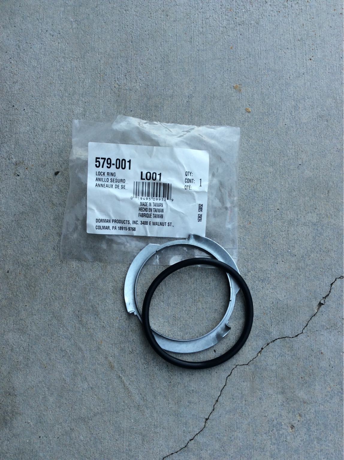

Going 30 minutes out to buy a gasket and ring for it. Since there isn't one here. Do I have to drop the tank to replace?
Sent from my iPad using Classic Zcar Club mobile
if you mean the fuel level sending unit, yes they can cause leaks. if you are lucky its just the O ring, if you are unlucky its the thru post themselves. I assume you removed it while working on sealing the tank.  Start by putting on a NEW ring, may as well buy a NEW lock ring as well, they are cheap. You need to make sure the sending unit is oriented properly for the gauge to work right. Take your time to make sure you have the O ring in correct and try to tighten the lock ring evenly, tap on all three prongs so it goes on concentric.

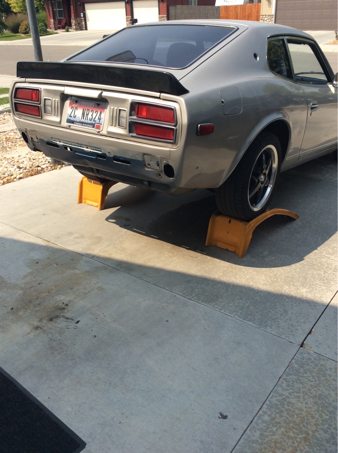

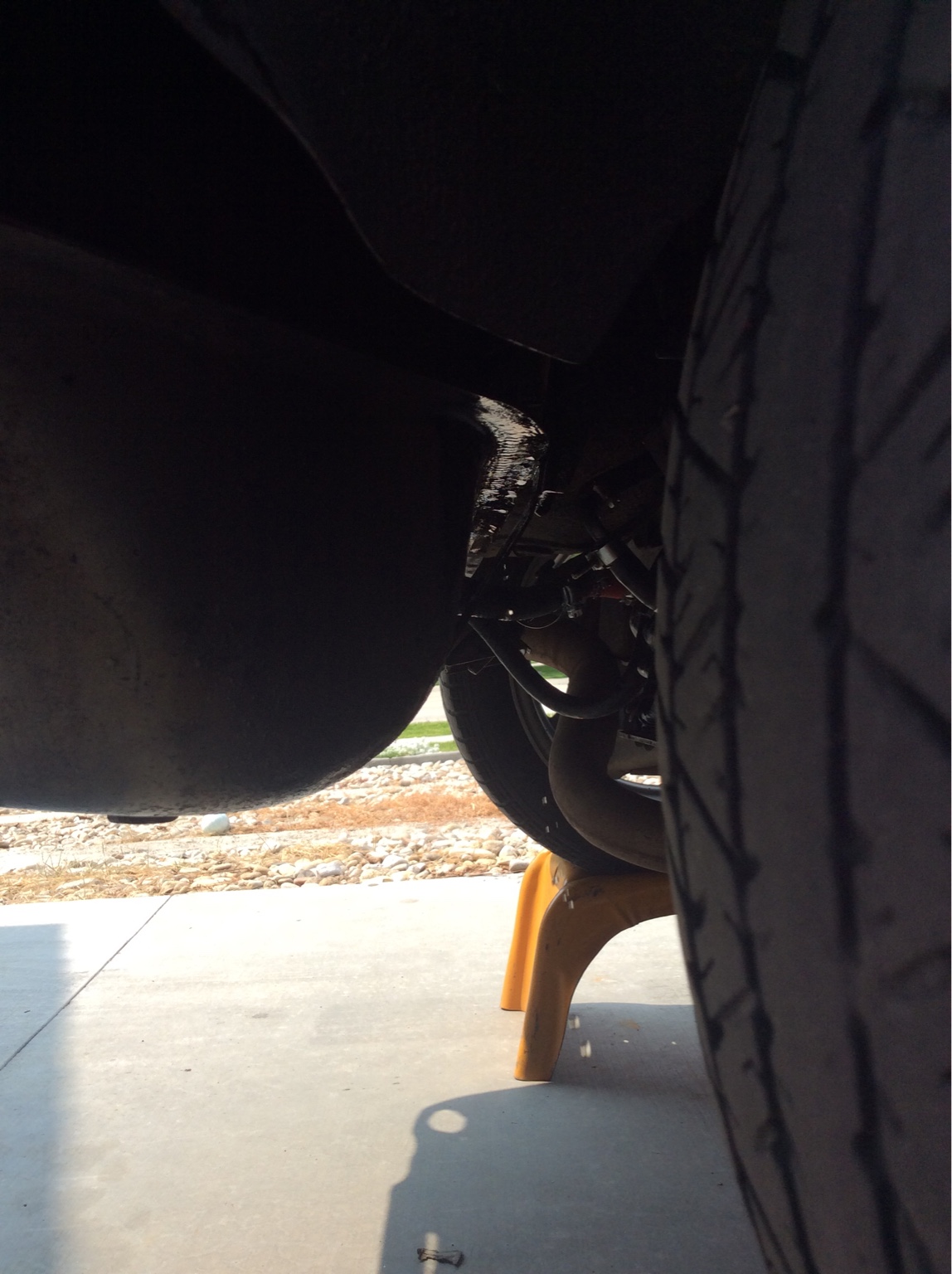

No you do not. you should jack up the car and remove the rear wheel passenger side to get better access. Always use a lot of care when the car is on jacks both from a personally safety stand point (of course) and not to damage the underside of the car. I remove the tire and put it under the frame rail as a backup in case the jack were to fail. I actually use the tire under the frame rail, a jack stand on the diff mount cross member AND leave the floor jack under the diff just enough to keep it snug. that way I have 3 points to keep the car up.
Edited by Dave WM
only need to get it below the sending unit. so if its actively leaking you will need to take it down until it stops. prob 3 or so gallons off full should do it. having it tilting forward will make it more likely to leak. you could just loosen the ring and see what happens, if it starts to leak tighten back up and drain some more.

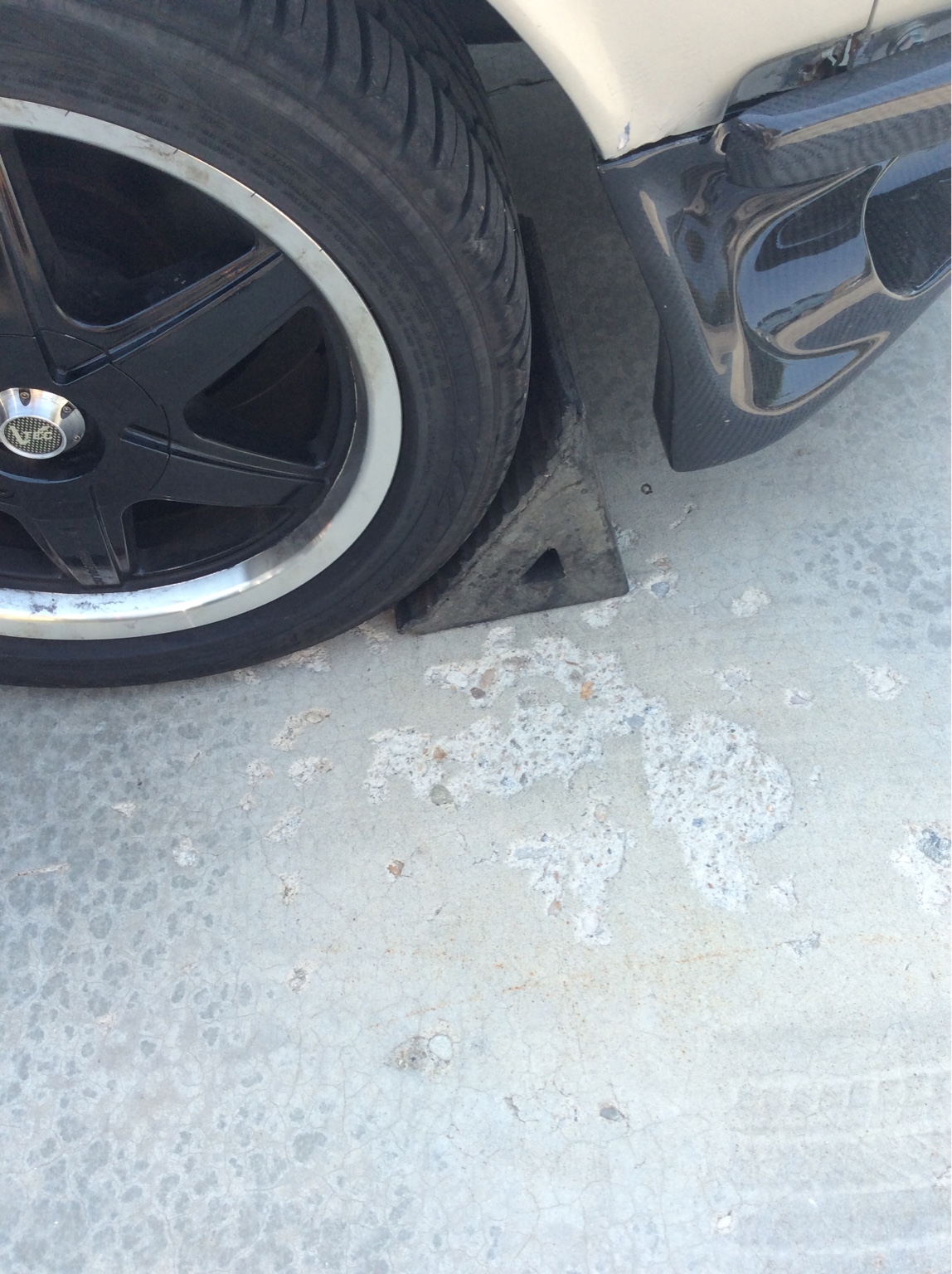

the chocks are a good idea, but what you want to prevent is the ramps from collapsing.
