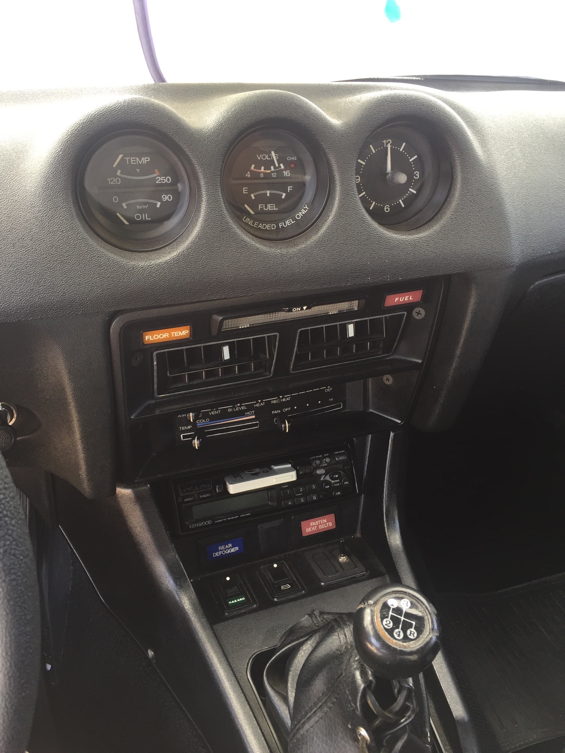

My oil gauge is never correct, it always sits a little over 0. My gas is never right as well it sits a quarter bellow full when I fill her up

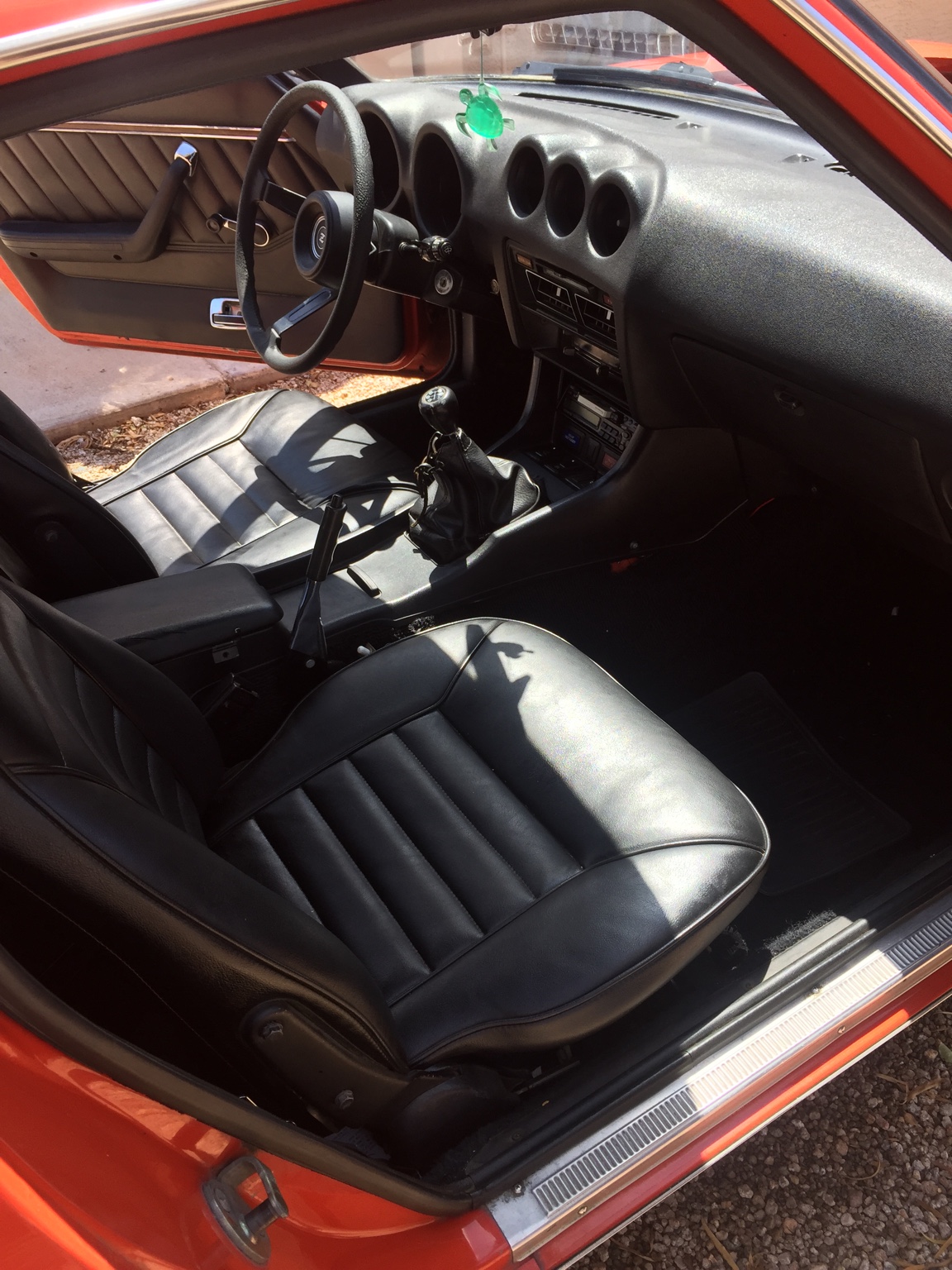

Your car looks really nice and original. There's some cheap things to do right off the bat that'll help. NGK plug wires and copper plugs. A Fram G-3 clear plastic fuel filter in between the fuel tank and the fuel pump. I can get better details in the morning when I get out my laptop. It has all my bookmarks and this phone doesn't. Also probably need to install a new $10 fuel filter in the engine bay. Check all the rubber vacuum lines for splits or cracks. Clean all the grounding points. Adjust the valves and so on. Easy stuff to do and cheap. I noticed a 4 speed shift knob, whats the build date plate say on the driver's side door panel above the locking/latch mechanism?  Mine was built in 09/76 and has a five speed. Read as much as you can, you'll learn a lot quick. Google "'77 280Z classiczcars.com" to get more threads than you can read. 8^)
First thing I did when I got the car is changed all the oils. I put copper spark plugs. I will try that oil and do the stuff you said. My car was built in 7/77
