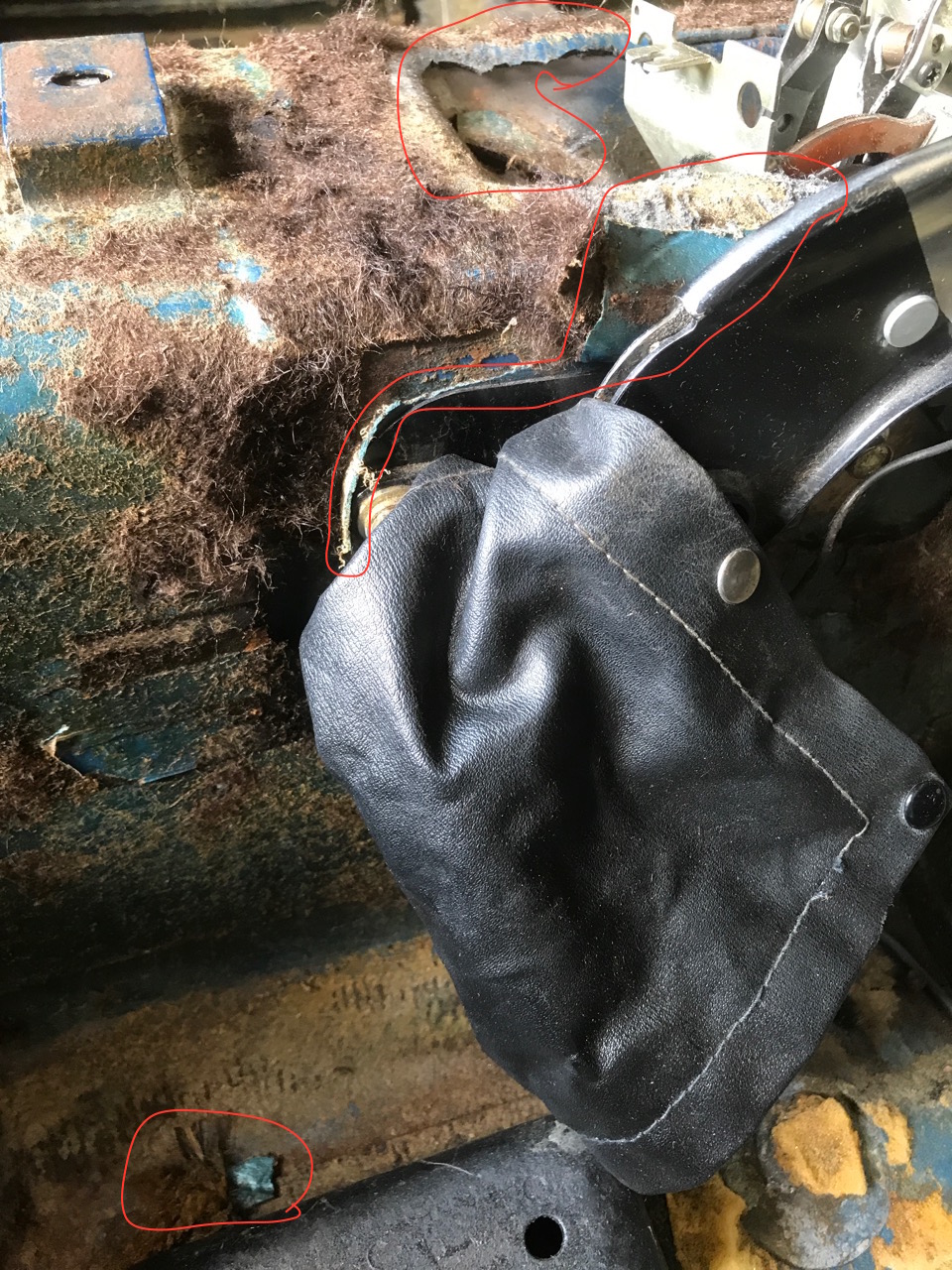

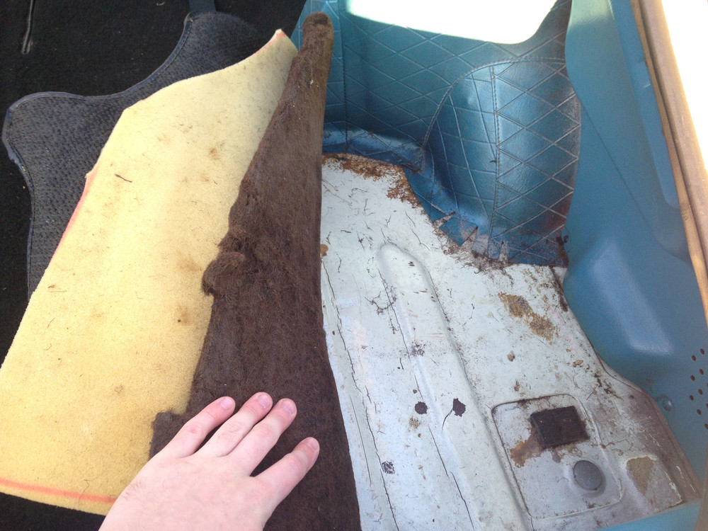

  1. What did the original tunnel insulation look like? I see it in the line drawings, but what was it? On this car, I see a kind of tar-like layer over the metal, then some brown hairy stuff that reminds me of buffalo hide, then vinyl (almost all removed), then carpet. What is that brown hairy stuff, and is it original?
  2. The panels in this car are black. The current vinyl (only in place in the rear deck) is black. But in removing the old carpet, I found blue vinyl underneath the brown shag in numerous places. mostly just little circles of it, like they cut around it when they removed the shag to put in the black carpet. You can see it especially in the hand brake mechanism, which appears to sit on a bit patch of it. I really can't tell... does that mean this car would have been blue/blue when purchased? If so, in 1970, would the interior panels also have been blue? Or did the blue panels only show up later?

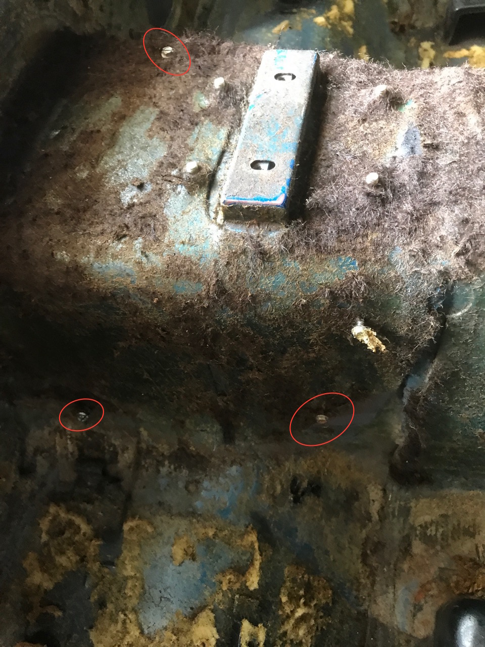

  3. Something like 20 screws were used to hold the shag carpet down. I have removed them all, but that leaves little holes everywhere. This car is very unlikely to ever see a wet road as long as I own it... But do I need to do something about those holes? Fill them?

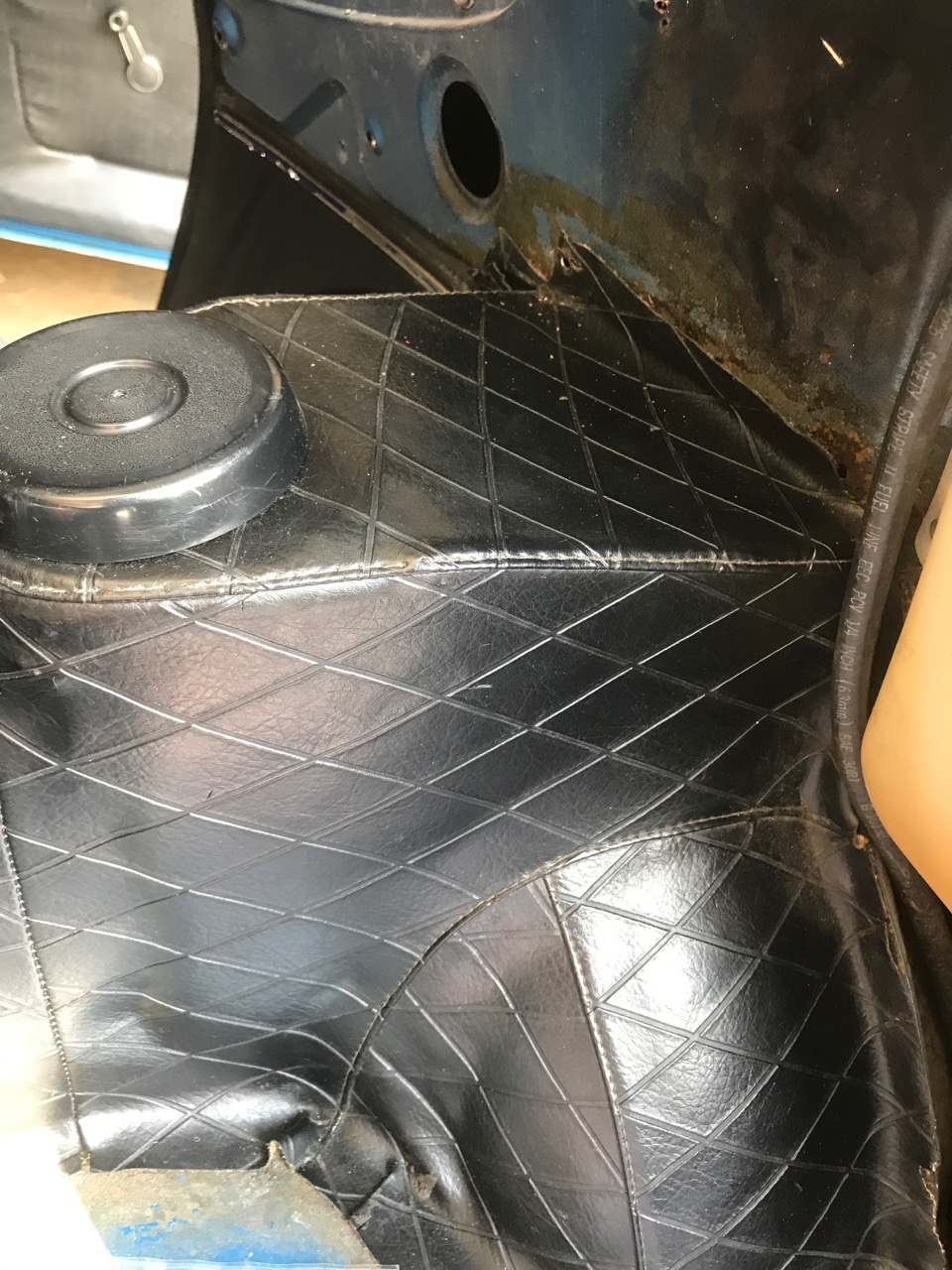

  4. Is there any way to tell if vinyl is original or replacement? Trying to figure out if the Vinyl in back came with the car or not.

Brown buffalo looking stuff is called "Jute" it is the original padding and is still available from some places.
I would say the piece of blue vinyl behind the parking brake is the original vinyl.
The best way to seal all the little holes would be welding them shut but unless you really strip the car down pretty far (which I don't recommend) you have a risk of starting a fire (don't ask how I know). Probably the best and easiest thing to do would be to use a little silicone (RTV) sealant and close them up
Ah, so the hairy stuff is the famous jute. I've looked around on the web, I can't find anyone selling something that looks like that. Same name, jute, but seems lighter and not really "natural fiber" like from what I can see. It's too bad the carpet had been glued to it, when I removed it, it removed about half the jute on the tunnel. Of course, the jute had been long gone other places already. Hmm. Would be nice to go with something that at least looked original.
If the tarry stuff under the jute is the original Nissan sound deadener/anti-vibration layer, I think I'll just leave it as is.
From some photos I found on the web (see from BAT 1970 240Z auction #1), it looks to me like the jute for the rear deck, and passenger/driver floor pans was not glue down at all. Just laying there, and carpet laying on it loose as well. Is that right?
I don't know what I'm going to install, but if I could avoid glueing the whole thing down, that would be my choice. Just so the next person doesn't have to scrape it all off. Tunnel will need glue though I think. tar>pad>vinyl.
Sorry to hear about the fire! thanks for the advice. I'll try the RTV thing. There's a little whole in the driver pan, near where your left foot would go. I'll take a pic of that and ask if I need to do something more. It's very small, but all the way through.
Weird about the blue vinyl. Could the dealer have installed the shag carpet before even selling the car, as a markup? I went through all the records again last night, and I can "see" the main exterior restoration, and the main interior restoration. But nothing that jumps out at me as the shag carpet.
