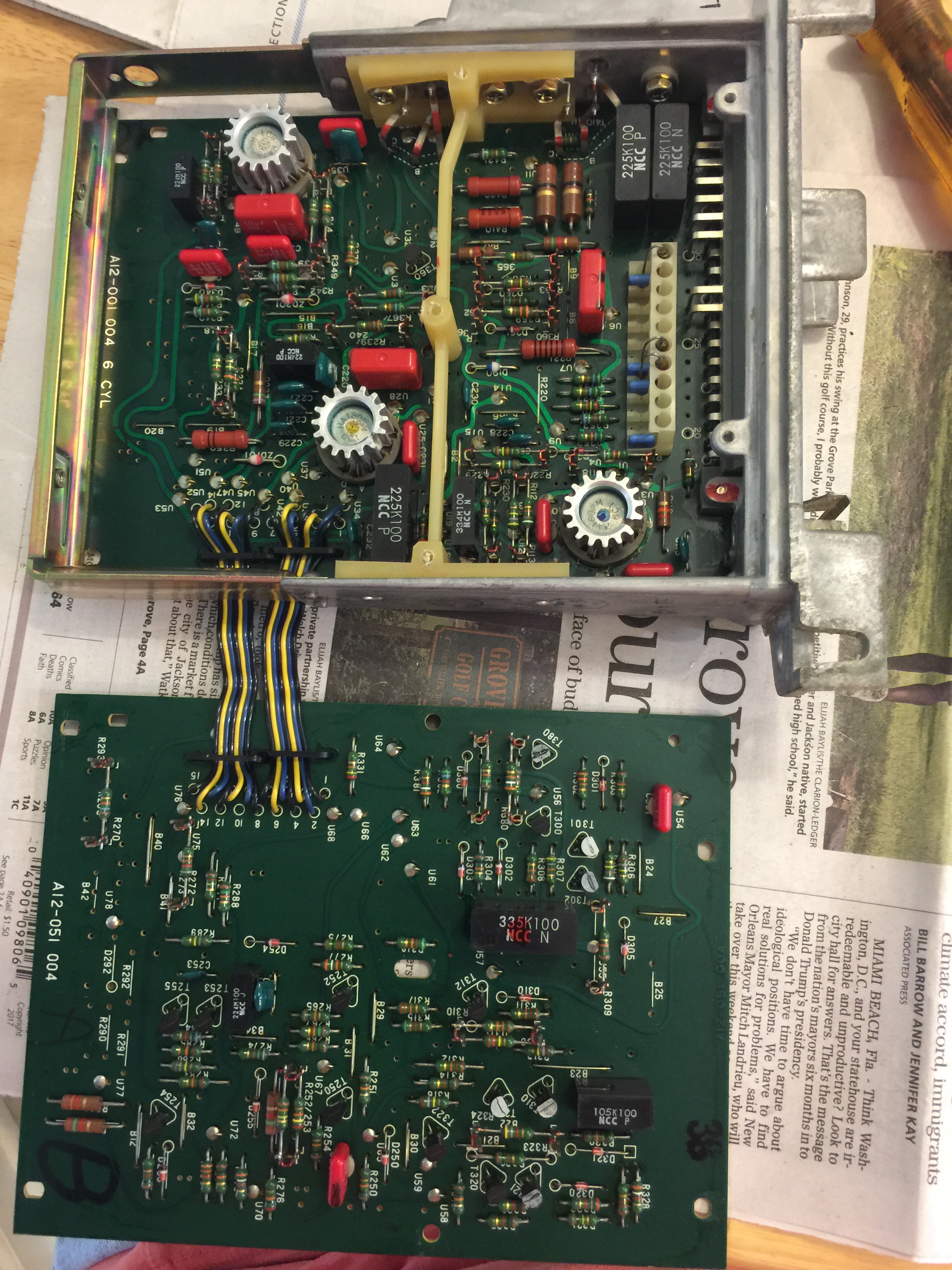

Ok some evaluation ad testing going on today.

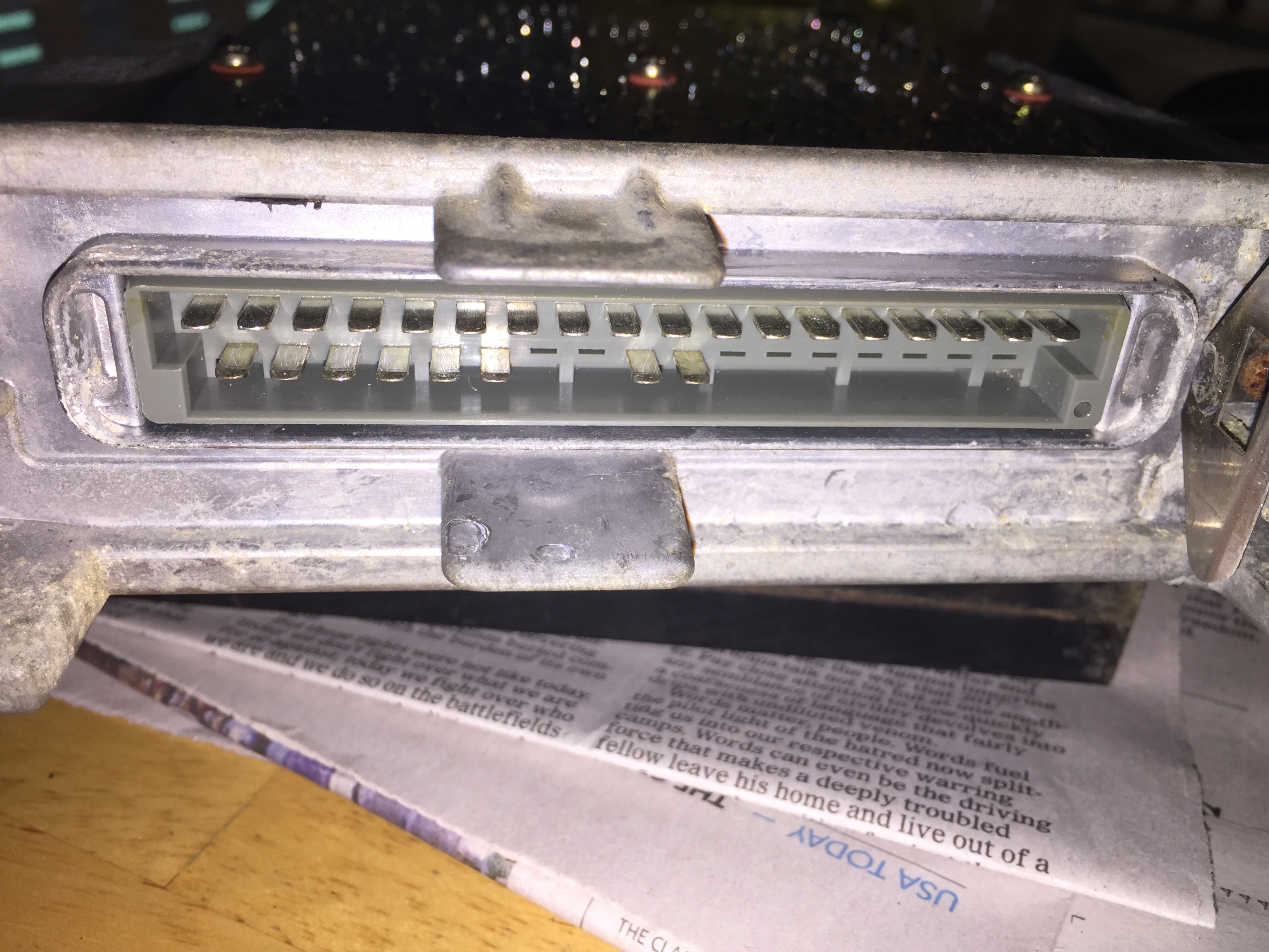

So far we have opened up the ECU and cleaned connections.  Went ahead and opened the whole thing up to see if anything was burned up.  All looked good. Photos attached for those that like photos....

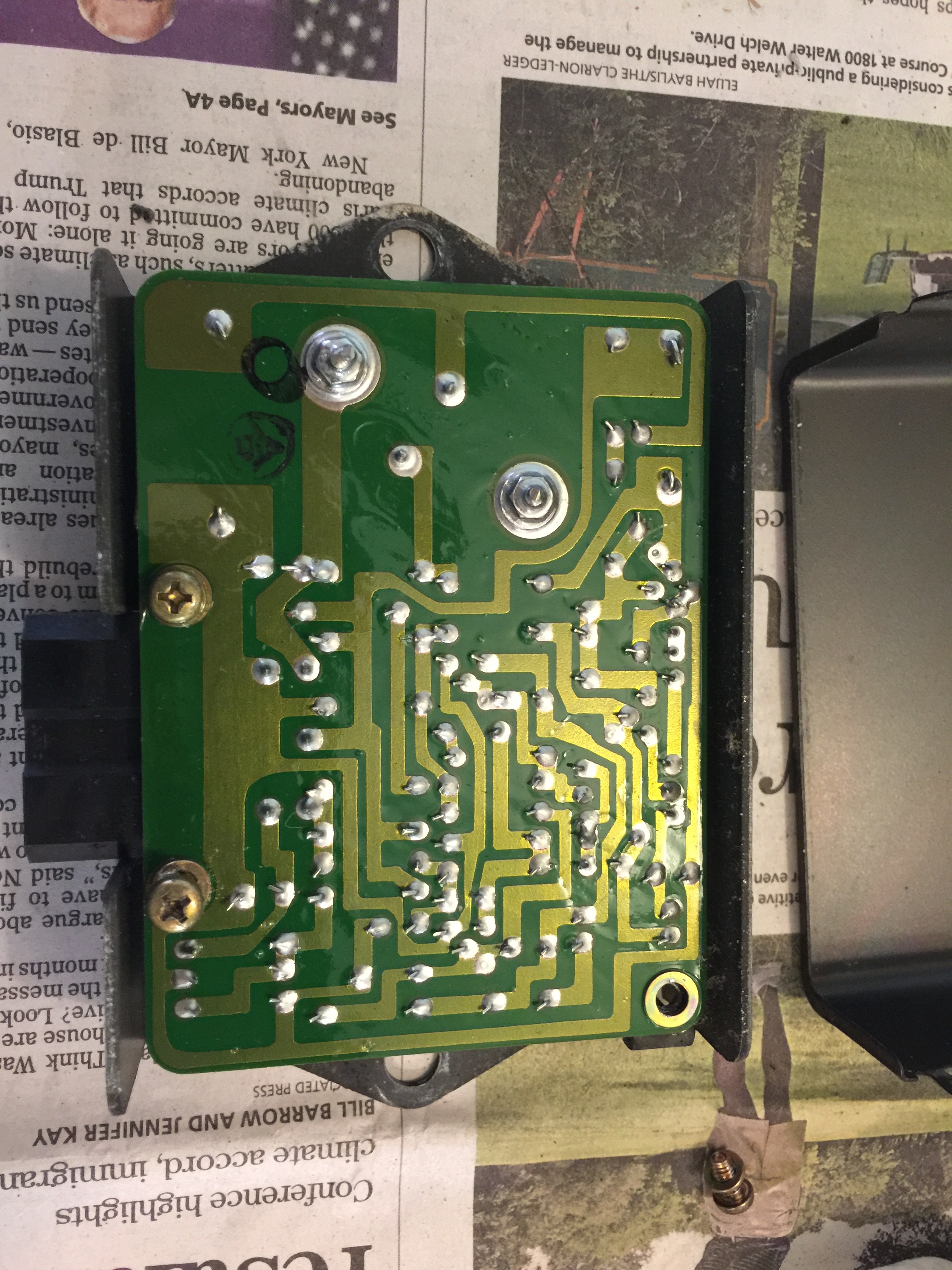

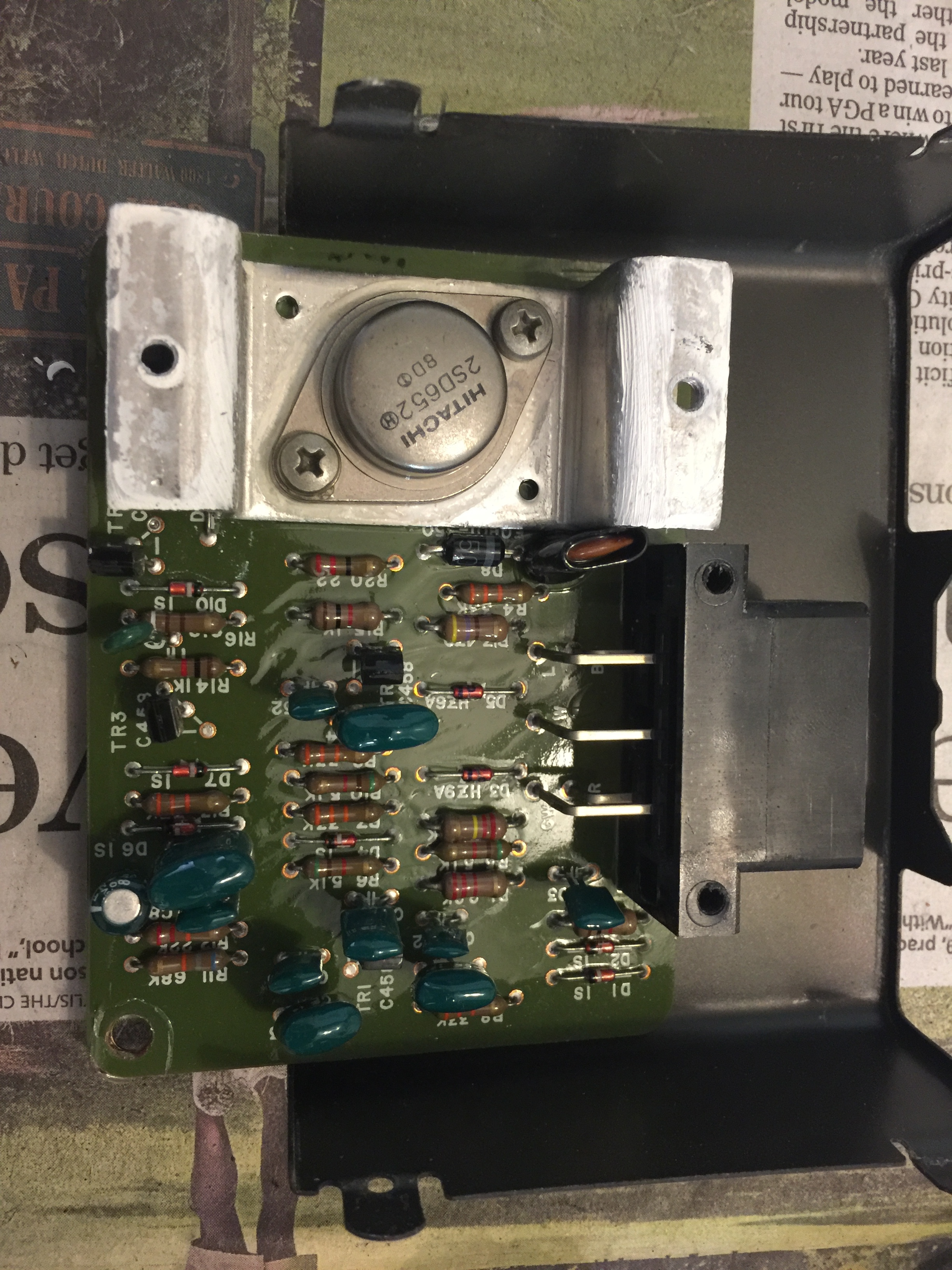

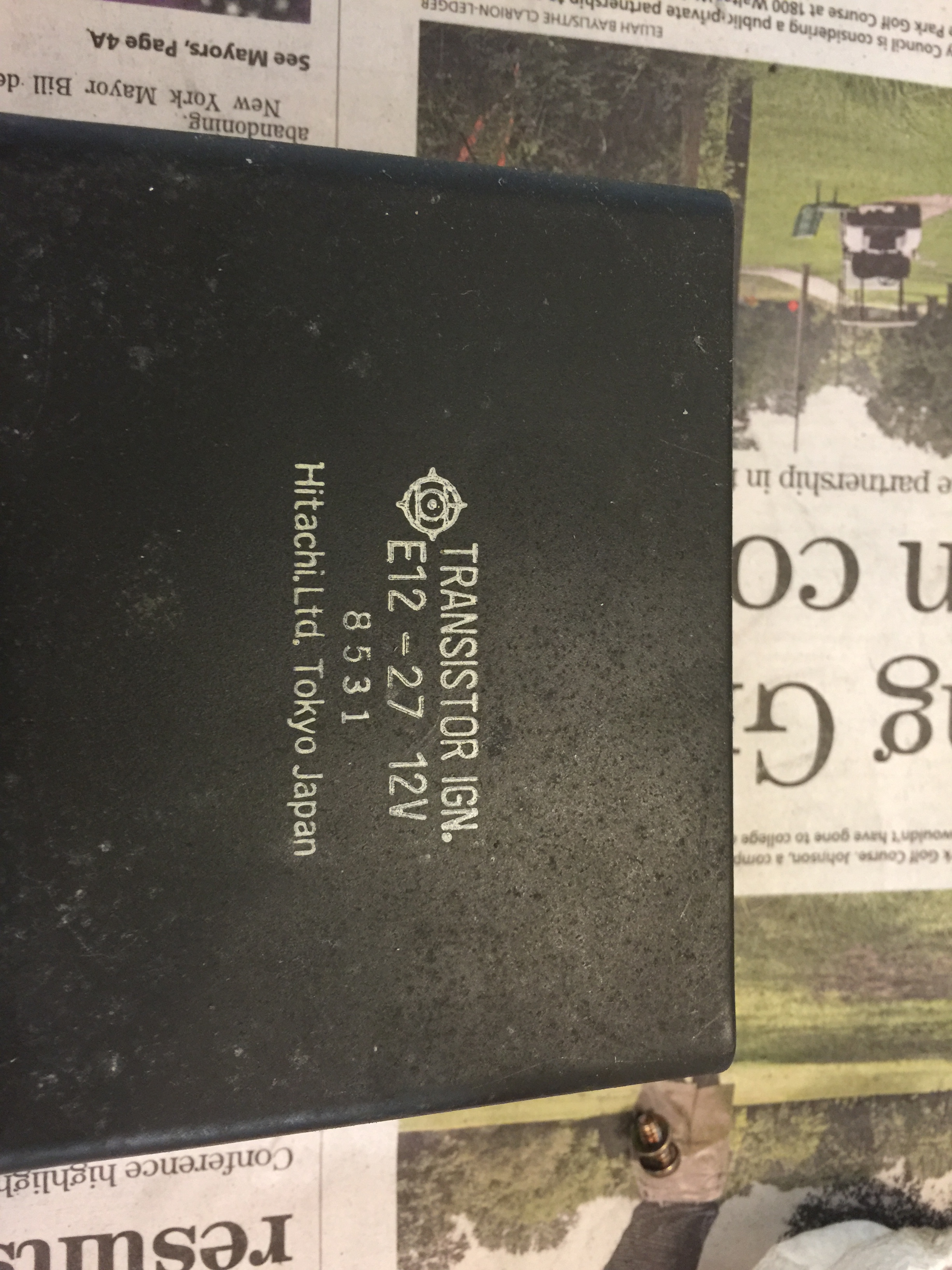

. Also opened up the Ignition Module on the passenger side by the fuse box.  cleaned connections there as well and went ahead and opened it up to check things out.  I have read they cannot be repaired but was curious to see what was going on.  Nothing burned up in there either.

That's the way to do it.  But keep your eyes open for a cheap ECU.  Most of us out here have a spare or two because the old electronics generally seem to be drying out and dying.  Ignition modules and ECU's.  I had a bad ECU myself and it was supposed to be a spare.  A few others have had bad ECU's over the years.  And they tend to flood out as part of the dying process.
How do you identify a "good" ECU? I have see rebuilt ones on Motorsports site. Is there a way to refurbish one?
