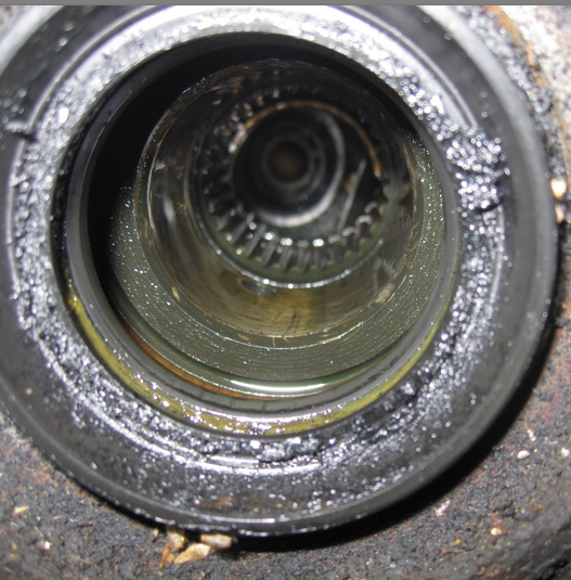

June 24, 20178 yr Author comment_523878 Ok. Well you can see in the.picture there are 3 grooves on the smooth area. I am putting the clip on the 3rd groove. Then you see the spline, but no groove in the splined area. Could my diff be the one that needs the clips on the axles, but I have the wrong axles? I see no groove for the clip in the spline area, which seems to be the problem as to why it I can't get the clip on. Link to comment https://www.classiczcars.com/forums/topic/57868-help-on-cv-half-shaft-on-r200-from-300zx-turbo/?&page=2#findComment-523878 Share on other sites More sharing options...

June 24, 20178 yr Author comment_523885 Thanks. That will help me some. To be honest I tried to measure inside the diff and I cant get a clear view. It also does not look like the 3rd groove I was putting the clip on matches to the axle. Again, the fact that I see no groove in the spline area is concerning. My diff just has a 392 casted on it. I know it has more numbers on top but I can't see them unless I drop the diff Link to comment https://www.classiczcars.com/forums/topic/57868-help-on-cv-half-shaft-on-r200-from-300zx-turbo/?&page=2#findComment-523885 Share on other sites More sharing options...

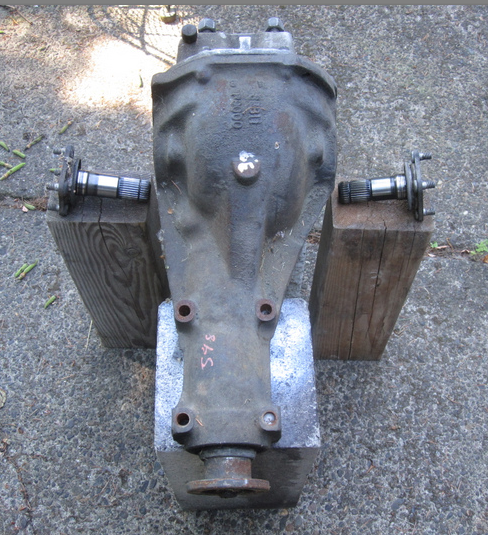

June 24, 20178 yr comment_523886 I got some pictures, which I'll add to the next post. But, in looking at your diff I wonder if it's not an R180 that's made for bolt in half-shafts. Those holes might be threaded and made for bolts. Link to comment https://www.classiczcars.com/forums/topic/57868-help-on-cv-half-shaft-on-r200-from-300zx-turbo/?&page=2#findComment-523886 Share on other sites More sharing options...
June 24, 20178 yr comment_523887 Not the greatest picture but you can see the clip hanging in the grove, and that there is only about 1/8 to 1/4" of splne after the groove. And no holes n the center piece. Also a good picture of an R200. Take a picture of the back of your diff and post it. Link to comment https://www.classiczcars.com/forums/topic/57868-help-on-cv-half-shaft-on-r200-from-300zx-turbo/?&page=2#findComment-523887 Share on other sites More sharing options...
