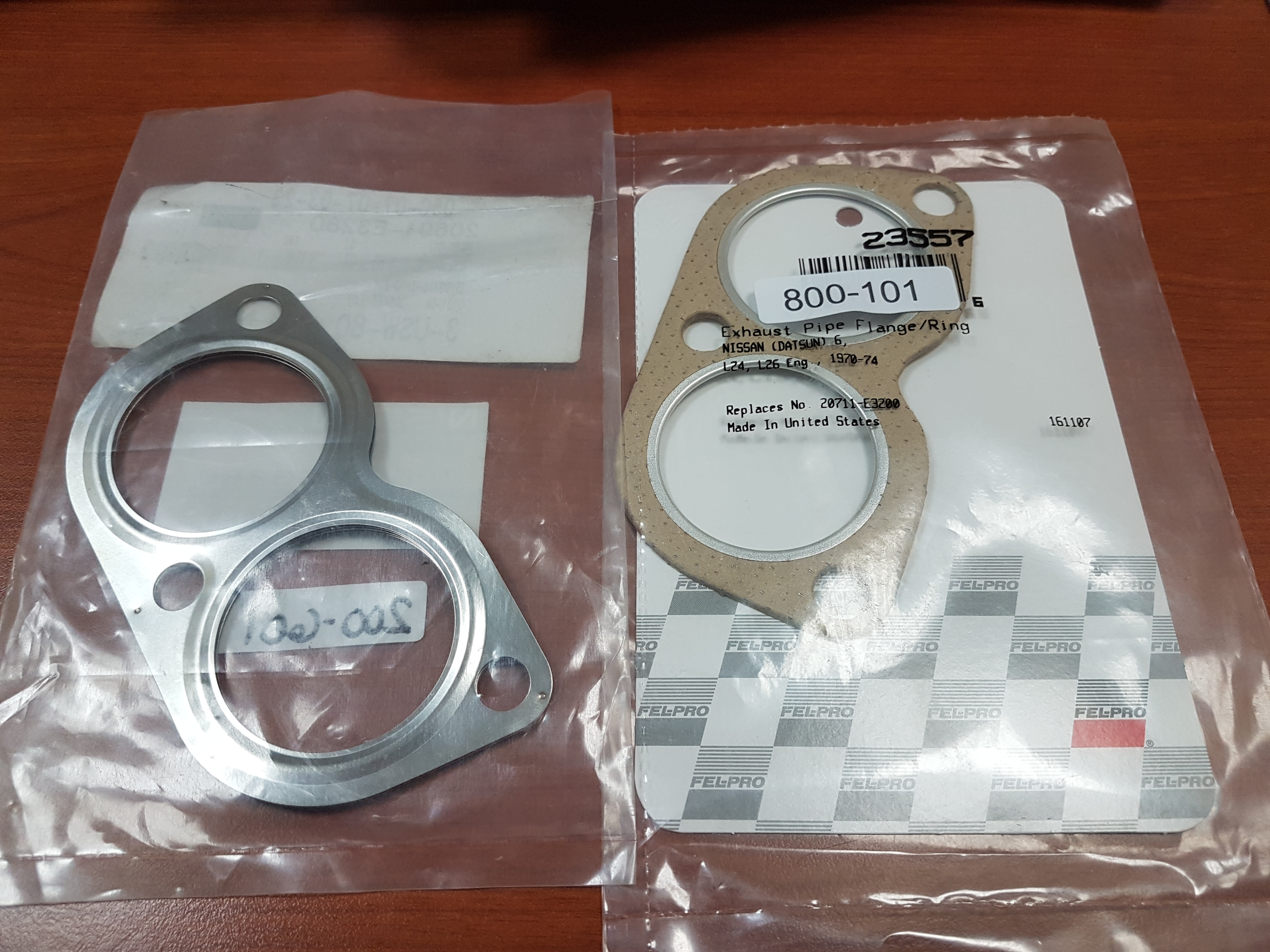

May 11, 20178 yr Author comment_520690 On 04/28/2017 at 9:30 AM, Jarvo2 said: The air galley is the device that the smog pump pushes fresh air into the exhaust manifold with. Most of them are leaking or damaged by now. Well i found out yesterday while taking the car to a muffler shop and placing a garden hose in the manifold to downpipe área, there was a some hiss present (exhaust leak). Luckily i just received a pair of manifold to downpipe gaskets and would like you advice on which one to use and what steps to acomplish to seal this área properly i.e. clean both surfaces, the manifold entry and the downpipe, place the gasket and drop some permatex ultra copper sealant to seal it more tight? the Permatex mufller & Tailpipe sealer advertises to withstand 2000 °F. I forgot to mention that the shop that installed the MSA PREMIUM EXHAUST system, couldnt remove the nuts with the corresponding wrench and hence had to use the soldering gun to heat the manifold área in order to remove the stock downpipe. Edited May 11, 20178 yr by jalexquijano Link to comment https://www.classiczcars.com/forums/topic/57338-replacing-exhaust-system-on-my-72-240z-from-the-manifold-to-the-back/?&page=5#findComment-520690 Share on other sites More sharing options...
May 11, 20178 yr comment_520694 I have a stock exhaust manifold that I had ceramic coated and I have used the metal gasket in your photos for years with good success. My stock down pipe extended above the flange and fits into the manifold. Make sure these aren't broken. I have always retighted the three bolts after heat cycled the motor several times Good luck Ps never needed the gasket maker Don's iPhone using Classic Zcar Club mobile Link to comment https://www.classiczcars.com/forums/topic/57338-replacing-exhaust-system-on-my-72-240z-from-the-manifold-to-the-back/?&page=5#findComment-520694 Share on other sites More sharing options...
May 11, 20178 yr Author comment_520720 3 hours ago, 7tooZ said: I have a stock exhaust manifold that I had ceramic coated and I have used the metal gasket in your photos for years with good success. My stock down pipe extended above the flange and fits into the manifold. Make sure these aren't broken. I have always retighted the three bolts after heat cycled the motor several times Good luck Ps never needed the gasket maker Don's iPhone using Classic Zcar Club mobile the studs or the bolts? which ones should not be broken? Asides from installing the metal nissan gasket which of the aformentioned permatex sealants should i use? Edited May 11, 20178 yr by jalexquijano Link to comment https://www.classiczcars.com/forums/topic/57338-replacing-exhaust-system-on-my-72-240z-from-the-manifold-to-the-back/?&page=5#findComment-520720 Share on other sites More sharing options...
