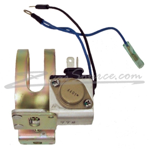

Sounds like the ignitor (transistor) on the coil is going bad I thought that was a symptom of a bad ignitor when it would get hot. Google bad 280zx turbo ignitor symptoms.
