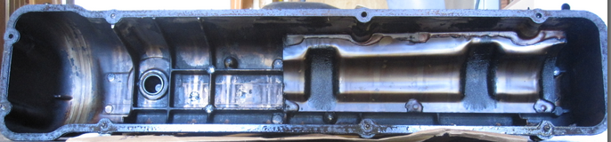

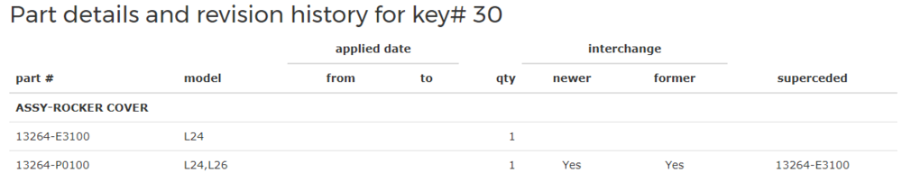

Here's an 81.  It looks just like a 78 that I also have.  carpartsmanual shows a change in the L24 engines but doesn't give a year.
Sorry to get the thread all oily.  It's just a spare engine.

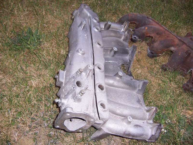

* As a side note, there's even a threaded hole (plugged with an allen headed plug) in the intake manifold down between the runners for cylinders 3 and 4. It connects into the shared internal passageway for the EGR system. It's almost as if Nissan had considered exactly what I'm suggesting.
From this old thread  http://www.classiczcars.com/topic/22366-efi-progress-on-my-datsun-240k/  here's a couple pics of the integral EGR passageway built into the intake manifold. This one is webbed (which mine is not), but the concept and location of the passageway is the same. He's removing the EGR passageway completely to clean up the look of his intake manifold:
In this pic, you can see the flat boss cast passageway between 3 and 4. The boss was never drilled and plugged like the earlier ones were though. But the boss still exists:

It wouldn't be as clean and neat on the inside but a person could run a tube to the area of the exit port under (above) the baffle then run the tube to wherever they wanted the new exit to be, inside the cover.  You'd have the same design that was originally engineered, except for the volume that the tube occupies.  If the multiple bends in the baffle have a function it would be maintained.

Just in case it wasn't just me having troubles... What Zed Head is suggesting is that it would be possible to cut a hole in the stock baffle plate and then connect a tube to that new hole. Then you could also cut a hole in the valve cover anywhere you want, and bring the other end of the new tube out that hole. The end result would be a stock baffle performance, but you could relocate the exit hole anywhere on the valve cover surface.
Assuming there's room inside to run said tube without it interfering with the camshaft or valve train.

When I look at that stamped piece of steel, that only covers half of the length of the cover I think that some engineer somewhere (probably at Nissan Motor Corp.) must have put some time and effort in to it.  Can we really just throw it all away?  Save some of it.
Is there a purpose to those bends and that shape?
Yes, I believe the shape of the baffle with the bends has a purpose. It's intended to seal the baffle around the entire perimeter except for the very back corner where it's open. Presumably, the designers thought there would be the least amount of oil spray flinging around back there.
Then the bumps and valleys in the middle (in conjunction with the cast ribs on the inside of the valve cover) force that air to swim a crude labyrinth (up and down) in an attempt to separate the liquid from the vapor. Up over the baffle bulge, down under the cast rib. Twice. Before finally getting to the hole at the very highest top part of the valve cover where gravity should also help keep liquid inside while allowing vapor to pass.
I wasn't there when they designed it, but that's my read.
