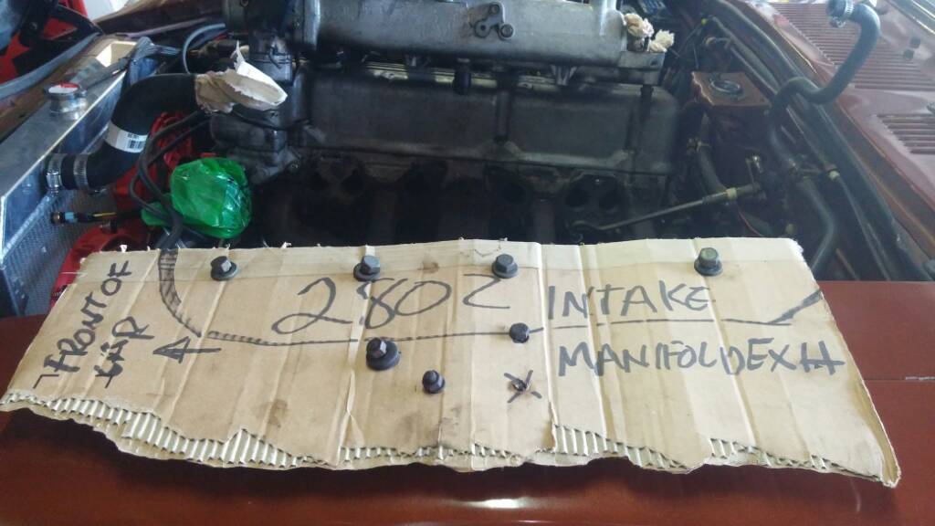

I make cardboard templates like these when I remove bolts from projects. keeps them in a reference pattern for reinstall. because we know bolt sizes are different for each location

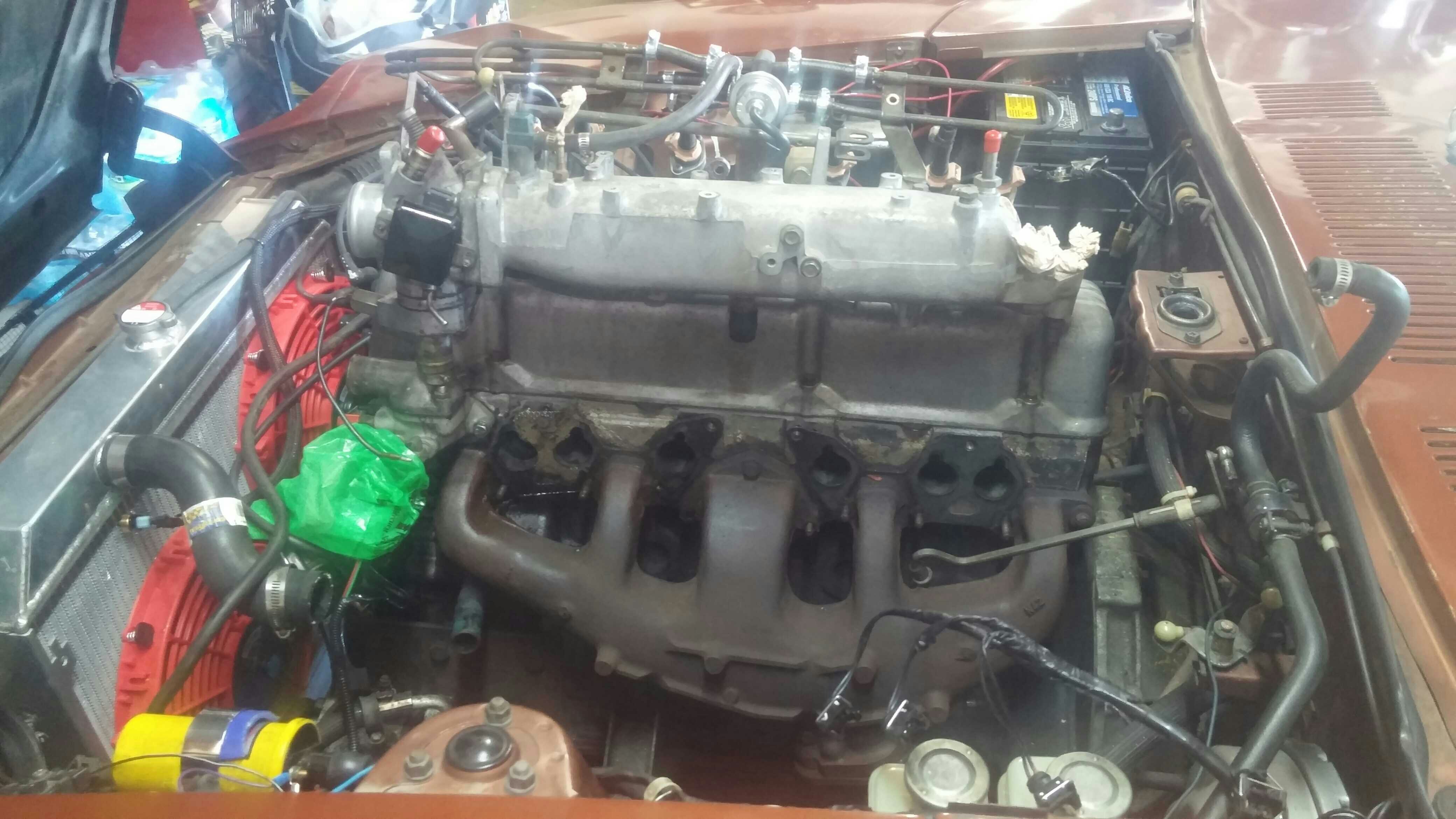

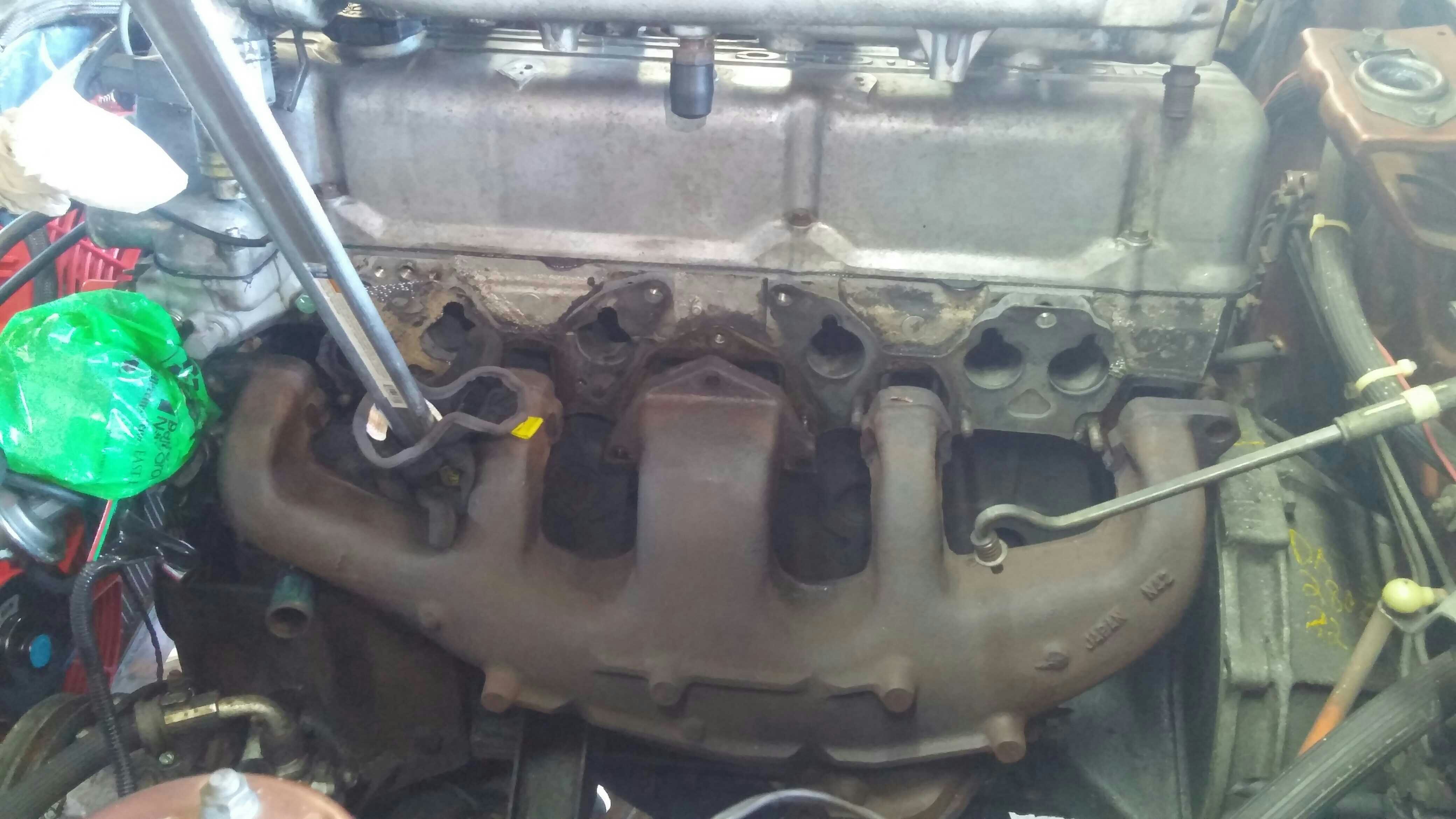

1480793378998.thumb.jpeg.6451b15e795b63c easy pry with bar and a few taps with rubber mallet releases the exhaust manifold from the block.
Sent from my LG-D850 using Classic Zcar Club mobile

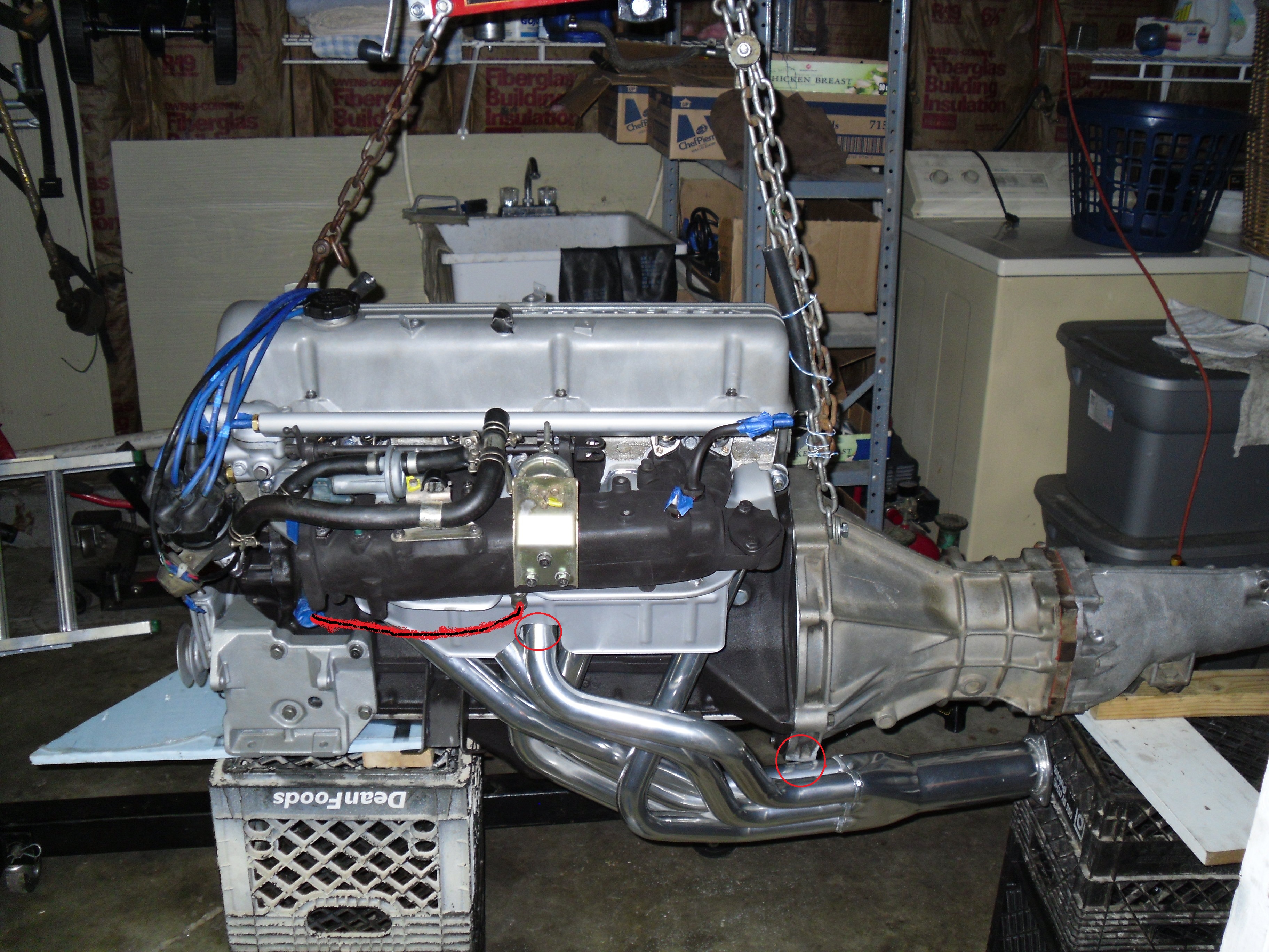

In my picture you'll see the shield notch and another place I forgot to mention, where the header touches the bell housing.  Your's may not rub but mine did and I had to slightly grind the bell house to keep the header from touching.  You need to run the shields or it'll melt your PCV hose, red with black marking on my picture.
