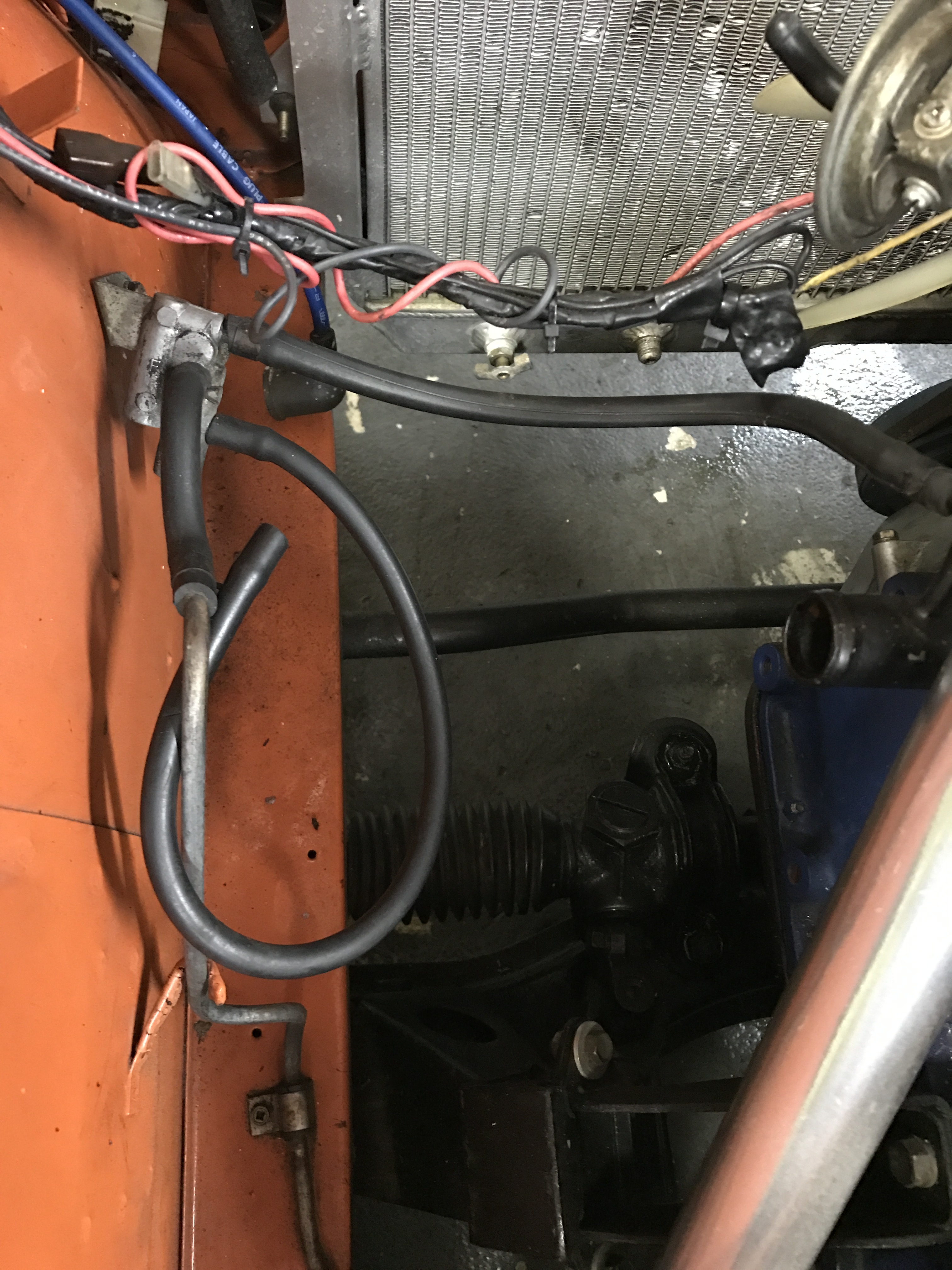

My question is about the other vacuum line that went to the back of my airbox with the SU's. It gots from the airbox down to the small junction box under the dizzy.
What do I do with this line now as there is no port for it to go to now? Do I cap it at the junction box? What have you guys done with it? I can't find any images or info by searching.
Can you take a picture and post? Only thing I can think of down there is the Evap system flow guide valve. It should have two small hoses. One goes to the Crankcase breather tube coming out of the block.  The small nipple can be capped off at the Crank breather tube, and you can toss the rest of the parts..

Yes, I'm talking about the other hose coming off of #57 there that goes up to the back of the air filter box.  What do I do with that one? Cap it? It normally "breathes" through the air box.
I can keep the one going to to the crankcase breather tube, right? I'm going to run a K&N filter on the tube itself.
