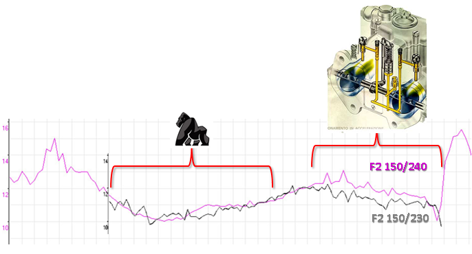

What is troubling is the 3 point range of the WOT runs that we can not remove with E tube change or accelerator circuit.  The Venturi size or  ratio of venturi to throat (or fuel level) could be part of this seemingly untunable undesirable curve. It needs to be explored further.
FYI It looks like the accelerator pump circuit removal leaned the top end out  ~ 1 point.  The big dip at the first 1/3 of the WOT run is the gorilla in the room.  Hopefully fuel level lowering can remove it.

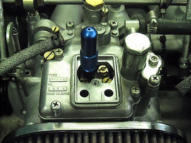

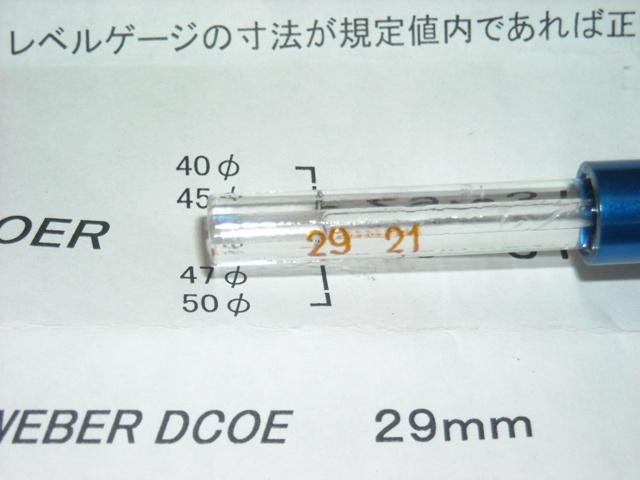

What is the proper way to measure the fuel level? Remove the main jet assembly and put something down there to mark it?
(dip stick)

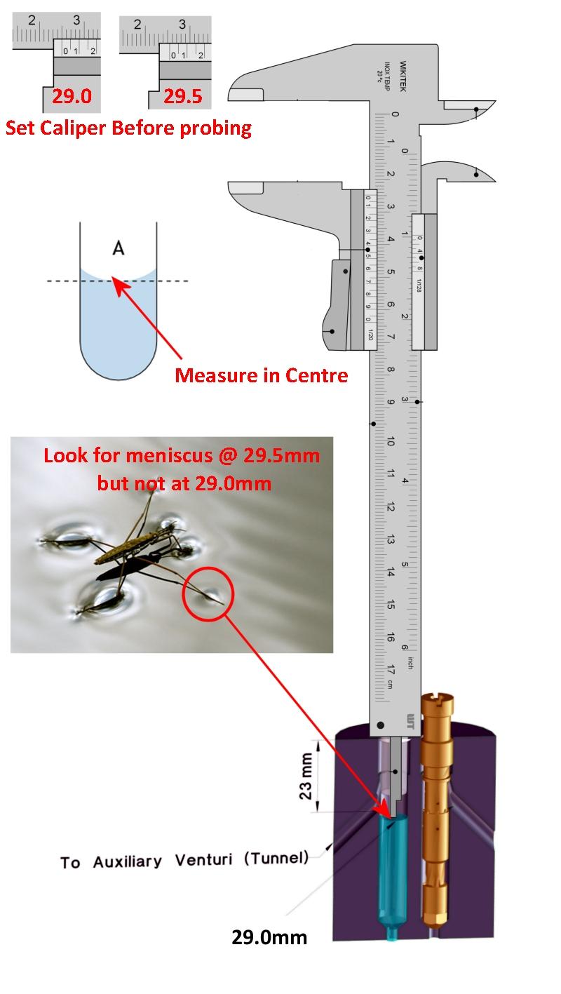

Or you can stick a wire tie down the main jet tube to the bottom then mark where the top of the bridge is and measure from it to the wet point.
Edited by 240260280
Fuel level is at ~31mm measured with caliper.  I pulled the jets then turned on the pump for a couple seconds to make up for the lack of volume of the jets.
Good data. This may be why the WOT run is not flat for all Etubes.   Could you please raise the fuel to 27mm down and leave the existing parts in. It will enrich all circuits so be aware.
It  would be good to see what it does to the WOT shape before dialing back the fuel jets. Hopefully the shape will change.
