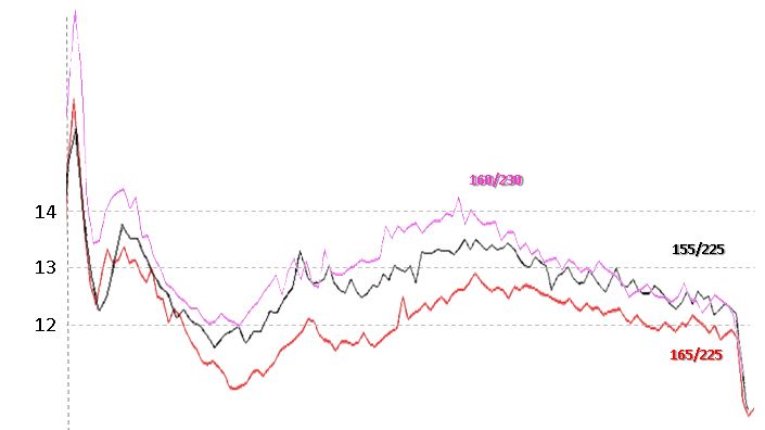

Got a new SD card and finally dry weather. Took a log this morning and I'll take another on the way home. Just watching it though, it looks to be pretty lean. So...might be headed back to the 155/225 combo for a baseline before E Tube experimentation.

160/230....
36982419611_c8328d1e32_o.jpg9-8-17 by blodi, on Flickr
Go back to 155/225? Or maybe leave the 160 in and go 160/225?

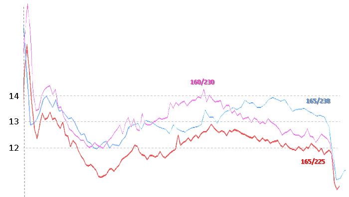

Very strange.  The middle hump raised.  No flattening occurred,   Try the 165 to add more fuel.
Maybe a free-air recalibration is needed too.
