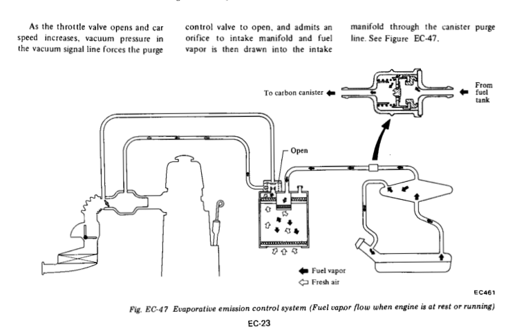

This is on my 76 with stock EFI. When I remove the gas cap I get a rush of gas fumes coming out. How can I test my vapor canister? I did put a new filter on the bottom. Do vapor canisters go bad (eg, the charcoal inside)? I do have a new fuel pressure regulator on it and a new fuel pump.  My newer vehicles don't build pressure or vacuum in the gas tank. Can someone explain how the vapor system works on these cars?
Thanks
Gary
It's described in the Emissions chapter.  Basically the tank is vented through a line with a check valve to the carbon canister.  The check valve is lightly spring-loaded so there could be a slight pressure build under normal conditions.  If the tank cools and a vacuum is created the cap has a vent to let air in.  You can remove the line from the tank at the carbon canister and suck on it.  Remove the gas cap to let air through easily.  There could be a clog in the vent line anywhere from the back to the front.
Thanks Zed, I found the diagram in my SM also. Could it also be the purge control valve on my canister?
The purge control valve just controls when the line to the intake manifold opens up.  The line from your tank is supposed to be open to the charcoal all of the time.  The charcoal absorbs the vapors until the engine is running and can suck fresh air through it, pulling the vapors in to the engine.
I would imagine that there are a few areas that could get clogged.  You can pull the vent line from the tank and blow in to the canister to see if it's clogged.
