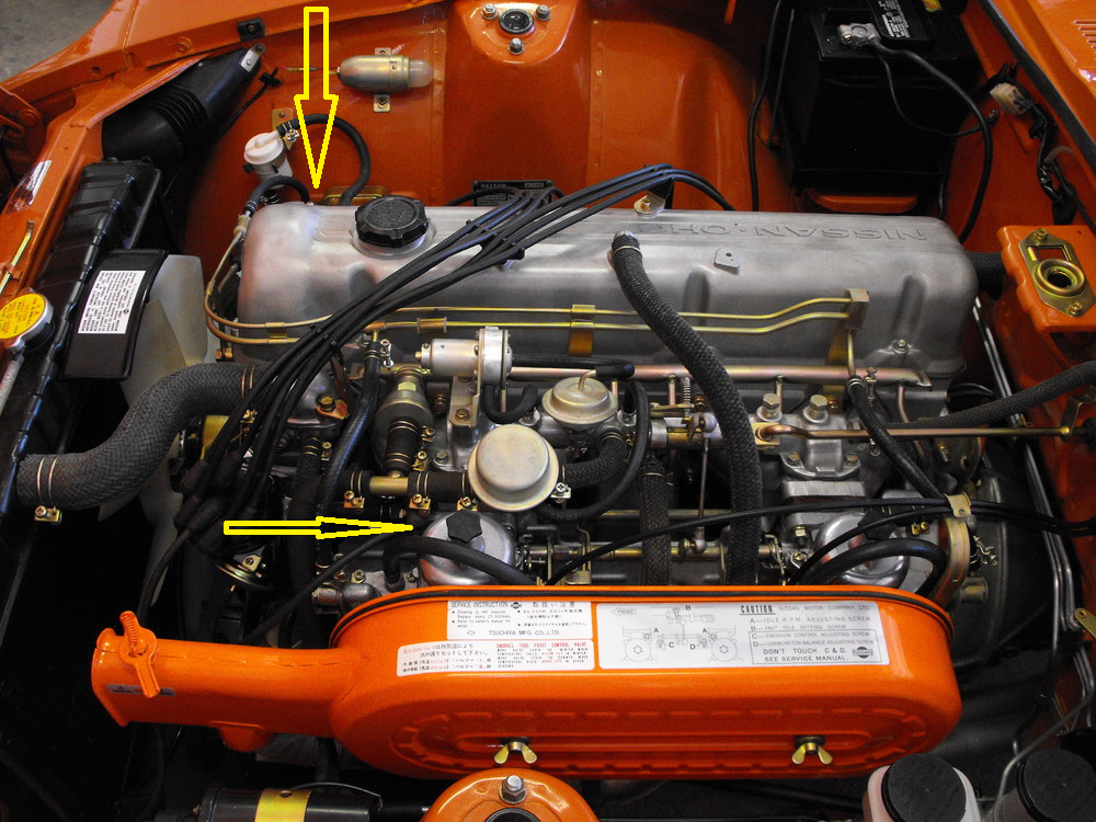

Mechanical pump mounted above the first carburetor? Could you post a photo of that? Normally the mechanical fuel pump is mounted on the right side of the engine toward the front so it is actuated by the cam.
There could be an electric fuel pump mounted by the tank. As part of the effort to relieve the vapor lock issues with the 73, Nissan had a factory authorized modification to add an electric fuel pump. If that pump failed, a PO could have replaced it with another electric fuel pump. If it is there, it will be on the front of the fuel tank on the right side.
I borrowed a picture of Motorman's fine looking car for a minute.
The fuel pump should be on the passenger's side of the valve cover where the arrow is.  The vacuum hose off the front carb to the distributor is the other yellow arrow.  If that's not connected or plugged off, your front carb will be leaner than the rear.
