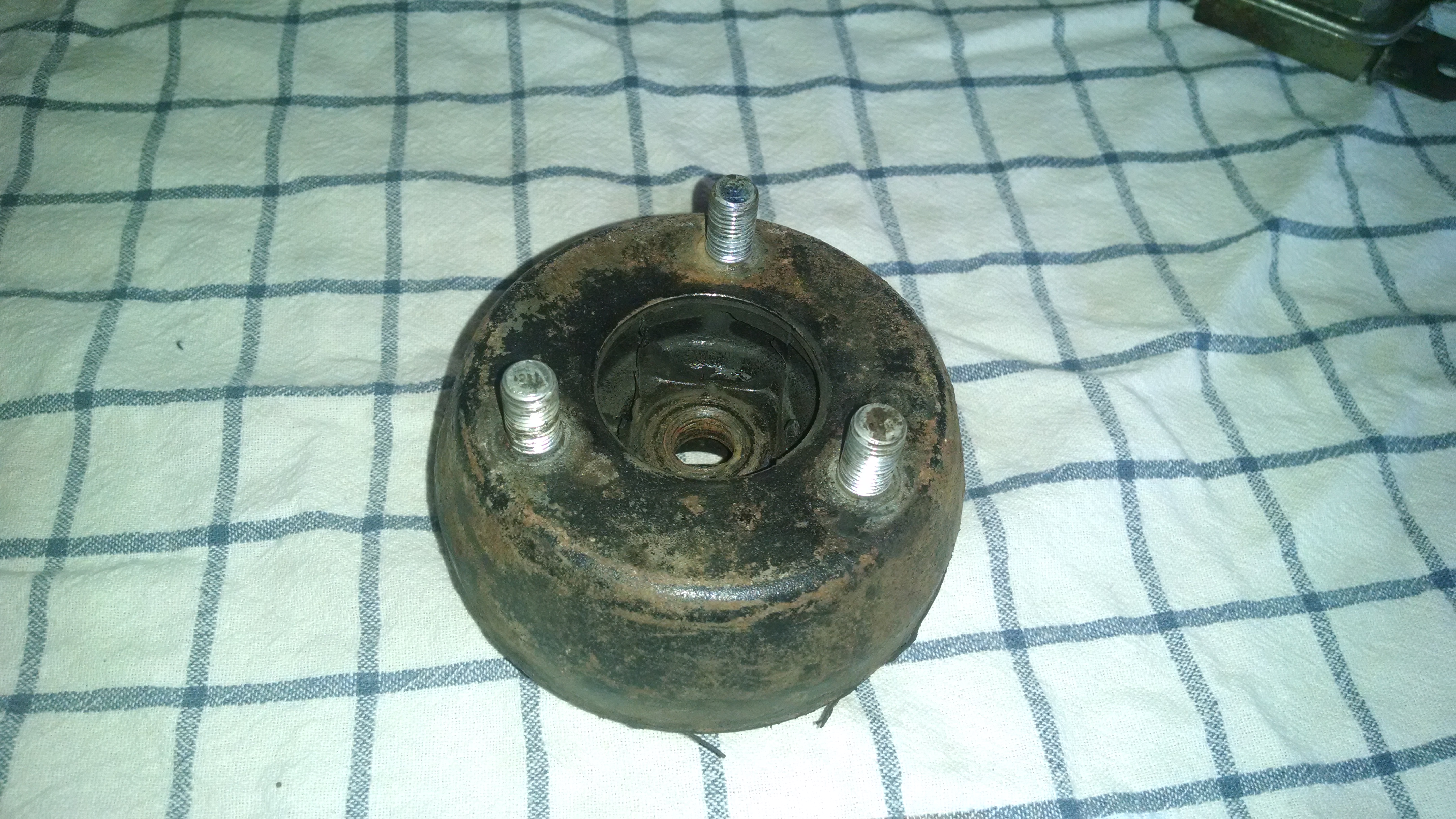

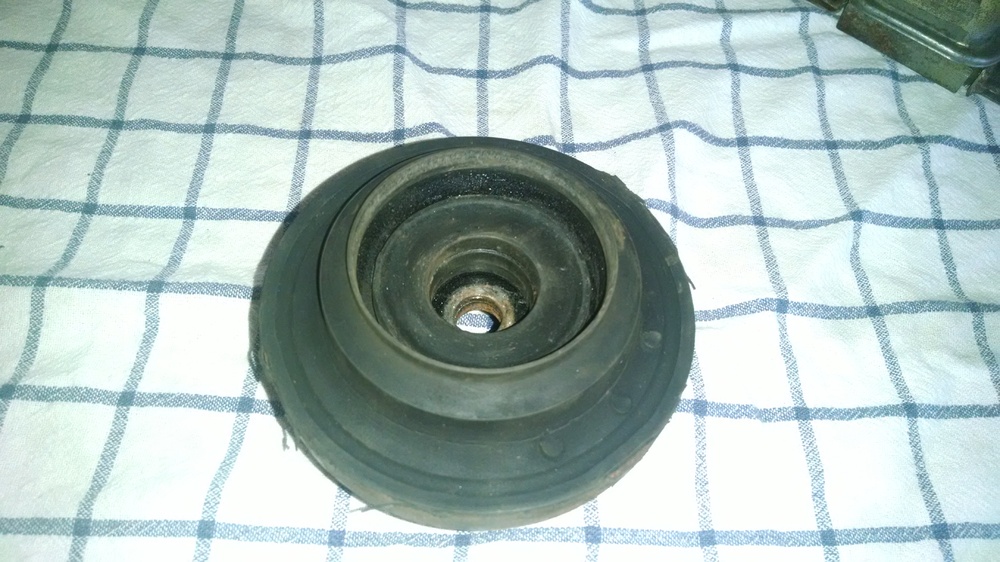

Trying to determine if I should replace my strut isolators, so here is a look at one. The rubber on the bottom is still flexible and compliant.  The top surface where it bolts to the car is basically stiff without any rubberish feel there. Not sure if it ever had any. No surface that currently has rubber seems to be in bad shape.
Guy at work who is a very experienced mechanic and spent many years with Z's when he was younger said absolutely no need to replace them. They are totally fine.  I tend to default to his judgement as he is truly a sharp guy, but in case there was supposed to be a bit of damping on the top surface I figured I would see what you guys thought.
Would be nice to save that $50 a corner or so they cost from Courtesy Nissan.
Looking at the pictures online, there doesn't appear to be any damping on the top surface, just the bottom. I think I am good to stick with what I have.
Edited by DaveR
The top is a steel hat with rubber inside of that. The studs on the steel hat bolt to the body of the car. I believe the steel washer the strut bolts to is encased in the rubber inside the hat

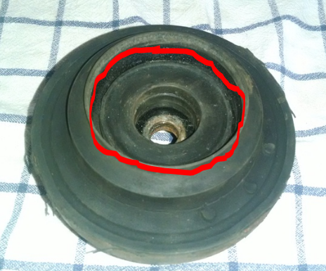

There is one small piece that can be replaced in there that will add some compliance.  Called a spacer, it sits between the spring seat and the insulator.  Still available I think, I bought some a couple of years ago.  They compress and look like one piece but they can be pried out.  It's just a rubber donut.
Zed is right, although they are rubber in the back, there are bearings there in the front I believe. Normally I just wash them and put a little grease back on them
