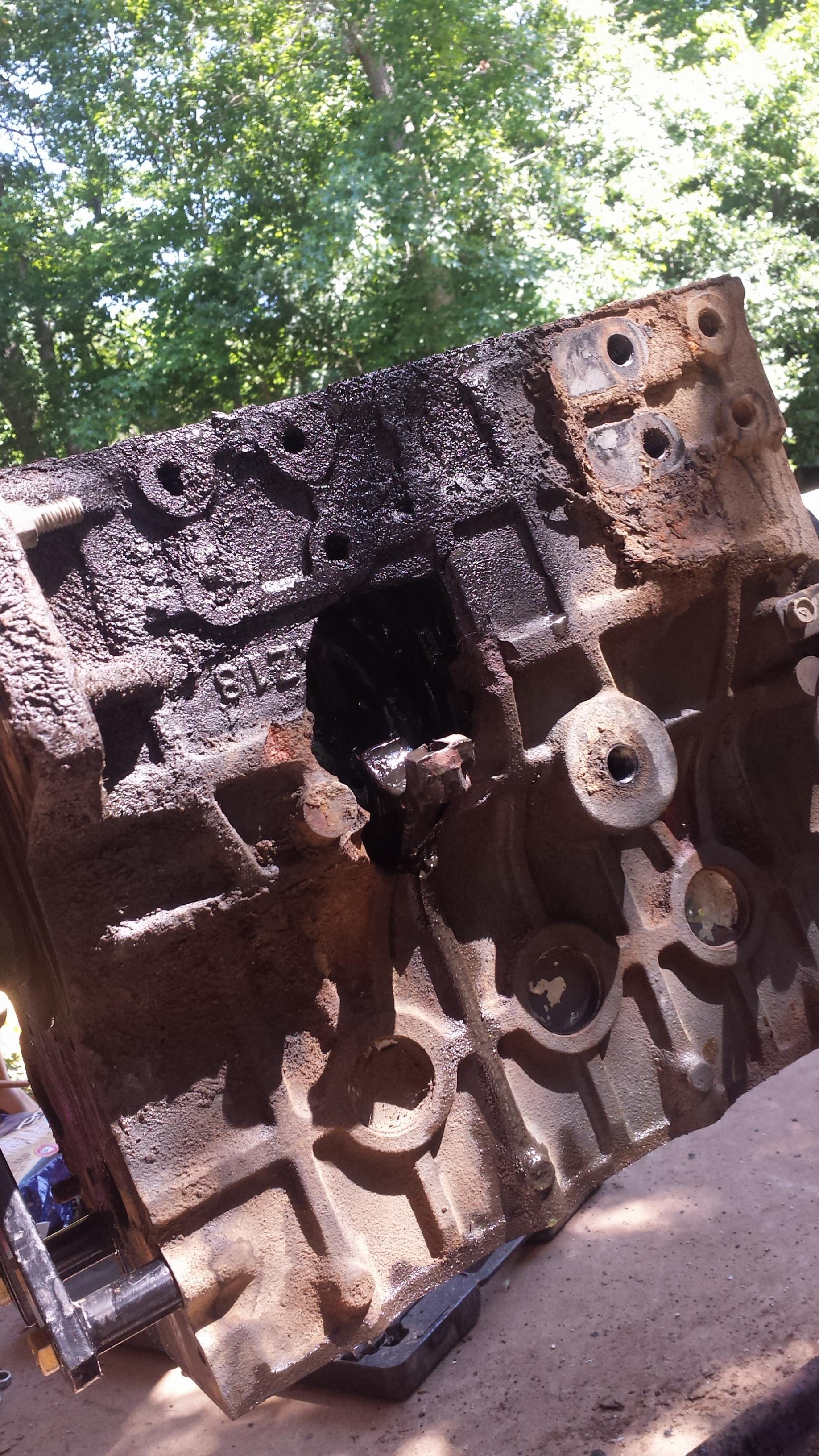

I thought I would throw this out to the smartest group of mechanics I know. I am working on a diesel 4 cylinder that is Japanese made and came out of an old New Holland skidsteer. It threw a rod and I am exploring rebuilding it but haven't ever built a diesel before. Anyone here have any experience? These get expensive quick and I don't want to go through all the motions and still not have a running engine...any advice?
That block is trash. Welding won't work because of the stress lines in the block. Also diesels run 22:1 compression so they put a lot of stress into the block. I have sourced another block, almost $1000. I was working on getting the crank out, which comes out the back of the block, which would be another $1000 if it's not salvageable...
