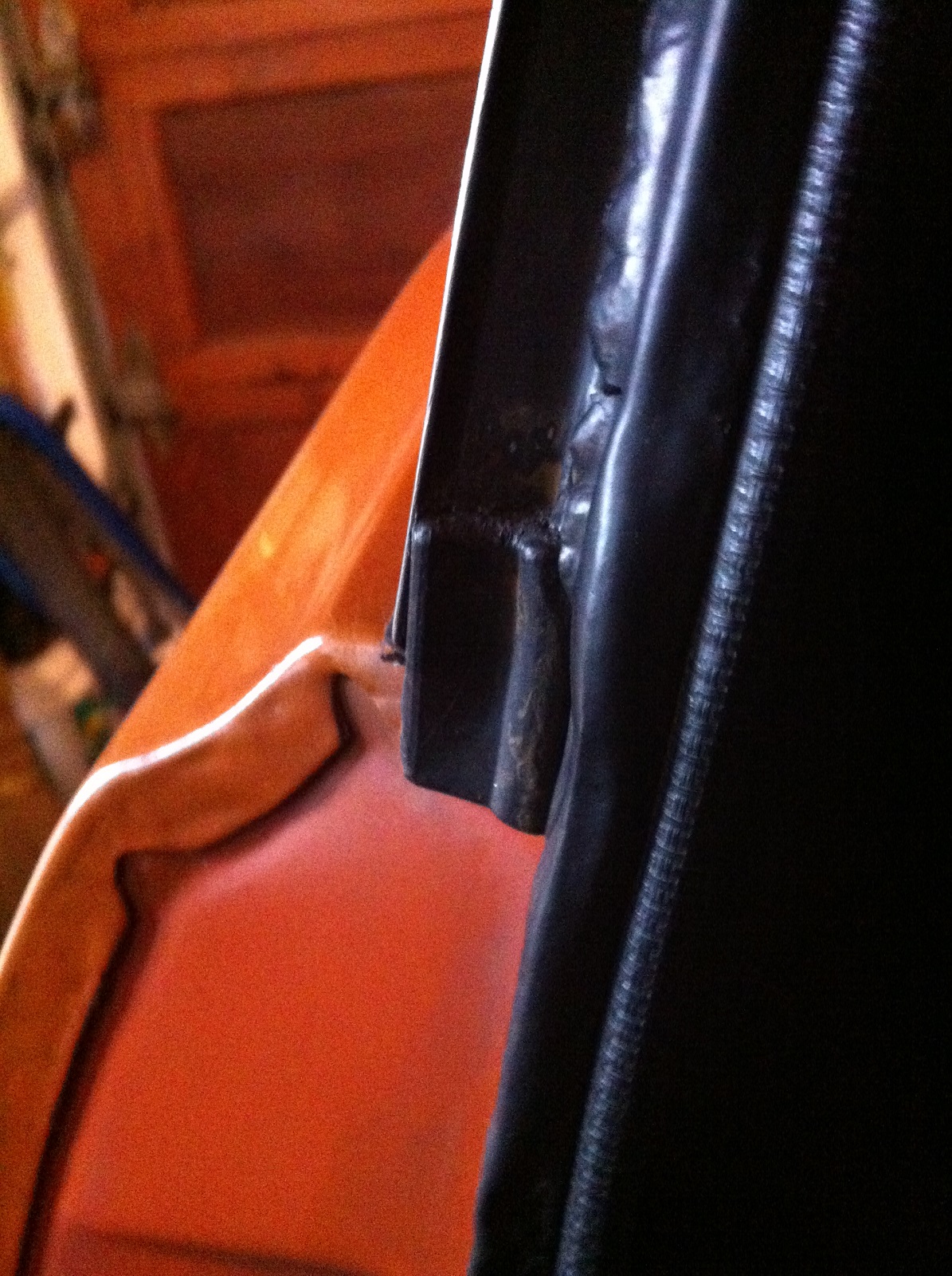

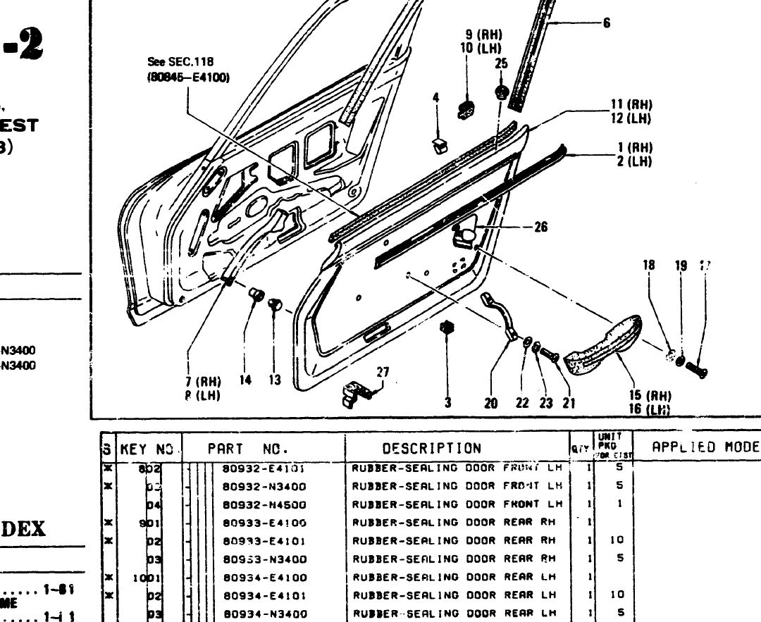

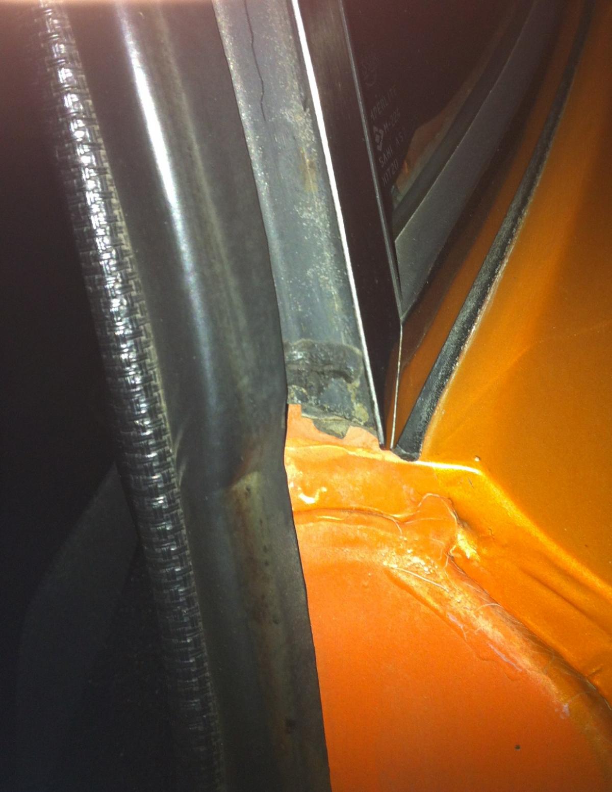

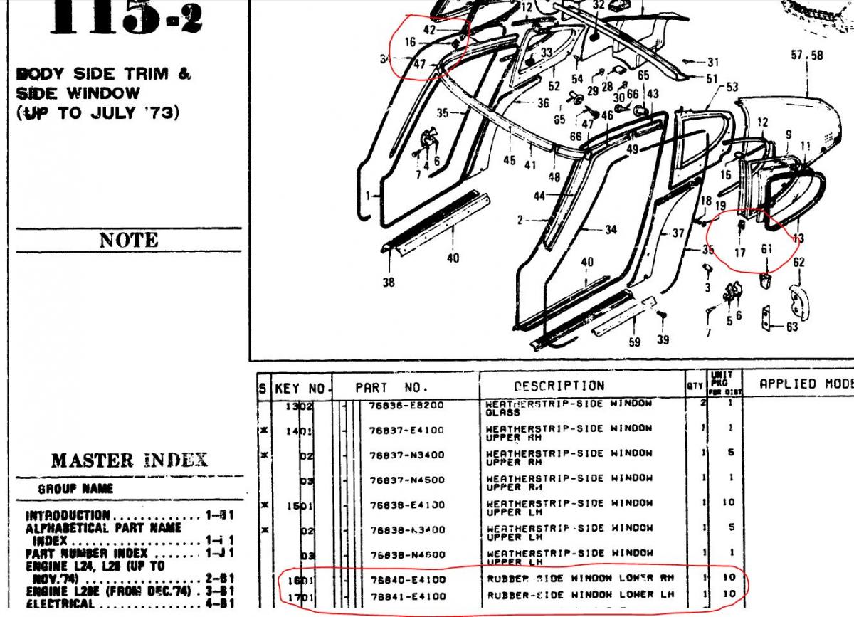

You got me looking at the seals in this area on my car and I noticed one other small seal, on the lower forward corner of the quarter windows. When the door is closed it will virtually mate with the small seal on the door just mentioned above.  I'm missing the one on the LH side, here's a couple of pictures and a parts book image:
post-7818-0-82196500-1447192139_thumb.jppost-7818-0-89834300-1447192169_thumb.jp
post-7818-0-46799600-1447192195_thumb.jp
MSA has these:
http://www.thezstore.com/page/TZS/PROD/classic03a09/34-1014
http://www.thezstore.com/page/TZS/PROD/classic03a09/34-1015
