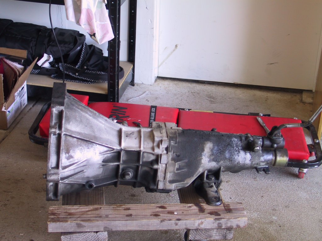

ZmeFly - i installed the '78 5 speed in my '72 - the shifter lever is rubbing hard at the front of the opening ( about 3" farther forward than the older trans. ) does your shifter fit in the console opening correctly? do i only need to make room for the shifter in the trans. tunnel? OR do i put the perfictly good 4 speed back in?

My car was originaly a automatic. The 4 speed is fine and it fit correctly. I bought a '78 parts car for the N47 head, electronic ignition and the fuel injection --- now all installed on my 240 block. The 5 speed was there so I took it out - last week when I honed and reringed my block I put the 5 speed in. The spot where the shift lever enters the trans. is differant than the '73. It is almost right under the front of the opening, then the lever goes back on about 45 deg. then straight up. The shifter will shift all 5 gears & reverse( rubs a little at the front-needs alittle clearance cut)) it's just not in the right place. I will get to mom & dads tomarrow to try the console over it to see if it works. If i do not have to modify the console to shift all the gears i'll leave it in to have that 5th gear. sound like the right thing to do?

As for the sticks the location of the shifter in the trans between all post '71 4-spds and 5-spds is the same, with the exception of the Borg Warner T-5 from the 280ZX Turbo. The actually shift lever may be shaped differently. You should be able to swap them from one to the other and end up with the same shifter location.
