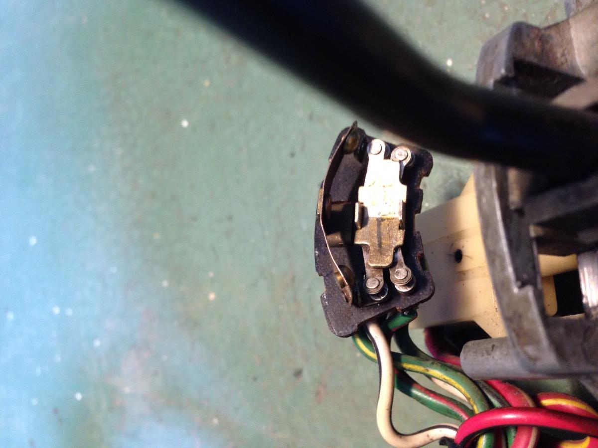

Mine had the same issues. I took the turn signal switch apart and cleaned it. Then it worked again. But be carefull. If you bend anything you will have other issues like brake lights....been there.post-22076-0-16896400-1438545195_thumb.j
