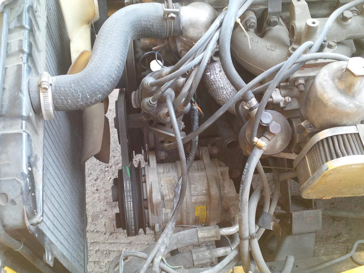

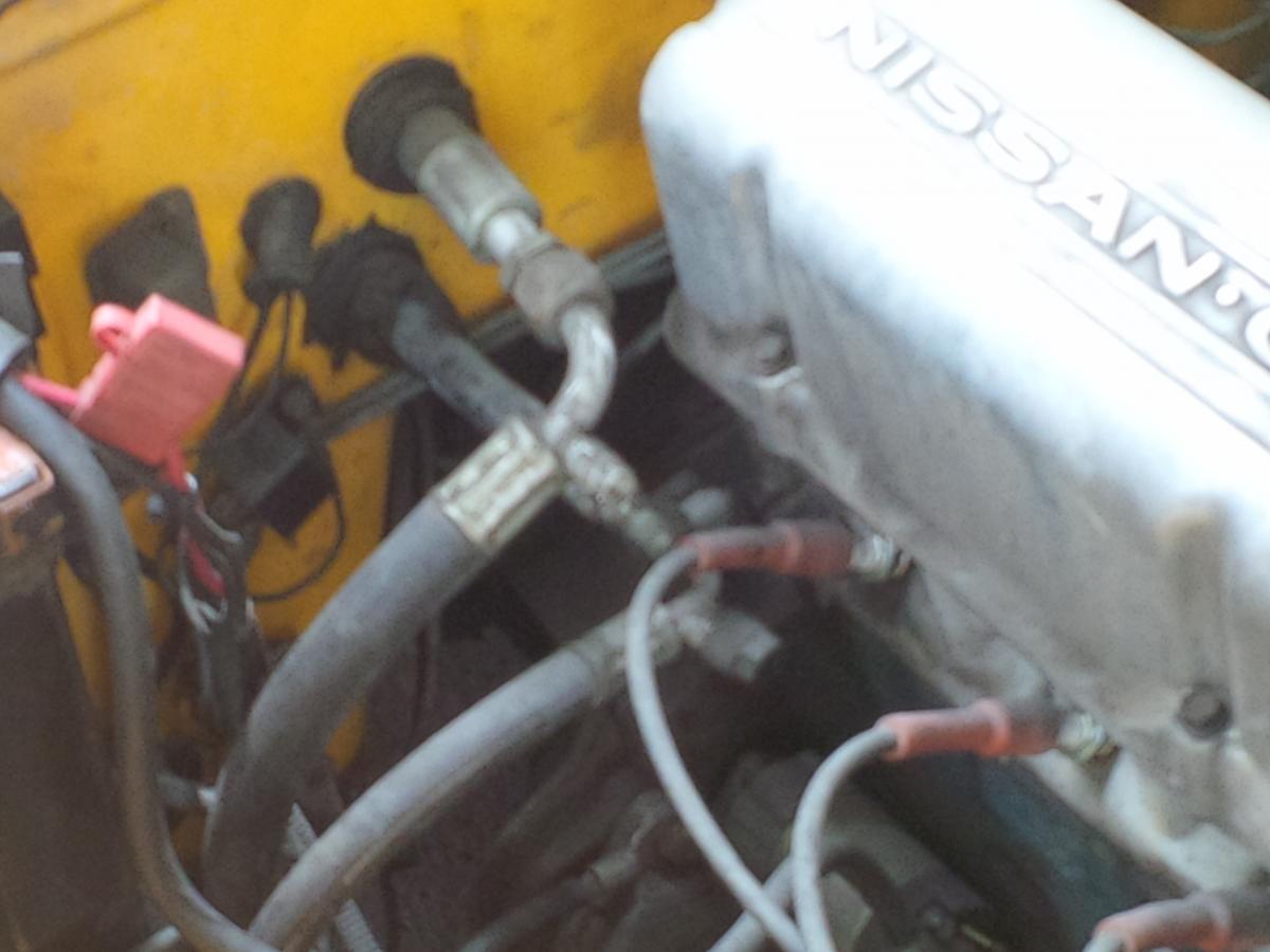

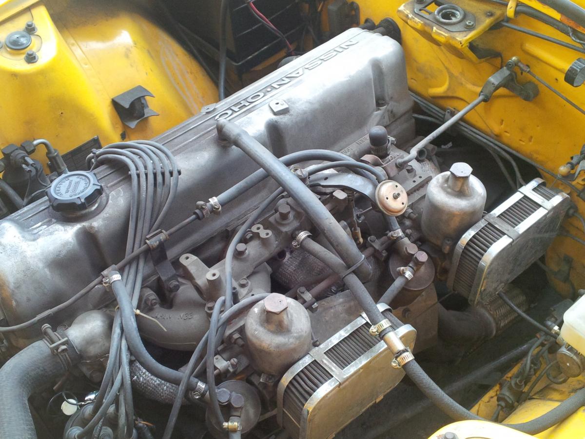

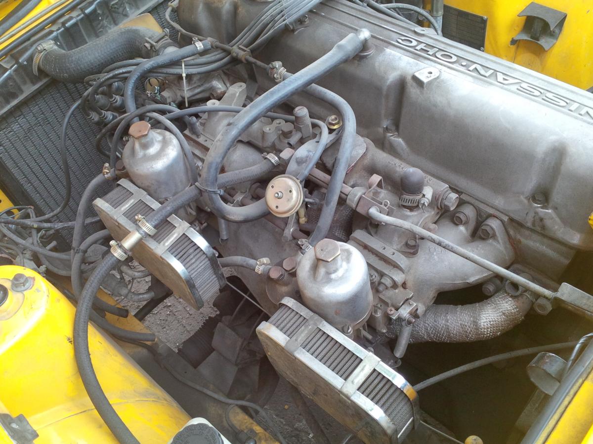

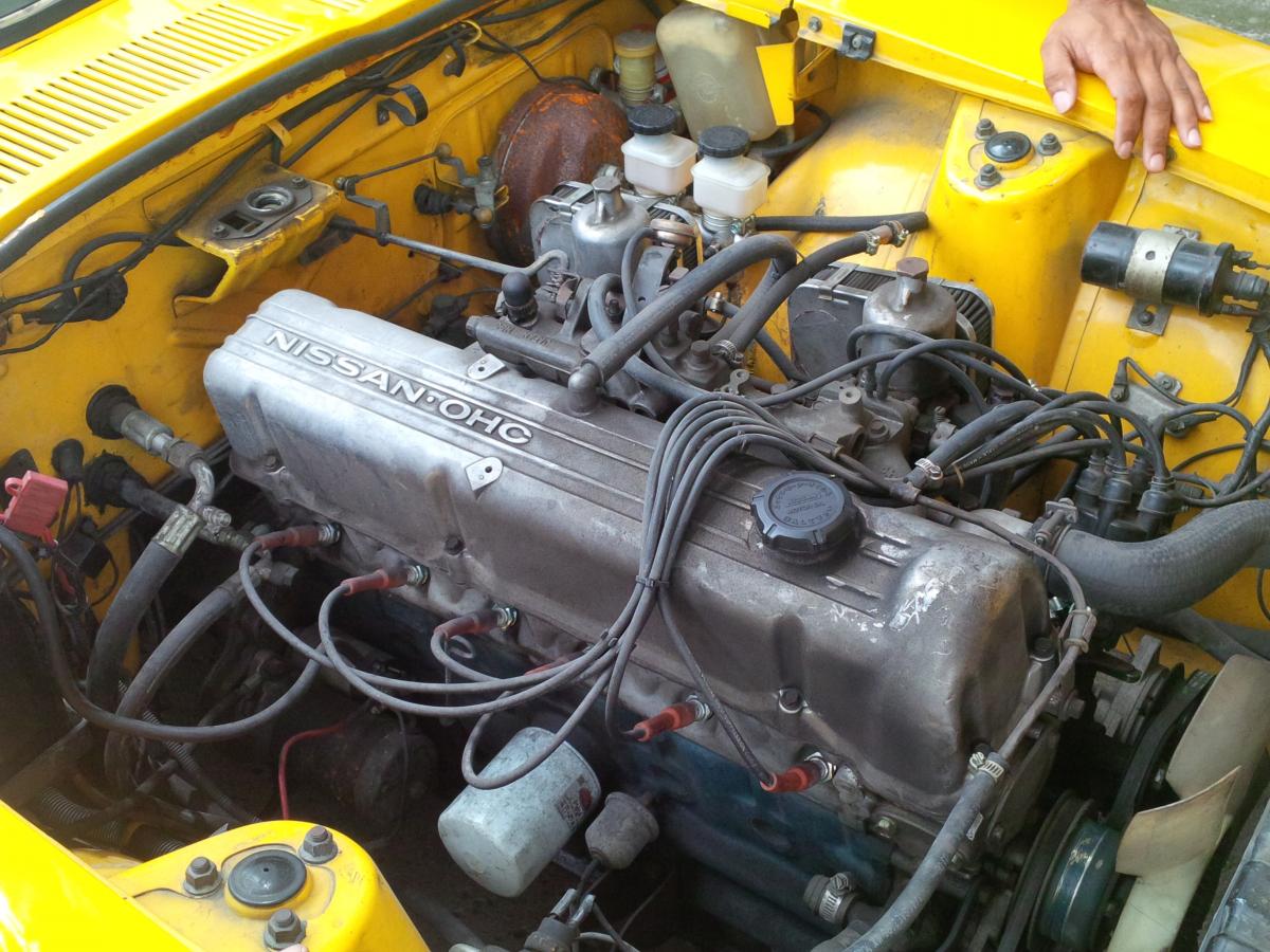

One of my friends has a 1973 240z with AC installed. I took some pictures and he has no servo diaphgram and throttle opener valve to compensate. I also want to be able to use the dash controls to turn the compressor on and adjust the blower speed. Could this be posible? Are the compressor hoses installed correctly?  meaning i will have to remove the heater hoses to get through the firewall and in the evaporator as shown:

On the 240z's I have worked on that had air, the refrigerant lines were brought through the firewall down low on the passenger side. You just have to drill extra holes. The ones with the dealer added air have a small pod screwed to the drivers side of the center console with a switch that started the compressor and a knob that controlled temperature. Most of them use the existing ductwork to provide the air so the existing heater blower moves the air through the evaporator to cool it. I would not delete the heater even where you live...

well i will need to follow your advice and not what my friend did as per the pictures attached? it seems he deleted the heater system and installed the compressor to evaporator hoses through the heater hoses. Do you conclude his installation is not correct? i am trying to find pictures of someone who was a full installation as you point out but havent had any luck.
Edited by jalexquijano
I would not do what he did. Have you contacted vintage air about recommended installs for a 240Z? Look at "240z air conditioning" and "240z AC" for what the "stock" evaporator box looked like
