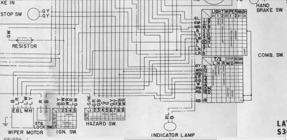

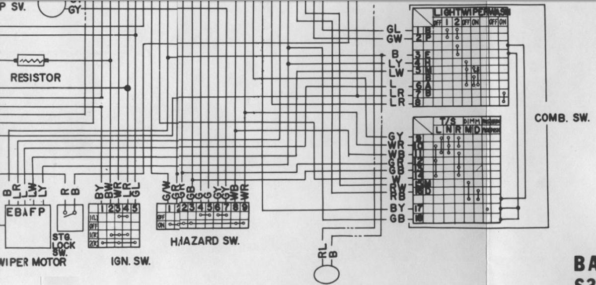

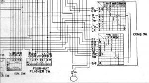

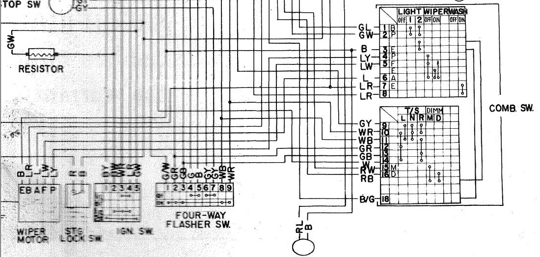

Ay chihuahua!  There's another wiring diagram!!  I forgot all about the tiny little version that's tucked into the back pages of the MY-70 owners manual (and humorously labeled, 'Minor Maintenance'...  ha!)

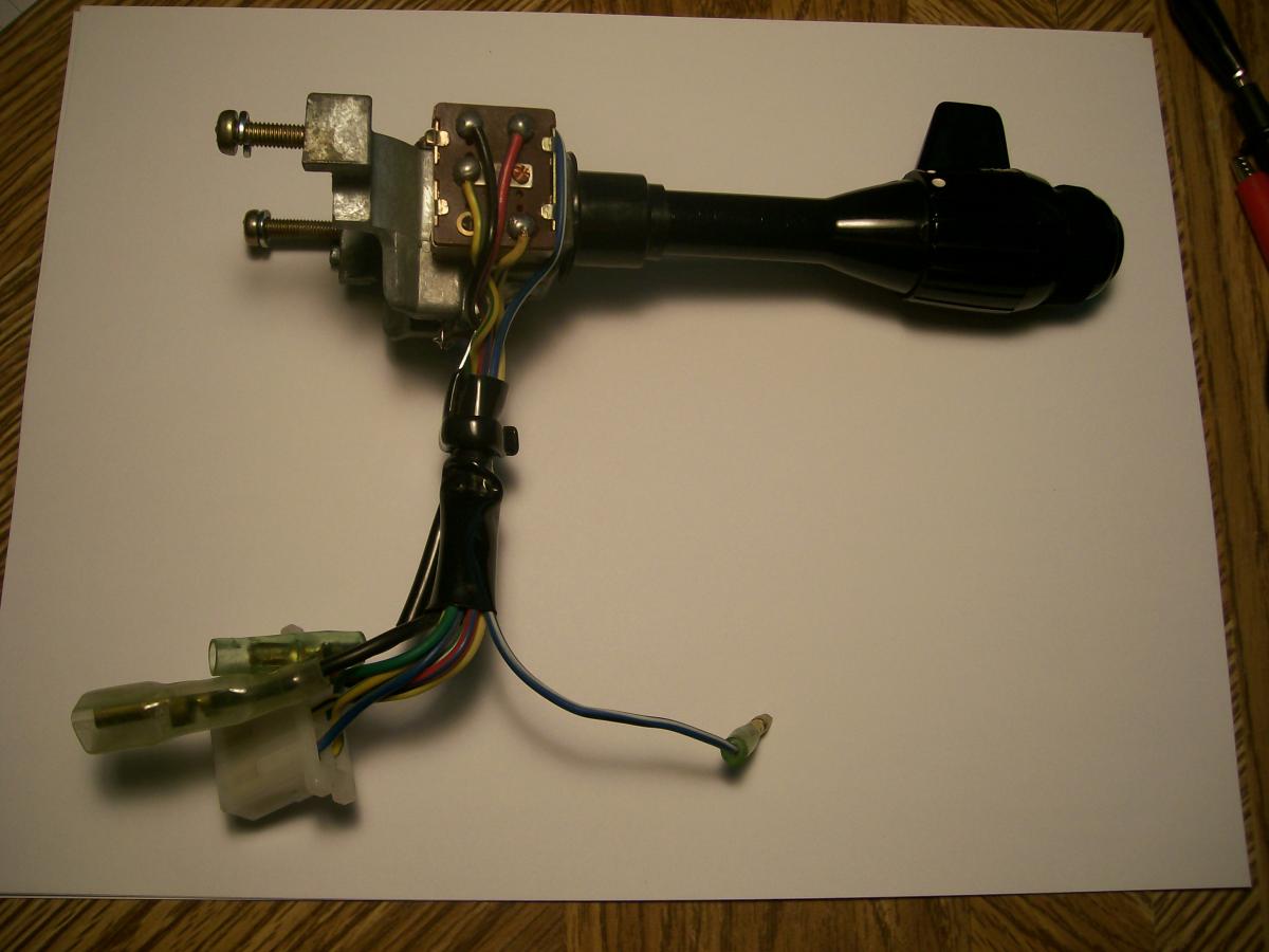

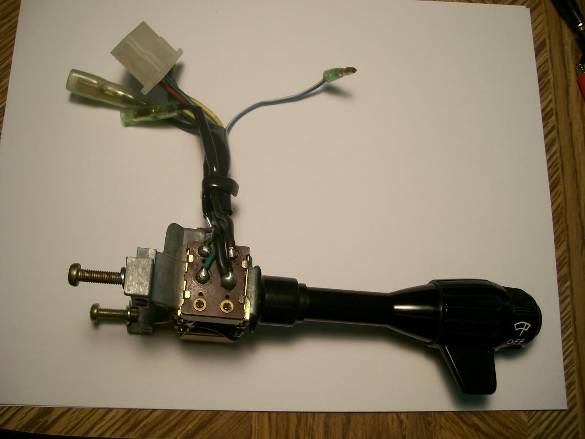

So now I've burned up another morning staring at yet another version of the wiring and connection logic for the early Z Combination Switch.  This wasn't helped by the fact that the wires on the 'Lights' side of my car's combo switch are different from those shown in all three of the wiring diagrams (see photos).  I finally decided to check the 6X connector from the dash harness that plugs into the matching connector on the Combo Switch.  Ahah!  The wire colors change as they pass across the connection.  For my switch:
Switch Wire    Harness Wire
      RL                  L
      YG                  LW
      YB                  LY
So now I had something to compare with the 3 wiring diagrams.  After a lot of playing around with my continuity checker, I determined that the Combo Switch in my May-70 Series 1 is best represented by the diagram that appears in the 1970 Owners Manual that came with my car (for reference, my manual is labeled as a 20-Mar-1970 printing).
The fun didn't stop there, though.  Even this wiring diagram isn't absolutely accurate in its depiction of the connection logic for the Combo Switch.  The logic for the Wiper function is shown incorrectly.  In fact, if you look at all three diagrams, you'll find that the details for the Wiper function are, um, 'erratic'.  In the FSM versions, only 'ON' and 'OFF' are depicted.  In the Owners Manual version, all three Wiper positions ('OFF' / 'LO' / 'HI') are shown, but connection details are shown only for the 'OFF' and 'LO' positions, and even these are depicted incorrectly.
I scanned the diagram from my 70 Owners Manual and then created a modified version that depicts the Wiper connection logic the way I traced it from my actual Combo Switch.  Combo Switch details from all four versions are shown below...
So, anyway, I've now verified that my particular Combo Switch uses a switched ground for the headlights that is controlled on both sides of the Combo Switch...
  • On the 'Lights' side - Ground continuity for the headlights is only established when the Light control knob is in the '2' position
  • On the 'Turn Signal' side - The Dimmer Switch provides 3 possible ground paths/settings... Open, Hi-Beam, and Lo-Beam).
And then, of course, there appears to be a 'Flash to Pass' function, which I think allows the hi-beams to be triggered by a partial pull on the T/S stalk (and doesn't care what position the Dimmer Switch is in).  Can somebody explain how that works?
But the 'Main Question', now, is this:
With the set-up in my car (per the wiring diagram from the 70 Owners Manual), what do I need to do -- if anything -- to make my two headlight fuses always hot?

71 FSM Supplement - Basic Model
post-20221-0-09131400-1435765969_thumb.j
71 FSM Supplement - Late Model
post-20221-0-76542600-1435766005_thumb.j
70 Owner's Manual (dated 20-Mar-1970)
post-20221-0-15483500-1435766033_thumb.j
70 Owner's Manual - Wiper switching logic corrected
post-20221-0-11975500-1435765093_thumb.j
post-20221-0-80093000-1435765123_thumb.j

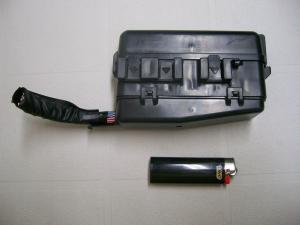

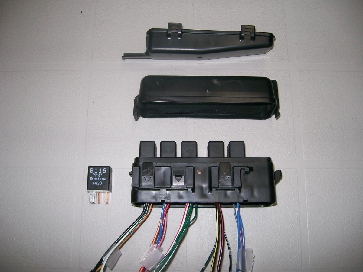

BTW, a recent search through the local pic-n-pull produced a very nice relay block, taken from the engine compartment of a 91 Mazda MPV.  The casing has removable upper and lower caps, with all of the wiring entering and exiting at a common conduit at the front.  The internal wiring and relay set-up was, of course, specific to the Mazda application.  However, the wire terminals can be extracted from their sockets and moved around to suit a new requirement.  I grabbed two of these relay blocks and have used them to produce a single block with 5 identical relays (4 for headlights, 1 for fog lights, one empty socket for possible future use for an electric engine cooling fan).
post-20221-0-73870000-1435837452_thumb.j
post-20221-0-94337900-1435837401_thumb.j
The new, intermediate harness will be connected up to the relay block using two pairs of spare Nissan 3x2 connectors.  The fog light relay will take its switching signal off the rhs pair of bullet-connector plug-in points up at the front of the car.  Power for the fog lights will come off the alternator.  Headlights and fog lights will now all be grounded to the chassis with dedicated local ground wires.
The relay block will be mounted in the engine compartment, using the mounting bosses from the now-discarded voltage regulator (I'm using a 280ZX internally-regulated alternator, along with the MSA/Dave adaptor plug).

About the MPV relay block:
It has no sockets for fuses. Just relays.  The relays were mostly of one spec and terminal configuration, but one was quite different.  That one used a white-plastic adaptor socket at its base to match its connector blades to the basic socket configuration that's molded into the base block.  I pitched all of the oddball relays and their plug adaptors and will be using all-identical relays (made possible because I took away two relay blocks from the pic-and-pull and used them to mix-and-match to create one to my liking).
I couldn't find any specs on-line for the relays that I'm going to use, so I took one of the spares and levered off the protective housing.  Underneath, I found what appears to be a standard-issue automotive relay.  It uses a resistor (rather than a diode) to help protect the ECU and the other on-board computers from possible voltage spikes.
In its original habitat, the MPV's relay block clips onto the side of a much bigger plastic box that I'll call the 'electrical centre'.  The bigger box has a few more relays, along with many, many fuses.  Both boxes are easy to get at -- they're up top, at the driver's-front corner of the engine bay.  If anyone else decides that they like this unit, just be sure to cut the wires as far out of the relay block as you can.  I was able to get about 6" of loose wire to play with, but not much more.  Try to get two relay blocks.
All of those loose wire ends from the relays will receive Nissan-issue brass connector terminals, which will then be inserted back into the white-plastic Nissan 3x2 connector blocks.
