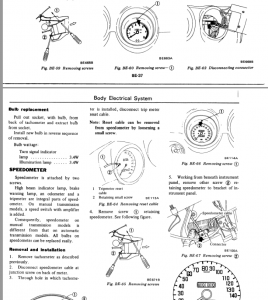

The 280Z's don't use the wingnut.  There's one screw in the top of the ring in front of the lens, and one in the mounting bracket, dead center behind and underneath.  Plus, at least on my 76, there is a bunch of clutter around the back of the gauges.  Not much room at all.

Wingnuts in my Z were about 19mm. Taking out the tachometer was a bitch, but taking out the speedo was even bitchier. The upper wingnuts were accesible, but stuck as F. Tools that i found most usable were this "pipe" type socket and strong fingers. I bust all my knuckles, almost destroyed my thumb trying to press the wingnuts open, my hands look like i was in a fist fight but it is OUT.
