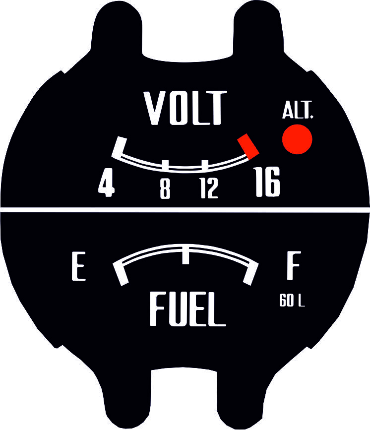

If you want to make your own plate, I made a Windows font with all the relevant letters and numbers.
The font will be called 240Z after you installed it (just unzip and double click...)
Or use my jpg or dxf
240Z.zip
post-23895-0-56063100-1427407051_thumb.j
AMPPLATE5b.dxf
