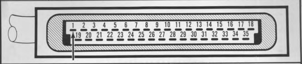

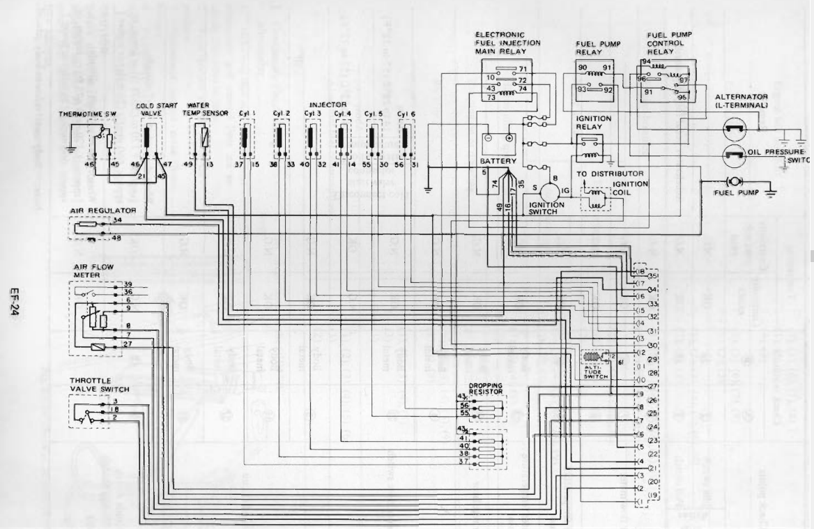

If you take a wire and ground pins 14, 15, 30, 31, 32, or 33,  with the key on, you should hear the injectors click.  At least you'll know that most of the circuit and power supply is complete.  Use your noid light and you can avoid accidental short circuits.  Plus you'll see the light flash as the injector clicks.
Working on the EFI system is boring for people looking for instant results.  But kind of satisfying for people who like to see long lists of measurements.  That's why Nissan published the "Bible".    Get a piece of paper and start collecting numbers.

I already did start collecting #'s so now what ?
With the key on if you complete the circuit to ground on those pins and the injectors don't click then they will never click via the ECU.  That's all that the ECU does, is ground those pins.  Don't hold it to ground too long you'll fill the engine with fuel.  Just a tap to ground will tell you if it's working.
Post the numbers on the site so we can see them, and we know which tests that you did.

That's the beauty of the wiring diagram of the system.  You can do little tricks like grounding the injectors to see if the circuit is complete.
There's another trick you can do by grounding the coil negative pin.  But, just like taking measurements, there's a certain sequence that needs to be followed.  Confirm one thing before moving on to the next.
