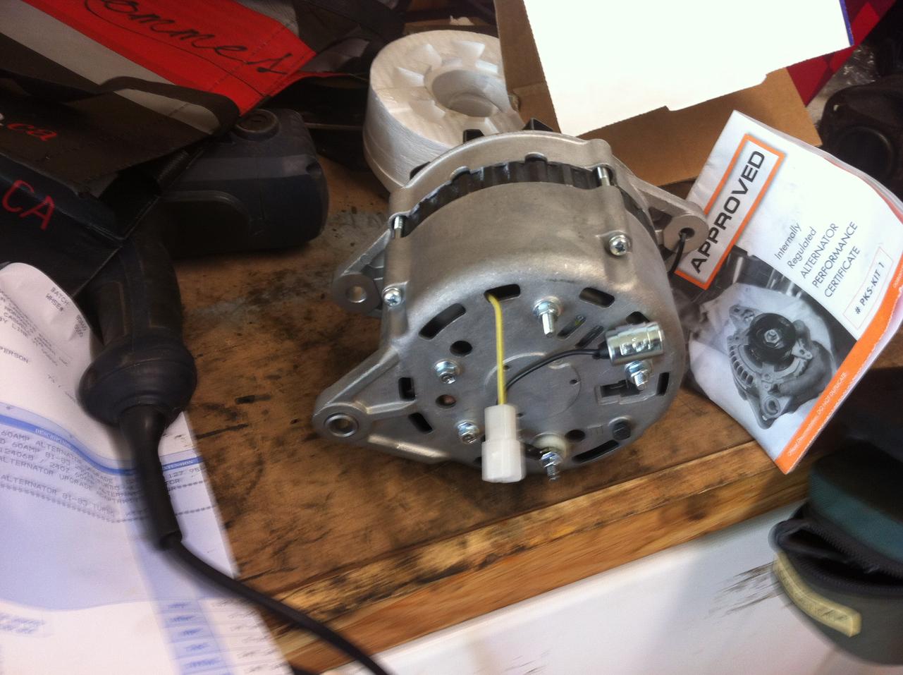

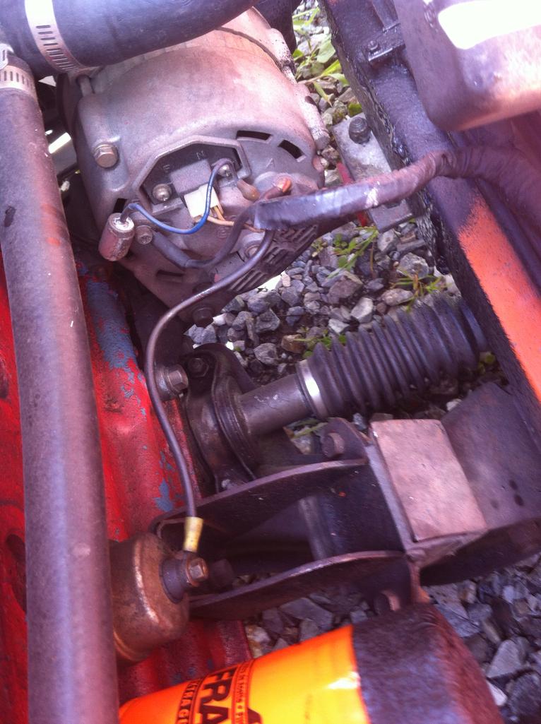

picture of my alternator in the car
and new MSA alternator
there is a yellow wire coming out of the MSA alternator with a sqare plastic connector
that i have no clue what it is and what to do with it.
all other things are the same on my car (1971 240z) alternator may have been modified by PO)
MSA sent a connector that i do not need.
Thank's in advance

Probably the "P" terminal. Not used. It's looking like many of the brands are getting their rebuilt alternators from the same source, and the source is standardizing to reduce stock keeping units (SKU's). Fewer SKU's makes it easier for managers to keep track of what their company is doing. Shades of Dilbert.

Thank's Z-head did let this thing hang and it work great.
Actualy in the instruction they were saying not to use P connector
put i could not figure this was it.
Actualy the connector replace the voltage regulator
witch is bolted on the fender very small part to replace
a big part aray!!!
I just quote this for futur readers to know.
