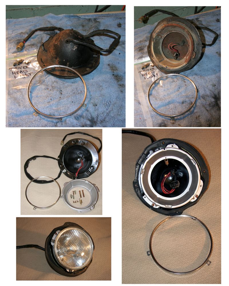

I had to replace a couple of mine when I reworked my head lights. I bought a box of 25 screws and the plastic receivers. I have a lot left, if you want some let me know (MP me and I can send them to you). If you look at the picture very close you can see the new ones.

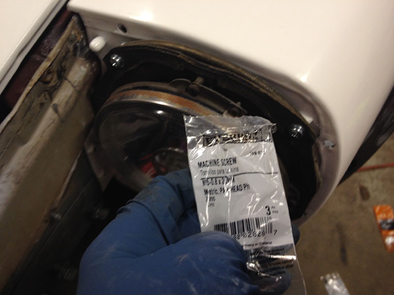

I find out it is M5 and I was looking at wrong parts.
Actually, I was looking for part #10 instead of #5.
- SCREW-PAN HEAD M5 01431-00053

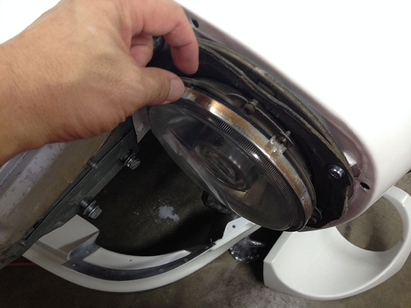

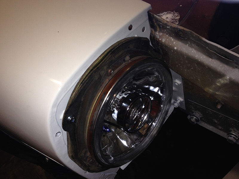

When I try to put it back together, I could not close the gap between fender and headlight bucket as you can see the photos. I was puzzled.... I search around the internet and figured out I put the headlight bucket from the front, not from the inside of the fender! no wonder the gap did not close.
Now the problem solved!
