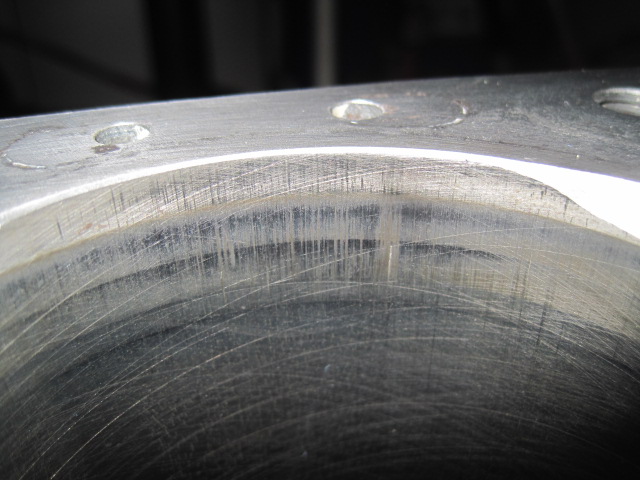

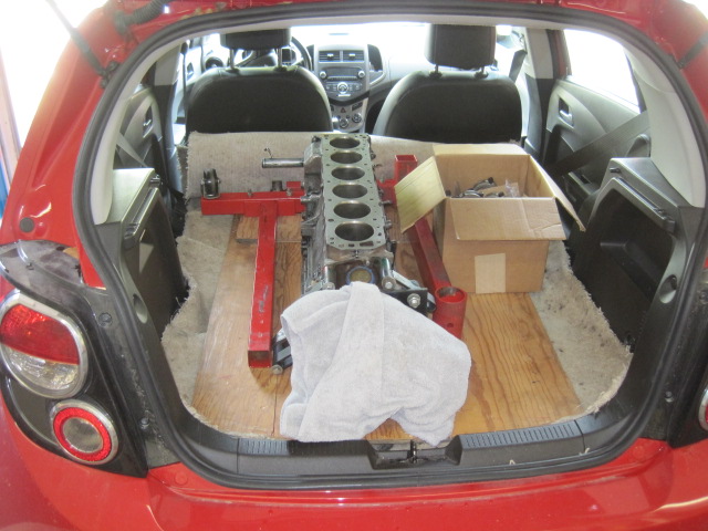

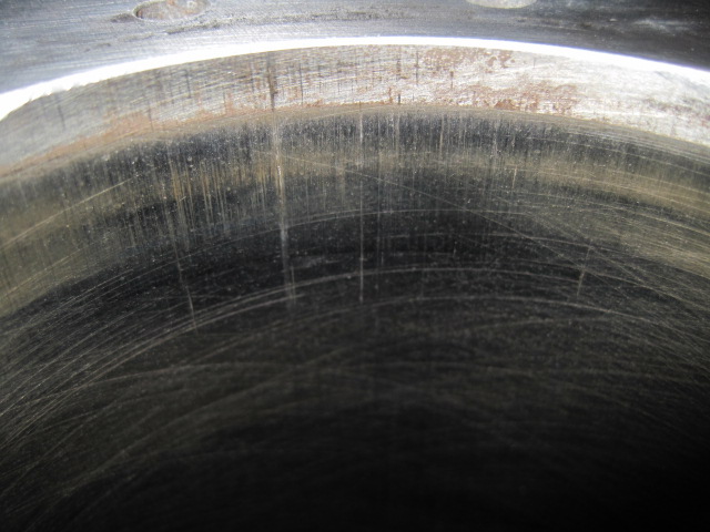

Well the block and pistons are at the machinist. A cursory inspection by him and he said I had nothing to worry about. He agreed to measure everything out and thought a good hone and new rings and I would be good to go. I pulled the crank out of my original motor and going to replace the crank in this motor in order to eliminate the speedi sleeve on the rear seal. I guess you would say I am starting over again from the beginning. This time I will do all the assembly work. It's time for me to learn how to do this and I feel pretty confident I can do it.
