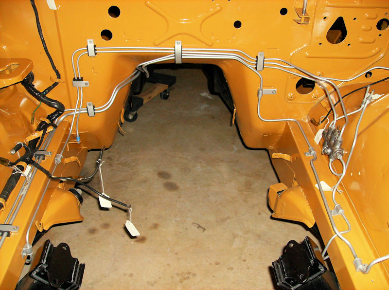

look at your rubber insulators that hold the fuel and brake lines, if the ones in the transmission tunnel and the one in the center of the firewall above the transmission have 4 holes then you have or had the piping for the flow guide valve. If only three holes then no flow guide valve.
steve
I can't believe very much fumes are going to make it out of the evap tank, down the long 1/4" tube, and out into the engine bay, especially since air is supposed to be going the other way when you're driving. Nice idea, but I doubt if it does very much except vent the tank, which is necessary.
If it turns out you have the tube (shown clearly in the post above) but no flow valve, you could just leave it as is. If the tube is disconnected at the evap tank, maybe put some emission hose on it and let it go down under the car, to keep any fumes out of the cabin.
