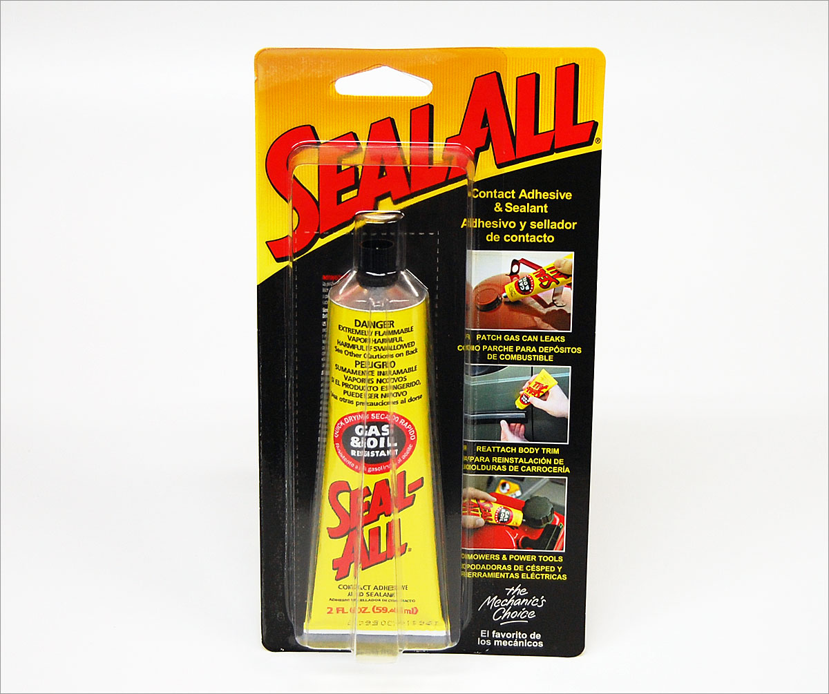

I think it is an interference fit. You could probably get by with a skim of high-temp gas resistant sealant/adhesive however if it ever came apart while driving, fuel will go everywhere.
