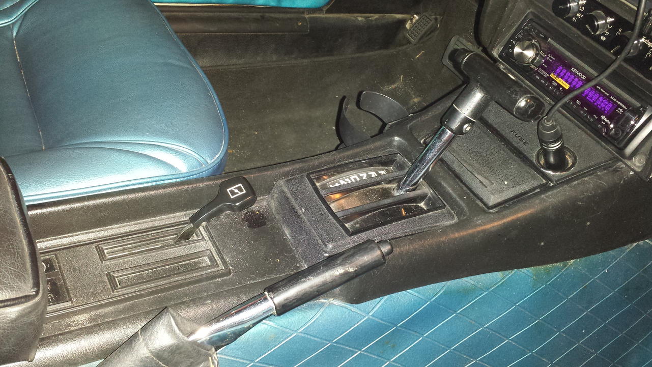

A quick snap of my console showing the automatic shift lever assembly.
