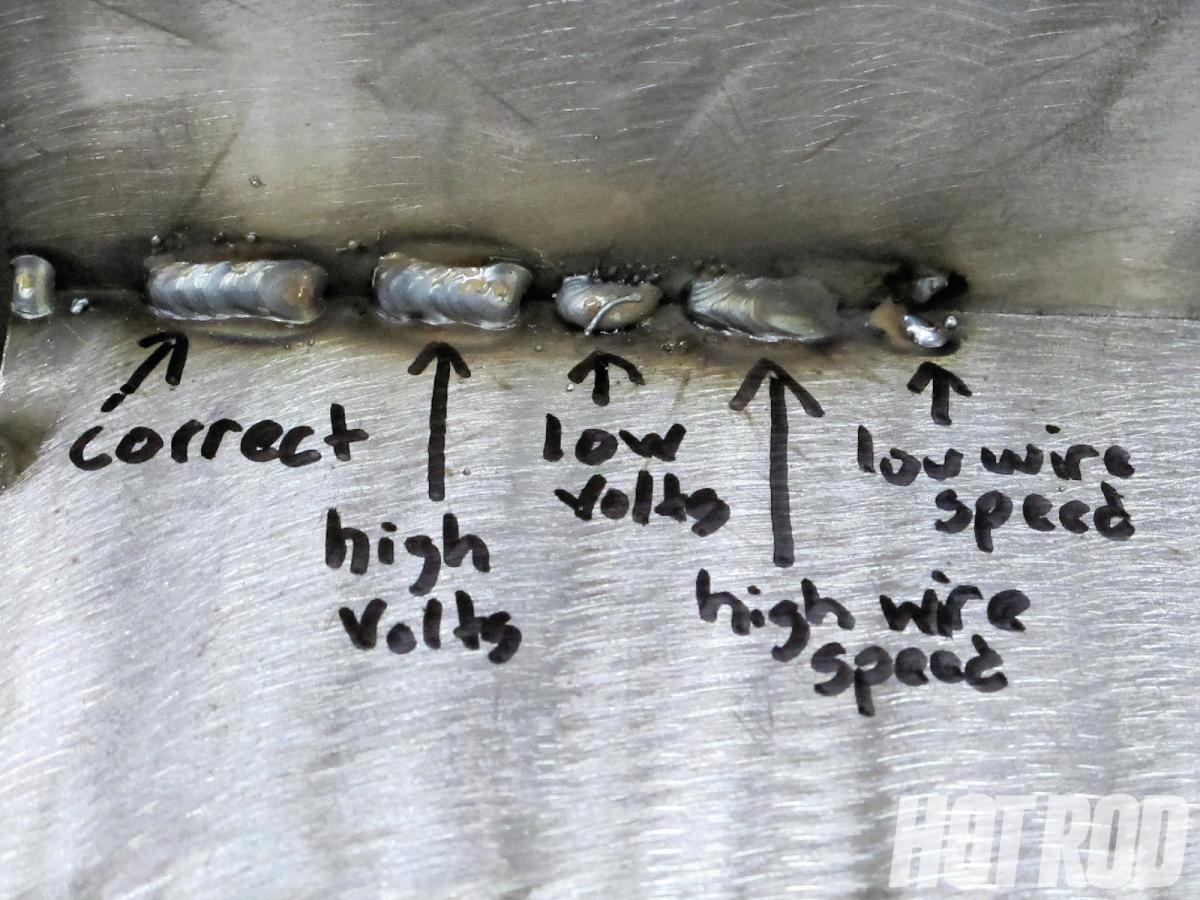

May 17, 201510 yr comment_470001 So you have some spare voltage. I have a 210 amp welder. I wasn't sure your welds were penetrating as much as they could. I would have probably turned it up a bit but I don't think you will have an issue. Most of the load on the strust is compression. I like to be sure my welds burn in a little more around the edges. If you look at the welds in "Careless's"?? thread his puddles lay down a little more. He is TIGing I believe but the same principle. When I see them sort of bead up like water on oil I add some heat. Link to comment https://www.classiczcars.com/forums/topic/49193-my-datsun-280z-rustoration/?&page=39#findComment-470001 Share on other sites More sharing options...
May 18, 201510 yr Author comment_470020 Thats an excellent pic of the different welds. Yeah on my first strut the voltage was too low. By the third one I had it down good. But like I said I would've felt confident in just doing a few tack welds because the coilover slides over the housing really nice and tight. Link to comment https://www.classiczcars.com/forums/topic/49193-my-datsun-280z-rustoration/?&page=39#findComment-470020 Share on other sites More sharing options...
May 19, 201510 yr comment_470085 Yeah, I didn't think it would be a problem either. I guess the largest forces on the welds are them trying to rotate from braking or acceleration. With the whole circumference welded it aught to be fine. Link to comment https://www.classiczcars.com/forums/topic/49193-my-datsun-280z-rustoration/?&page=39#findComment-470085 Share on other sites More sharing options...

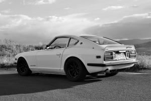

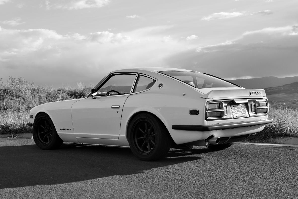

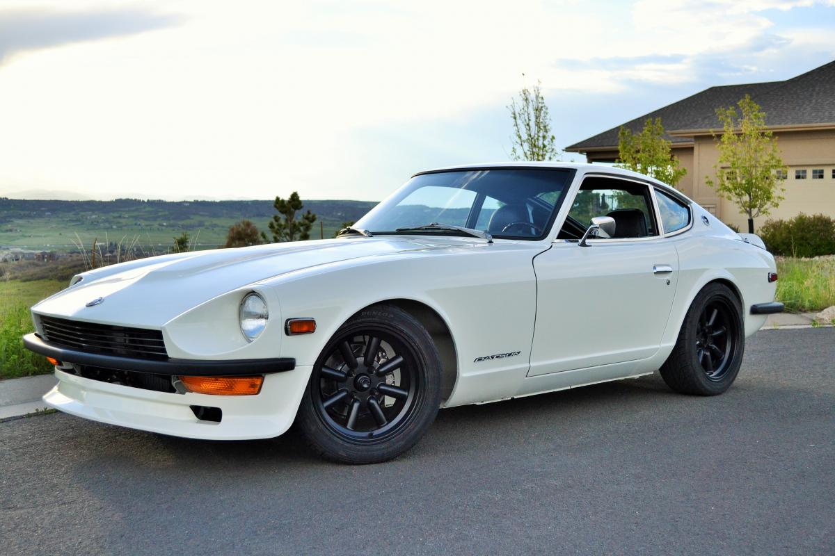

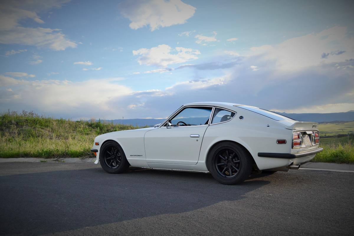

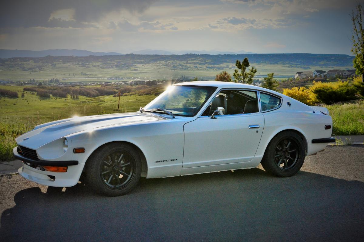

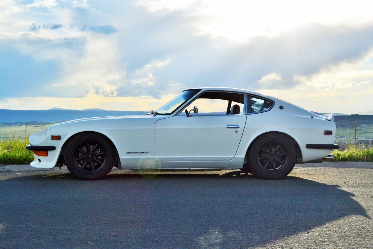

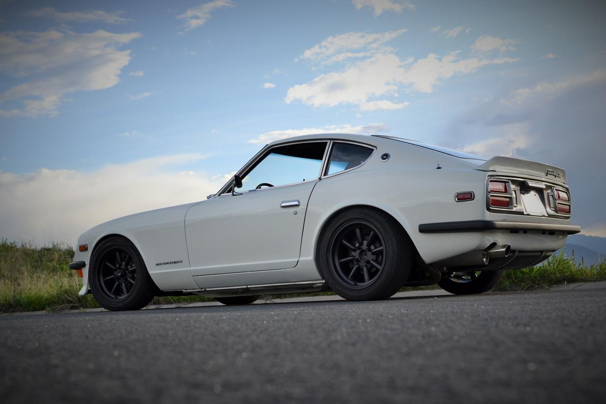

June 1, 201510 yr Author Popular Post comment_470975 Took her out for a spin today and got a few pics. Link to comment https://www.classiczcars.com/forums/topic/49193-my-datsun-280z-rustoration/?&page=39#findComment-470975 Share on other sites More sharing options...
June 1, 201510 yr comment_470983 Looks good man! How's she run? Link to comment https://www.classiczcars.com/forums/topic/49193-my-datsun-280z-rustoration/?&page=39#findComment-470983 Share on other sites More sharing options...
June 1, 201510 yr Author comment_470984 She's running really good. I still have a few little bugs to work out. Link to comment https://www.classiczcars.com/forums/topic/49193-my-datsun-280z-rustoration/?&page=39#findComment-470984 Share on other sites More sharing options...
June 1, 201510 yr comment_471005 Well done. Link to comment https://www.classiczcars.com/forums/topic/49193-my-datsun-280z-rustoration/?&page=39#findComment-471005 Share on other sites More sharing options...
June 1, 201510 yr comment_471035 Great to see the finished product! Link to comment https://www.classiczcars.com/forums/topic/49193-my-datsun-280z-rustoration/?&page=39#findComment-471035 Share on other sites More sharing options...

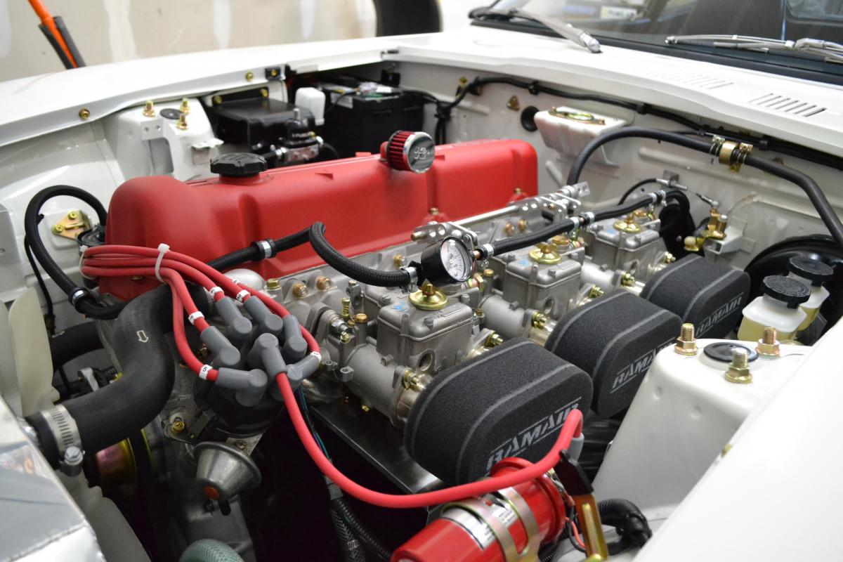

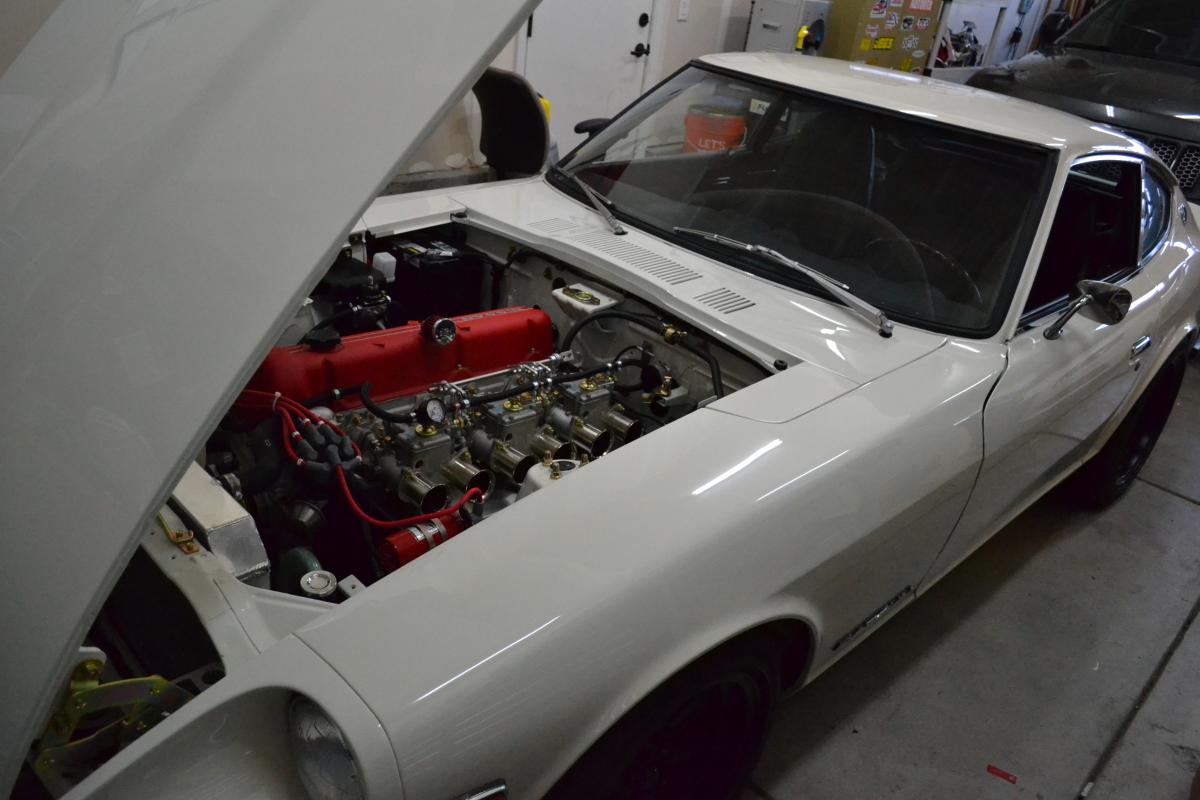

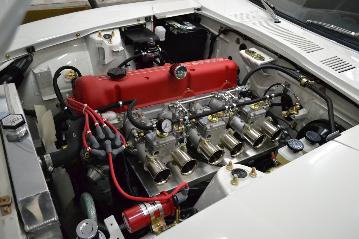

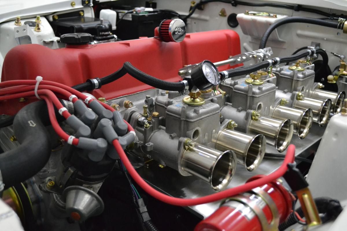

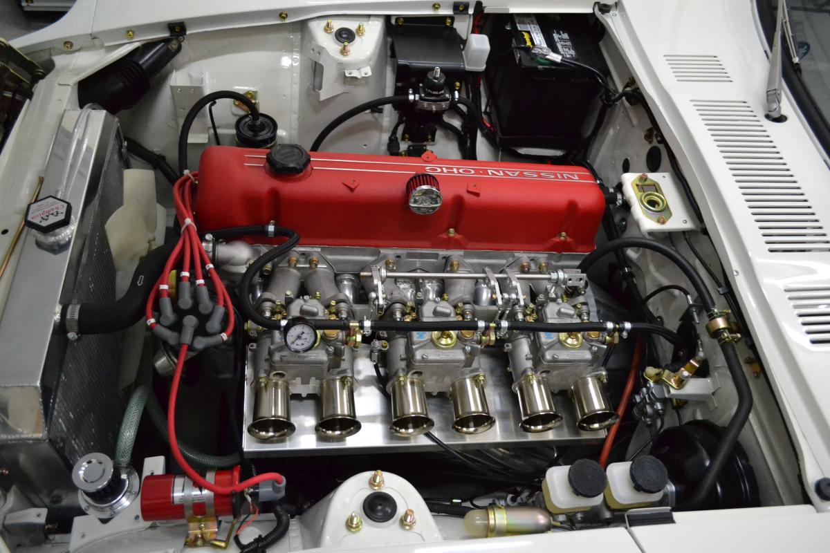

June 2, 201510 yr Author comment_471044 Some engine bay pics Link to comment https://www.classiczcars.com/forums/topic/49193-my-datsun-280z-rustoration/?&page=39#findComment-471044 Share on other sites More sharing options...
